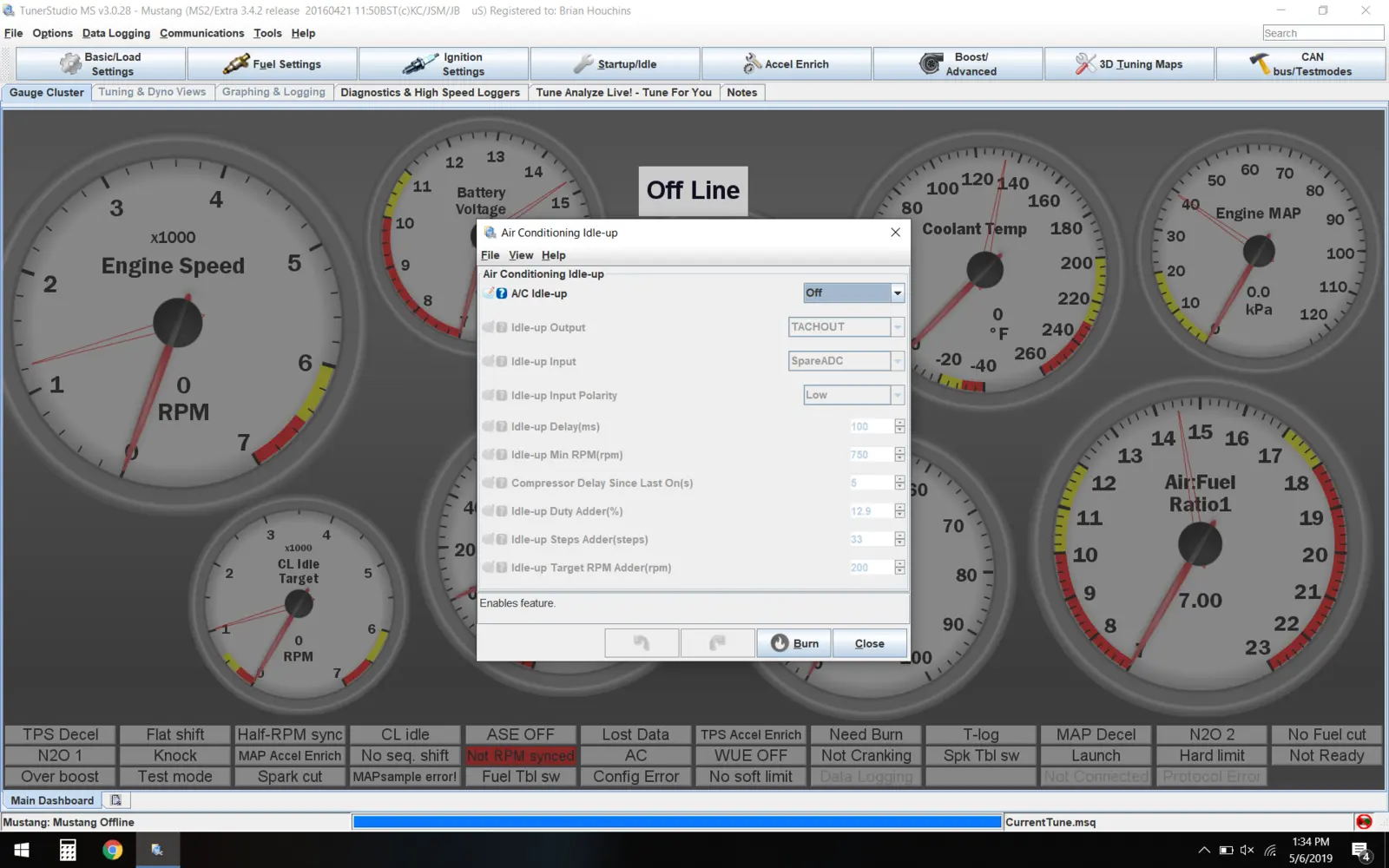

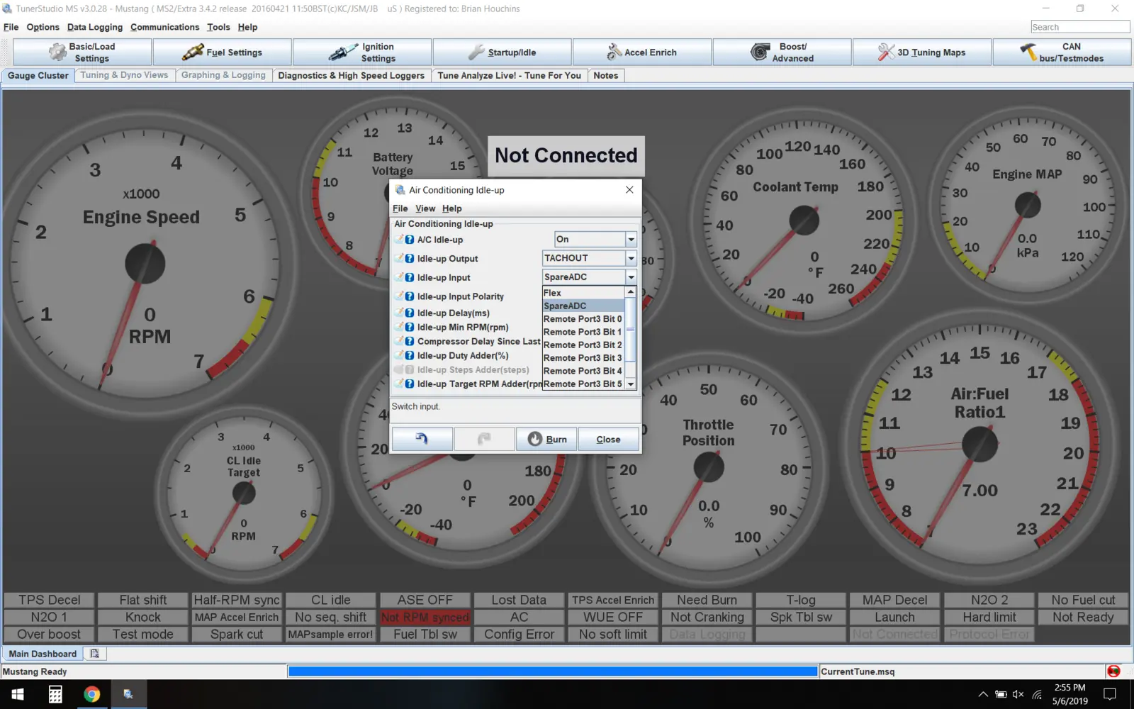

Under idle up the input should be tableswitch <polarity> try low first. If setup correctly the AC input light should come on at the bottom of Tuner Studio.
dont see "Tableswitch"
if there are no other available options. I would have to do a bit of research before i could confidently say yes. If it were a low input yeah but i think the input comes in as 12v.... thats not good for the ECU. a email to the websource you purchased it from would be my suggestion.
