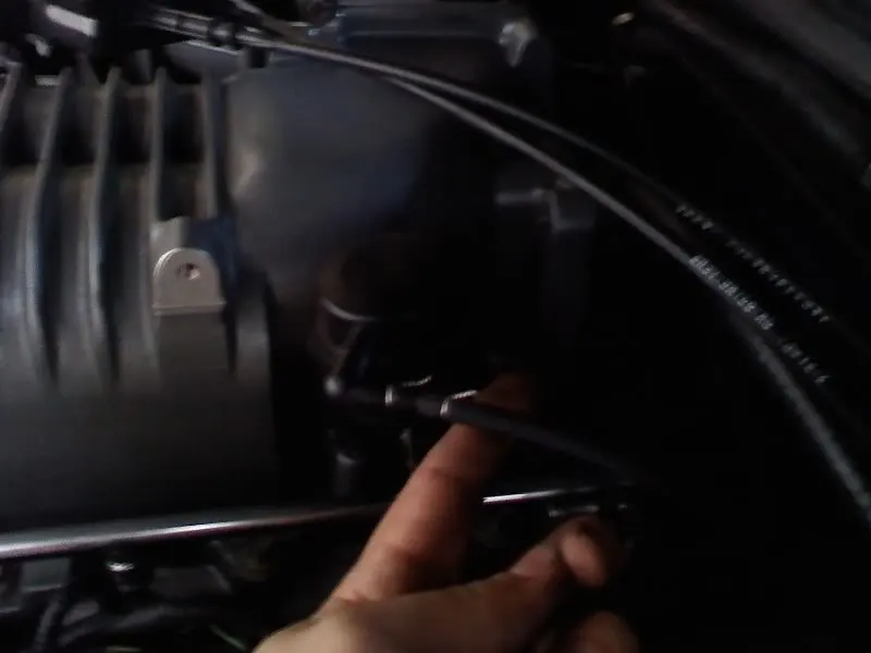

Another is, does anyone have any pictures of the factory pvc lines? The p/o cut the two lines and has them just tied off and leaking oil from under the motor. Where are these supposed to go? Also, after a hard run, it noticed quite a bit of smoke coming out of these. Is this normal?

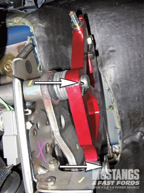

The clutch, quite honestly, sounds like a shadetree mechanic installed it. You can somewhat adjust the friction point with an aftermarket quadrant and firewall adjuster. Do you know if it has these already? Ck under the dash (you really have to squeeze in there to see - take a flashlight) and look for an anodized aluminum gimmick like this - this is a quadrant.
The OEM one is plastic.
Under the hood, ck on the firewall and locate where the clutch cable comes out. It's on the drivers side. There are only two possibilities and its not the throttle cable. The clutch cable will wind down underneath the engine (obviously!). Does the firewall gimmick look like this? (If it's plastic it's OEM)

The pcv valve line is about 4ft long and ziptied to the bottom of the motor, with a cut end letting oil and smoke come out of it. The "valve" on the driver side valve cover is the same way. Where does the one on the driver's side plug in on the intake? And the pcv valve should go in the air intake, correct? It has a Kenne Bell cai on it...

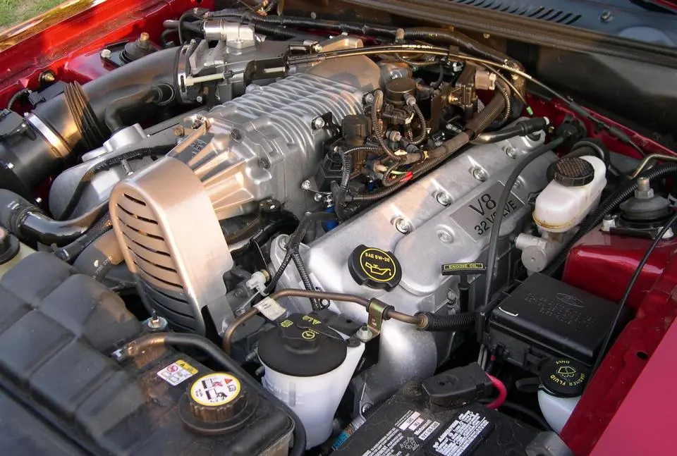

Do you have any pictures of the engine?
