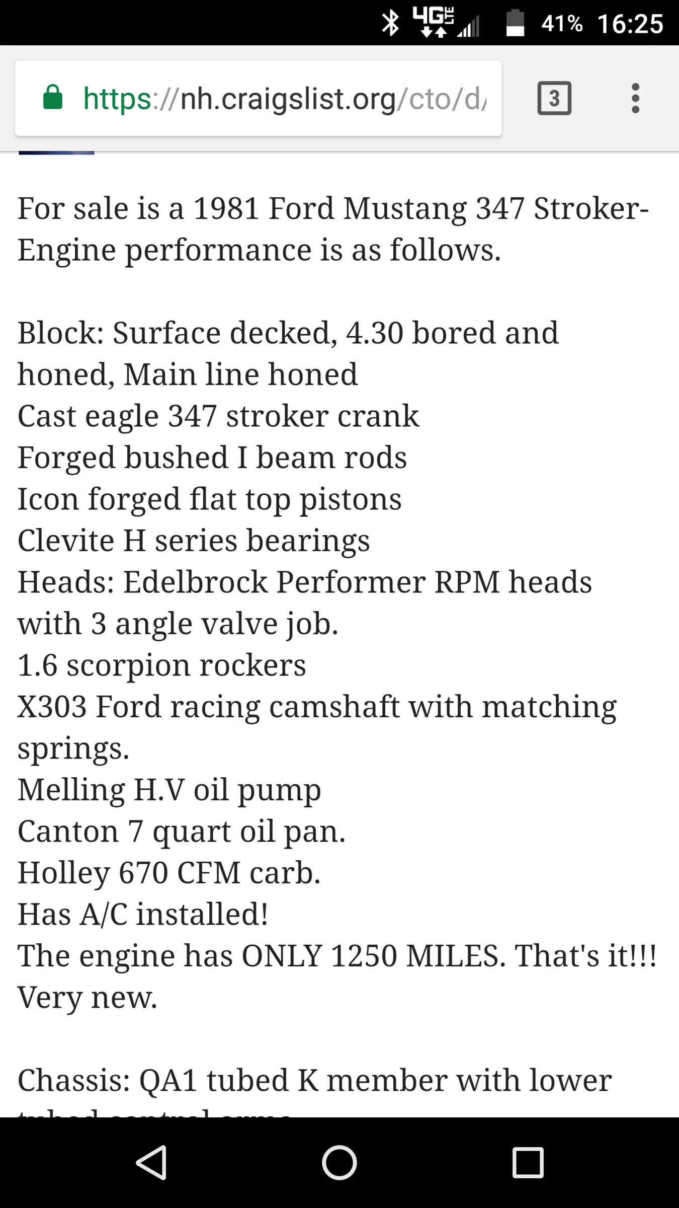

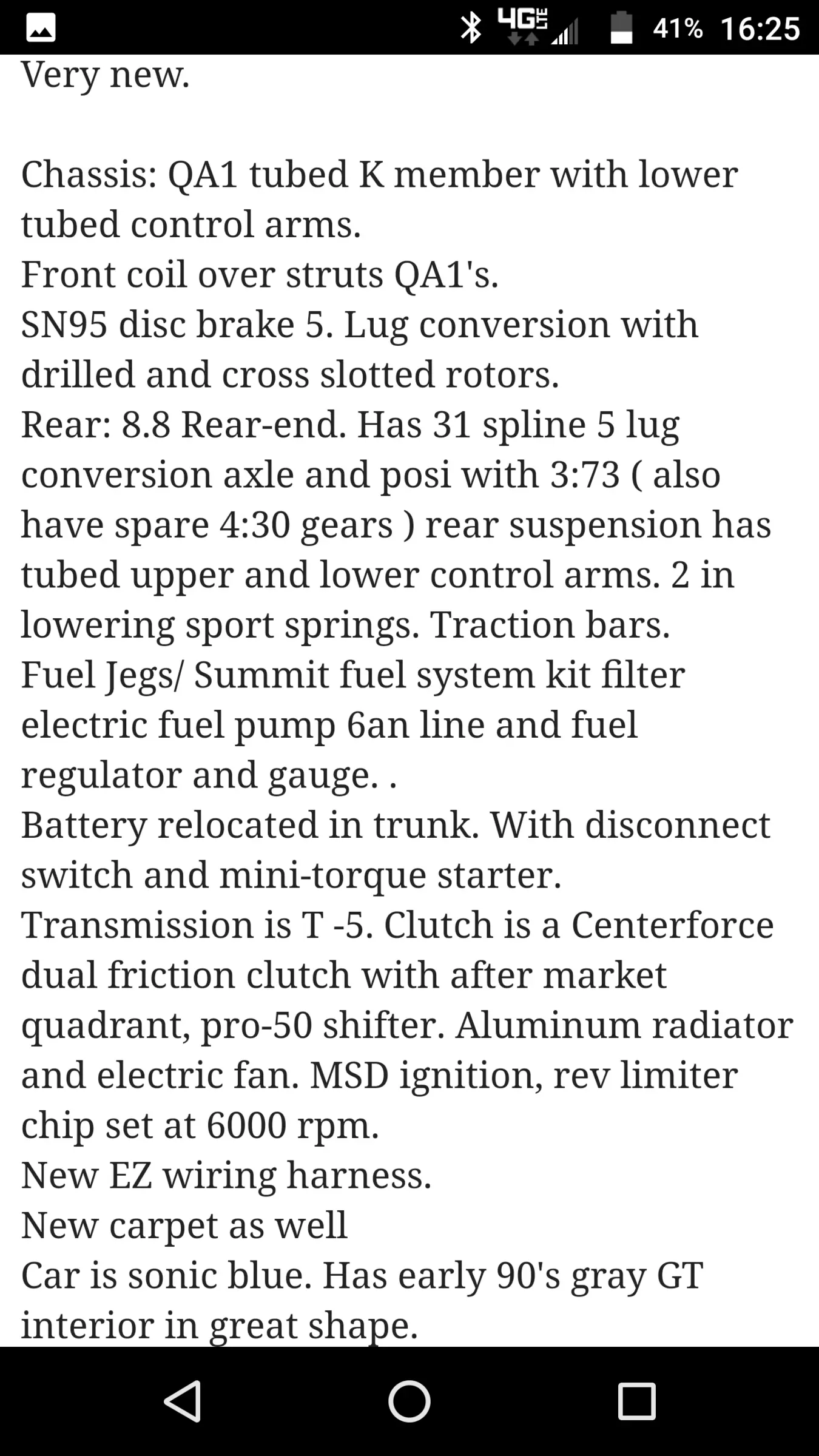

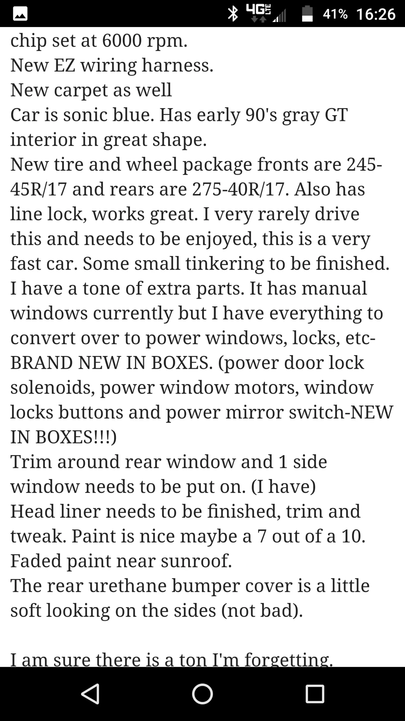

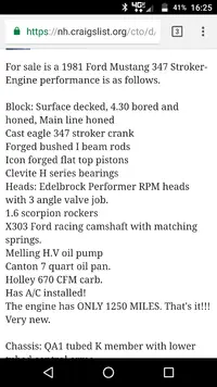

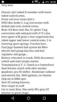

Hey gets new proud owner of a 81 notch back I have a build sheet of the car.. I was hoping someone with more knowledge of a engine build can check it out for me and kinda tell me what they think of it? Good parts bad parts if I should change anything? Thanks for looking everyone hope I don't catch too much hell for posting this. Bought the car with 1500 miles on all new parts.. Full tube chassis QA1 coil overs ladder bars the whole 9 yards.. And a brand new 347 stroker engine. The motor is what I'm most curious about to be honest

Looks like a nice car. The engine build list seems ok. I might have gone with different heads and cam but that's doesn't mean what you have is bad. There has been a lot of work done to your car and the list of upgrades is pretty healthy! Nice ride!

Yeah I'm not too good either lol.. All I know its fast and fun to drive.. And the line lock works good haha. Its weird though.. And I'm hoping some e can give me some onsite.. It's got great power off the line.. But as soon as I hit 4k rpm it snaps your right back in the seat and it's got a ton more power.. I'm not sure if its because of the carb...? It has a holley 680 I'm pretty stumped on it

The X cam you have wakes up powerwise around 2800 RPM and feels like it pulls like a freight train until the end of time ( almost like it was starving for fuel or sheds a whole bunch of weight at a magical rpm).
The custom cam means someone makes you a one off camshaft that optimizes your engine combo. Unlike the X, B, E , comp cams which is an off the shelf good that does the job but is not specific to your set up.
Off the shelf cam = Chef Boyardee Spaghetti
Good price, decent taste, resembles spaghetti, and readily available at any super markter.
Custom cam = is like going an ole Italian grandmother who wants to make you a special spaghetti , that you like with certain meats and cheeses, but the catch is you have to buy the ingredients and wait for her to make it.
A little more expensive, amazing taste, and takes a little longer to get.

The guys who make these cams can do it remotely...meaning you call them, discuss the specs, goals for the car. Then they make it and ship it to you.

Ed Curtis of FlowTech Induction is in Rhode Island. I have a similar 347 to yours except with AFR 185 heads and a custom cam by Ed. On pump gas with only 26* of timing it put down 378 HP and 438 FT-LBS at the wheels...I've got another 30-50 HP in it if I run race fuel and bump up the timing. Highly recommend the custom cam.
The amazing thing is how driveable it is - it starts and idles great, and my wife can drive it without a problem...she was scared to death of it at first though LOL
