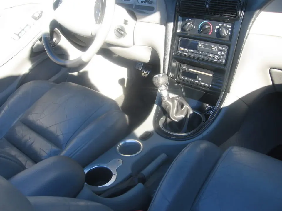

Does your look like this or is it missing the piece piece that goes around the shifter and snaps into the console?

Mine is the automatic. The large black piece is there. It is just as if the little rubber piece or brush piece that goes around the actual shifter rod to seal off is missing. Guess I will go by the dealership and see what they say or show in their parts manuals.
Finally got some pics. Here is the shifter and as you can see there appears to be something missing where the shifter rod goes down to the linkage.
