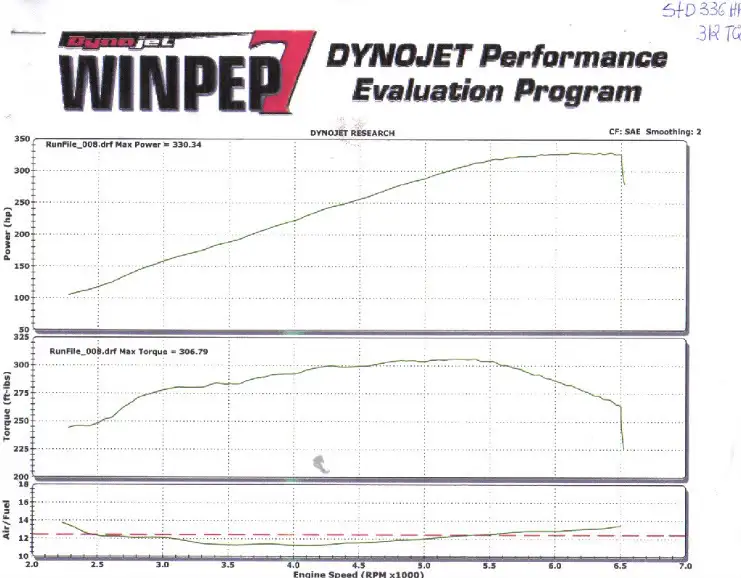

new NPI dyno #'s with MHS cams/6061 plenuim
im pretty happy with the results considering the shop temp was 93* with 100% humidity! this was the 8th pull out of 10, so it was pretty hot, it makes power to 6700, the starts to slightly nose over after that! and it gained a ton of low end tq with the MHS cams:nice: will be going to the track next week! hoping for 12.teens....
STD numbers were 336rwhp/312rwtq

What are the whole details on this combo?
JLT RAI
90mm maf
75mm t/b
6061 upper plenuim
2" open spacer
edelbrock victor jr. (welded and ported now)
ported and polished NPI heads
modmax SS valves
comp beehive springs
3 angle valve job
MHS stage 3.5 npi grind cams
MHS 0* cam gears
TFS crank sprockes
4v pisons
about 10.5:1 comperssion
modmax forged I beams
clevite main and rod bearings
cast crank
canton windage tray
frpp hv oil pump
flowtech longtubes
steeda udp's
o/r h pipe
mac mufflers
4:56 gears
no ac or power steering
and i know im forgeting some small things, i shift right a 7000rpms.
