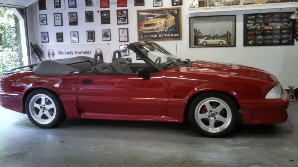

Like so?
Thanks again for the head's up. My first day on the forum and I post pics of the wheels going the wrong way! I am a little rusty gettin back into the FOX lifestyle/brotherhood.

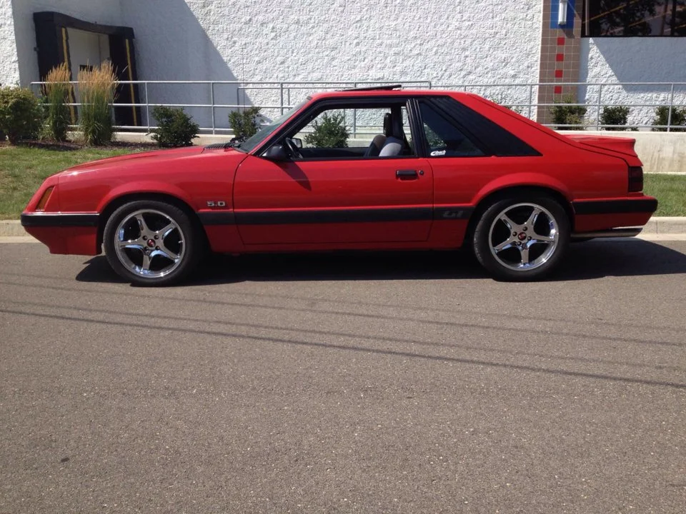

Don't be worried about that. Here's a pic of my '88 when it was sitting on Ford racing "B" springs with your same wheels. (I had them on backwards too) LOL
The tries were 245/45's up front with 275/40's on back. It drove great with the '93 Cobra replica's.
I have since swapped to Saleen Racecraft springs with SC replica wheels. The Racecraft springs actually sit just a tad lower up front but ride great with very minimal rubbing only at high speed cornering.

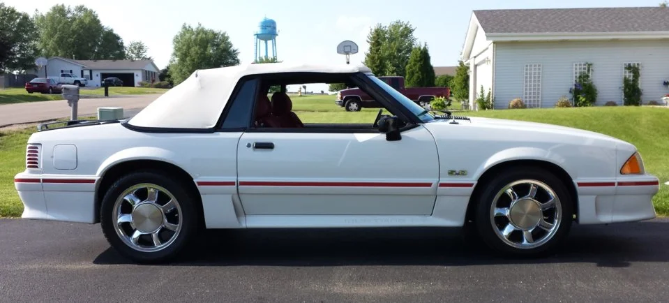

Bob don't worry about lowering the car. You'll have plenty of clearance Here's my 86 with eibach springs/struts/and shocks. Same size tires as above. Also the struts and shocks are for sale if interested pm me.
Reactions: Bob F
