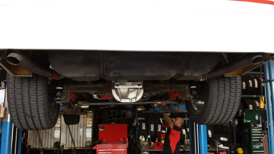

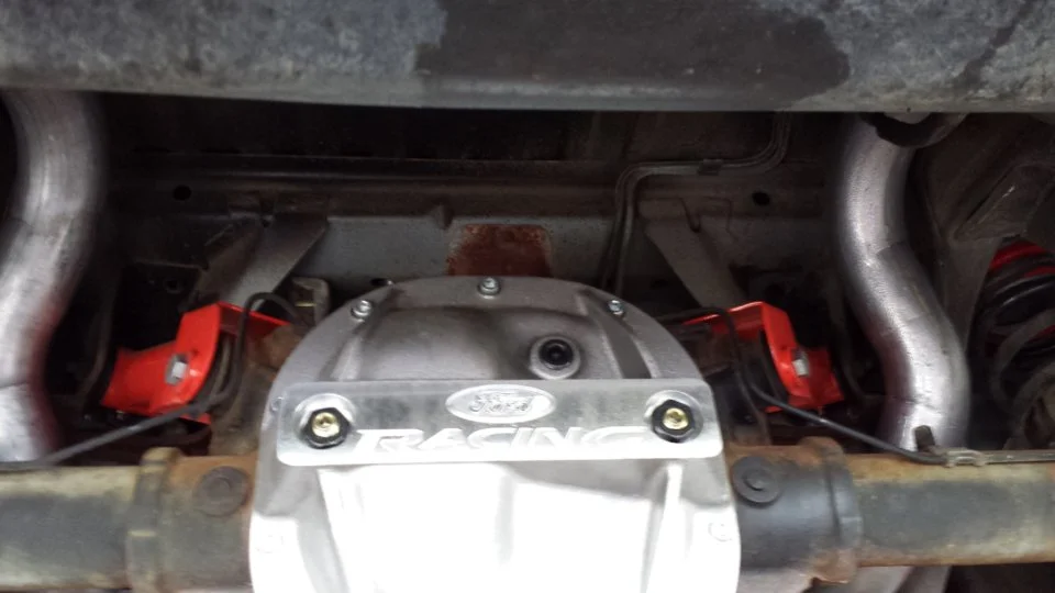

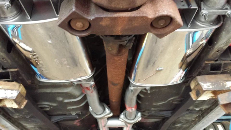

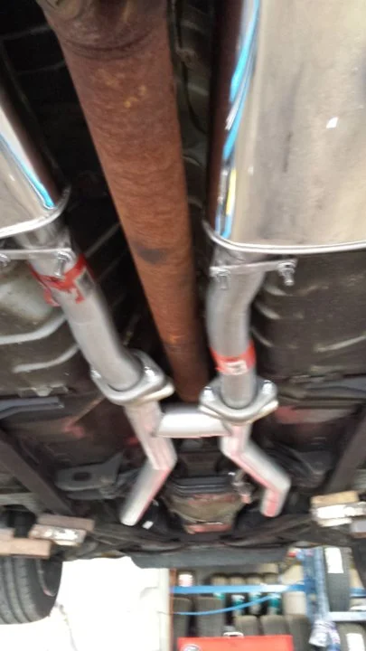

Reactions: A5literMan
Looks great Bob! I know you're gonna love the sound of the Dynomax Ultra Flo's. I have the same catback on my vert but with an offroad X pipe. I love it!
