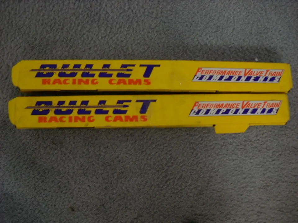

MHS stage 3.5 npi cams:D

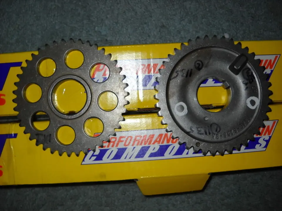

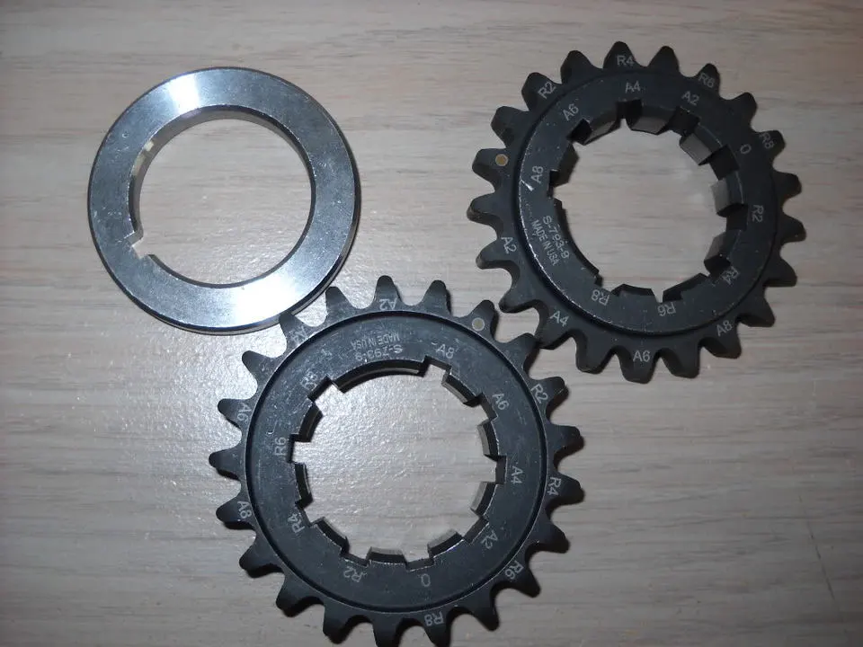

trick flow adjustable crank gears
and MHS matched cams gears
just got it running last night, they sound great at idle, and pull really hard after 3500ish, i havent revved it past 6000 rpms yet because of the tune, but when its tune it should be revving to about 7000, the cam specs are: duration at .050 238/240, lift 550/525, LSA 109

nice!! whatcha doin with the other cams? lol hint hint...
haha... sorry, but me and ryan(1fun281) are going to trade some parts, hes getting the cams, and im getting 99 GT rims and tires for my DD tacoma...lol they look cool on it.
