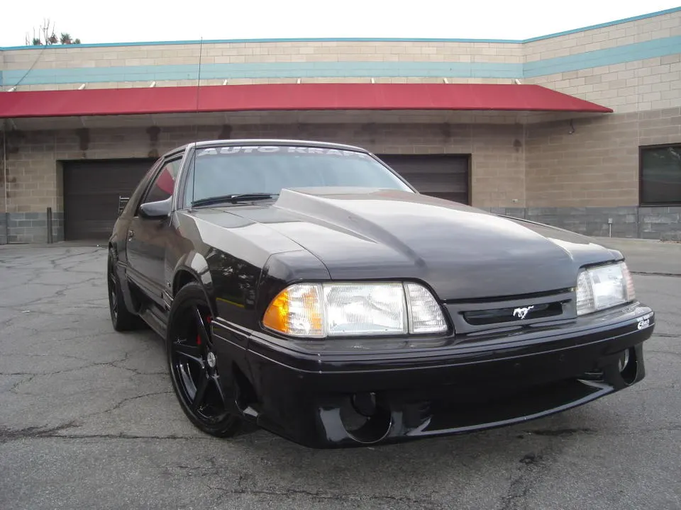

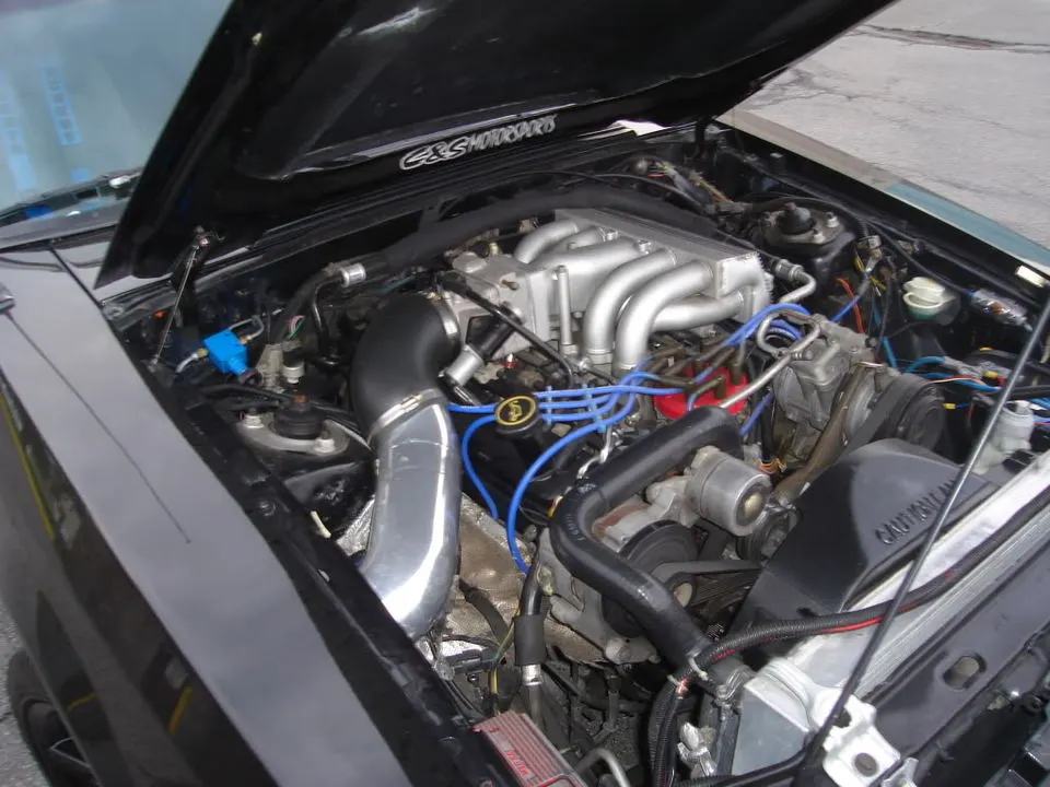

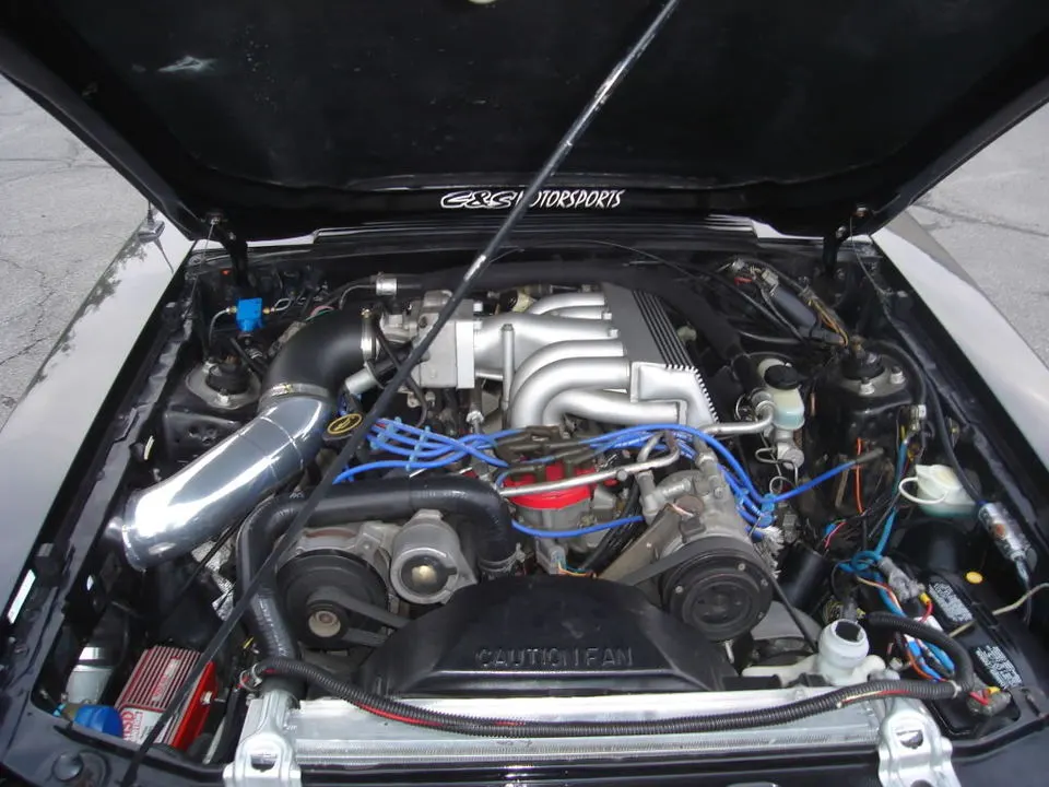

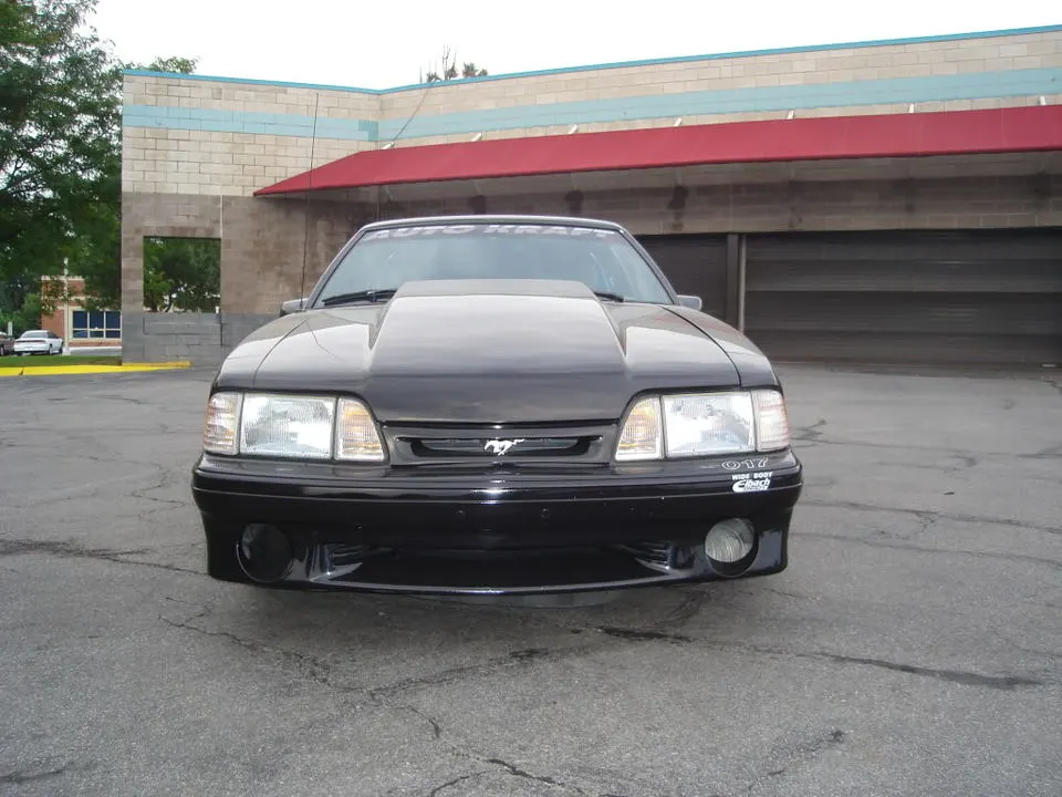

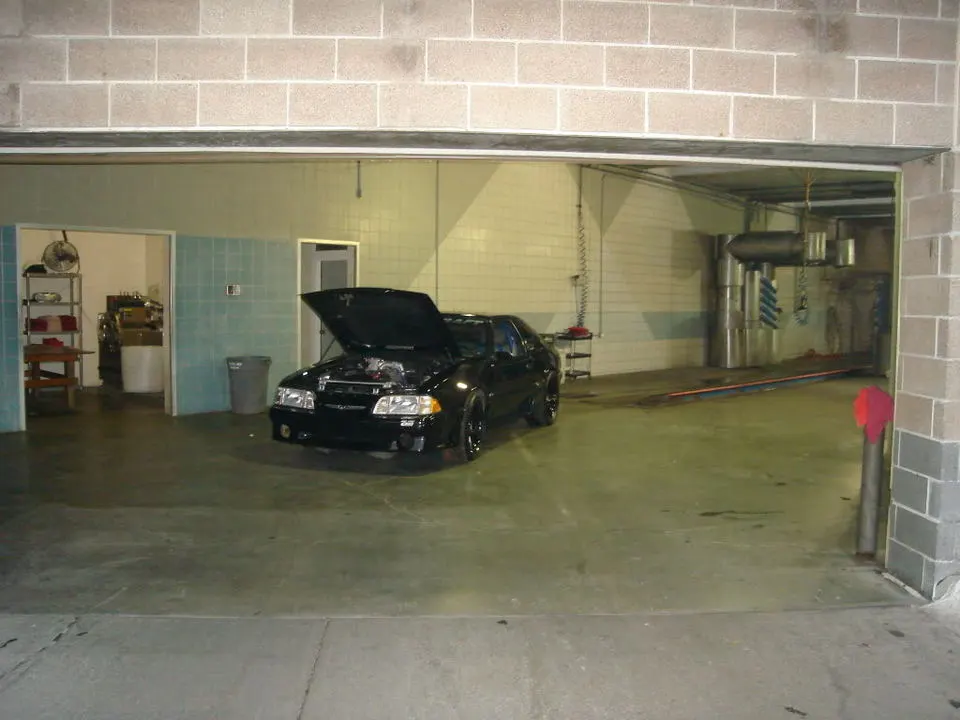

Finally got the car out of the garage. Its been a while so I washed it and shot a couple pics. I'm putting the factory GT wing back on soon. And the interior needs a little cleaning. The motor is a 357 windsor with 10.5 to 1 comp. 1969 block, and was assembled back in 1996 (hence the old GT40 intake) car has 64,000 original miles, Tremec 3550, aluminum driveshaft, 3:73 gears, 31 spline axles. B-cam, Victor Jr. heads, 75tb, 77 Pro AM MAF,
Im either porting heads, new cam, higher flowing intake, or starting all over with a 408 stroker. Have not decided yet.
For the most part I really love that car. With the stock wing you are putting on it will be even better!

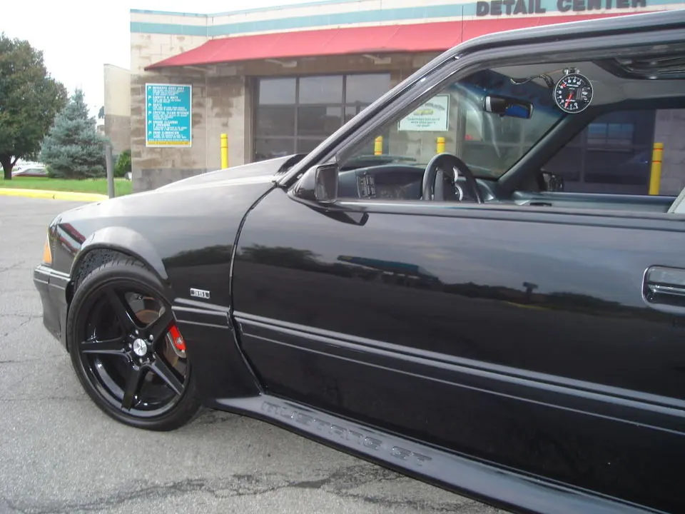

Never seen a tach there before. Nice job on something different. :nice:

The brakes are 13"/10" 95 cobra brakes, and the fenders were widened 1.5"front and rear. Doug from AutoKraft in Lincoln, NE (metal genious!) does all the Tiger Racing Mustangs, he stretched the fenders using the original fenders (hammer and bean bag) and was able to stretch the rear fenders while maintaining the factory quarter glass (crazy) Check out their website, (Autokraft.com) and check out Doug's widened and chopped baby blue mustang Used to run 275/40/17's all around, but having 275's up front grew very tiresome. Now running 265/35/18 BFG KDW"S, and 295/35/18 BFG DR rear. FRPP C springs (which I hate) megabite jr, lower control arms.
Dude... similar to mind but odd tach location... and lose the wing. Give it it's rightful place on the back of a 4dr honda accord... or the scap value of aluminum is still pretty good.
yea, the wing HAS to go! I was thinking maybe I could sell it to the SN95 guys on here. I had brake ducting going on, but they became tore up so I removed the remaining tubing after the pic was taken.
