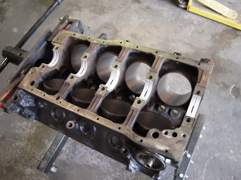

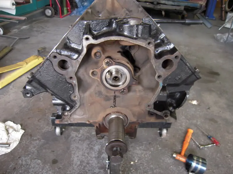

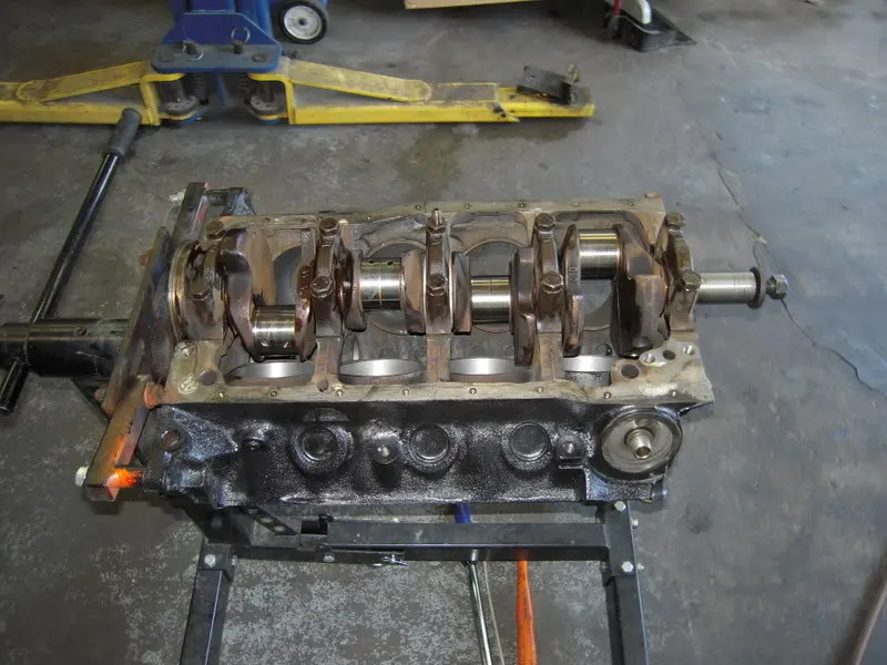

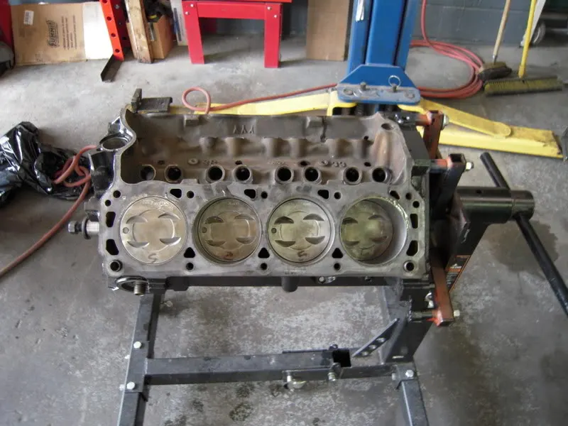

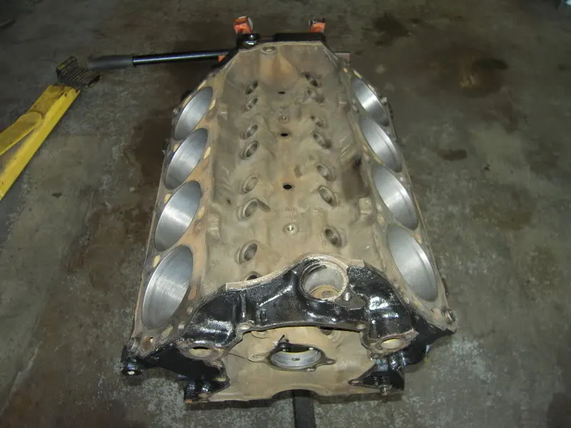

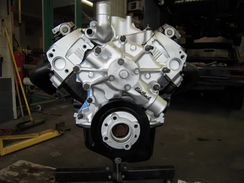

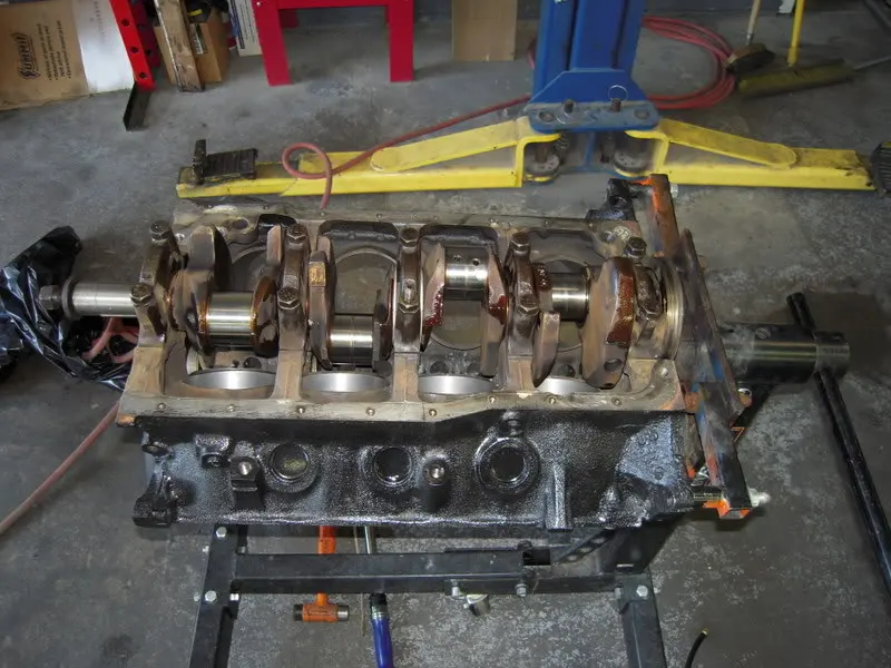

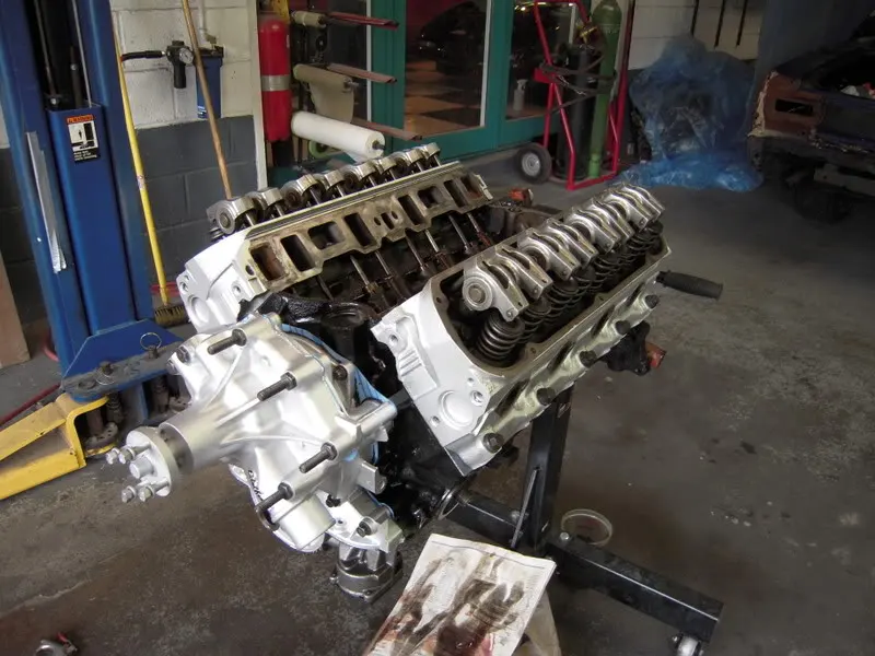

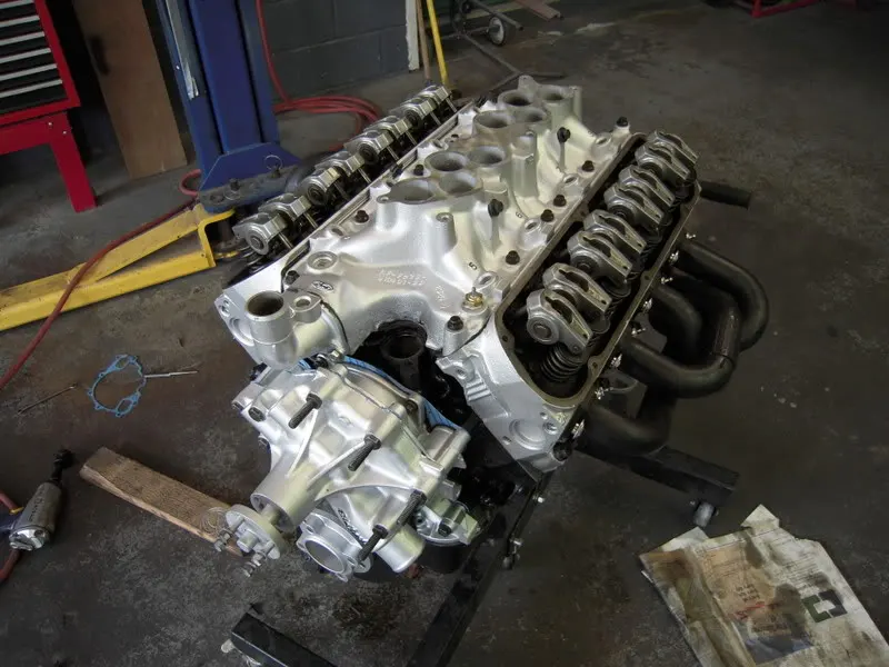

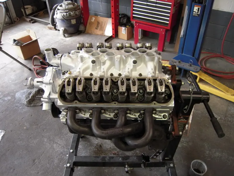

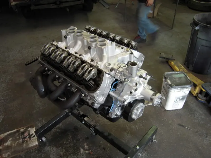

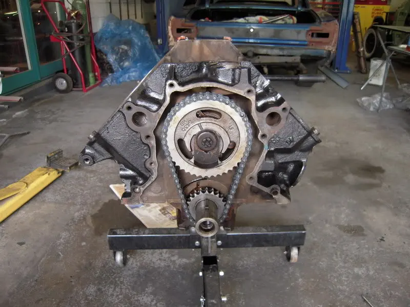

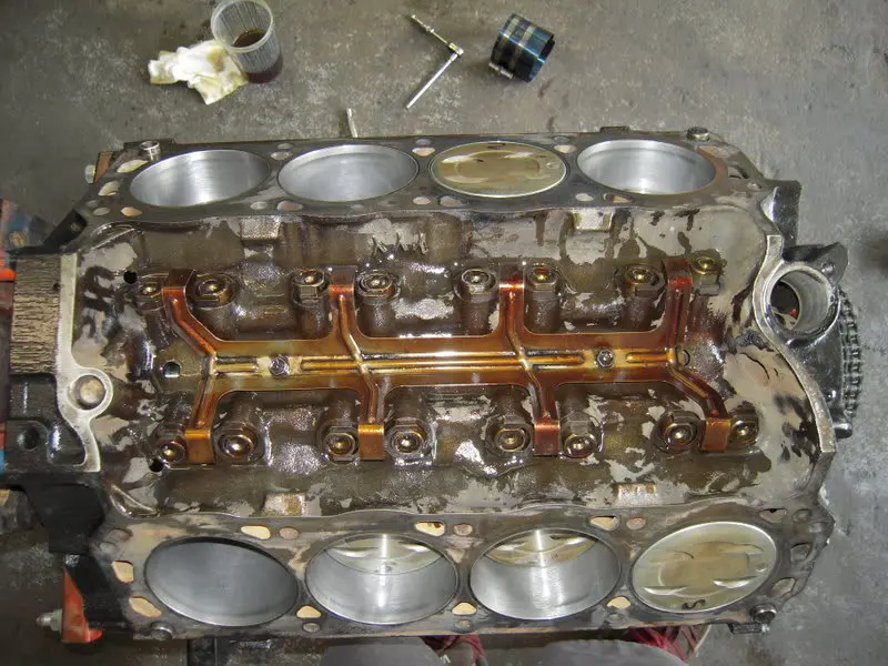

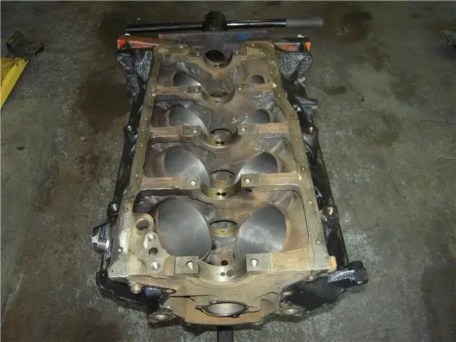

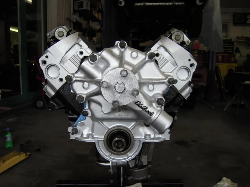

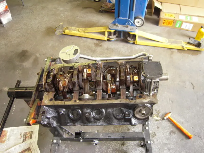

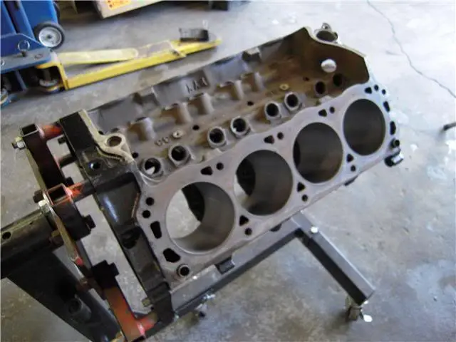

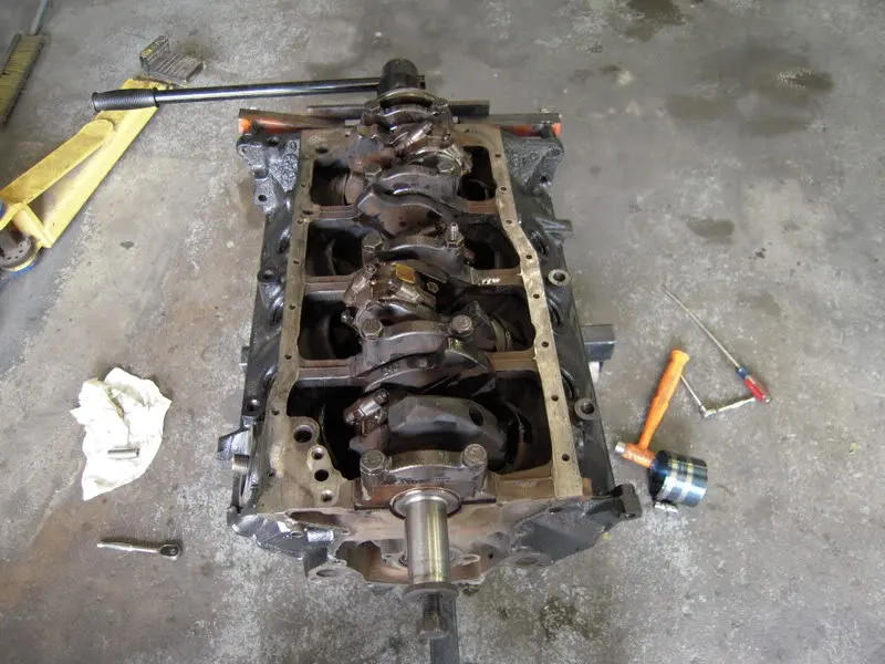

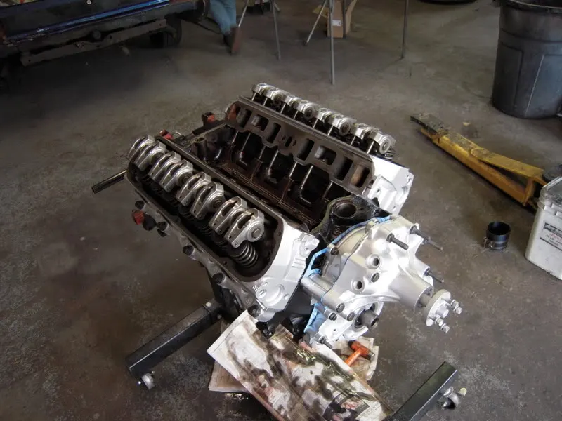

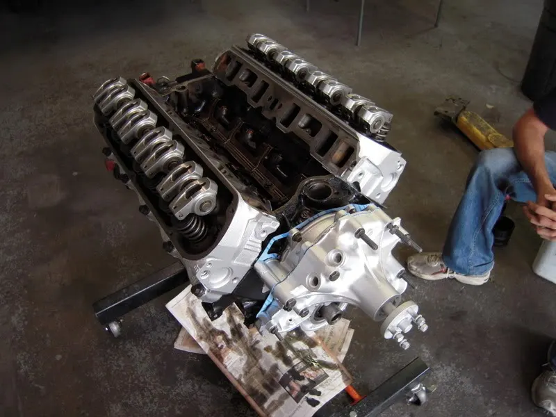

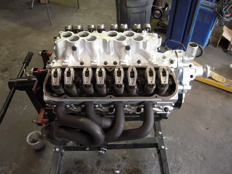

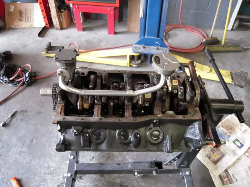

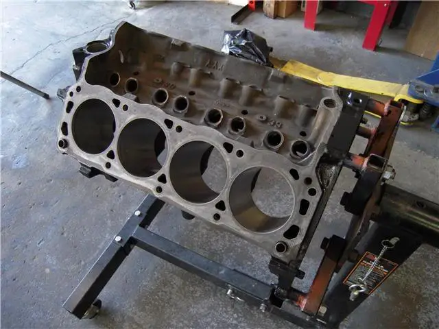

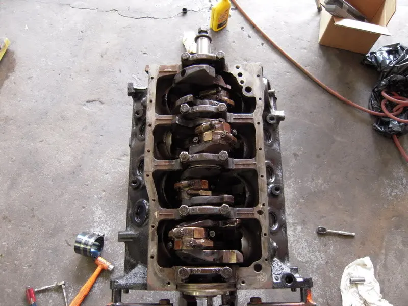

I built my engine this weekend. I did all of the work you see in six and a half hours. I was beat as hell by the end of the day!!! Im really happy with it. I started putting the front accessories on it today but I'm waiting for my polished underdrives and polished aluminum power steering pump pulley. I also have to paint my phenolic spacer and valve covers and finish cleanin up my injectors and reinstall the fuel rails. So far Im extremely happy with how it looks.
They are actually real 93 Cobra GT-40's matched with a 99 Explorer Intake and a E303 cam. I'd like to get some 1.6 rockers and do the intake/exhaust stagger cause the heads dont flow past .500" lift and I have .528" lift but the 1.7's will do for now. I'm also going to be spraying a 125 shot for fun.
yeah it looks like it'll be a pretty stout combo man, it should be fun as hell to drive! i want to run a shot eventually too...i just got a new job today that pays more than the 2 i was working at combined, so hopefully sooner than later! :D
