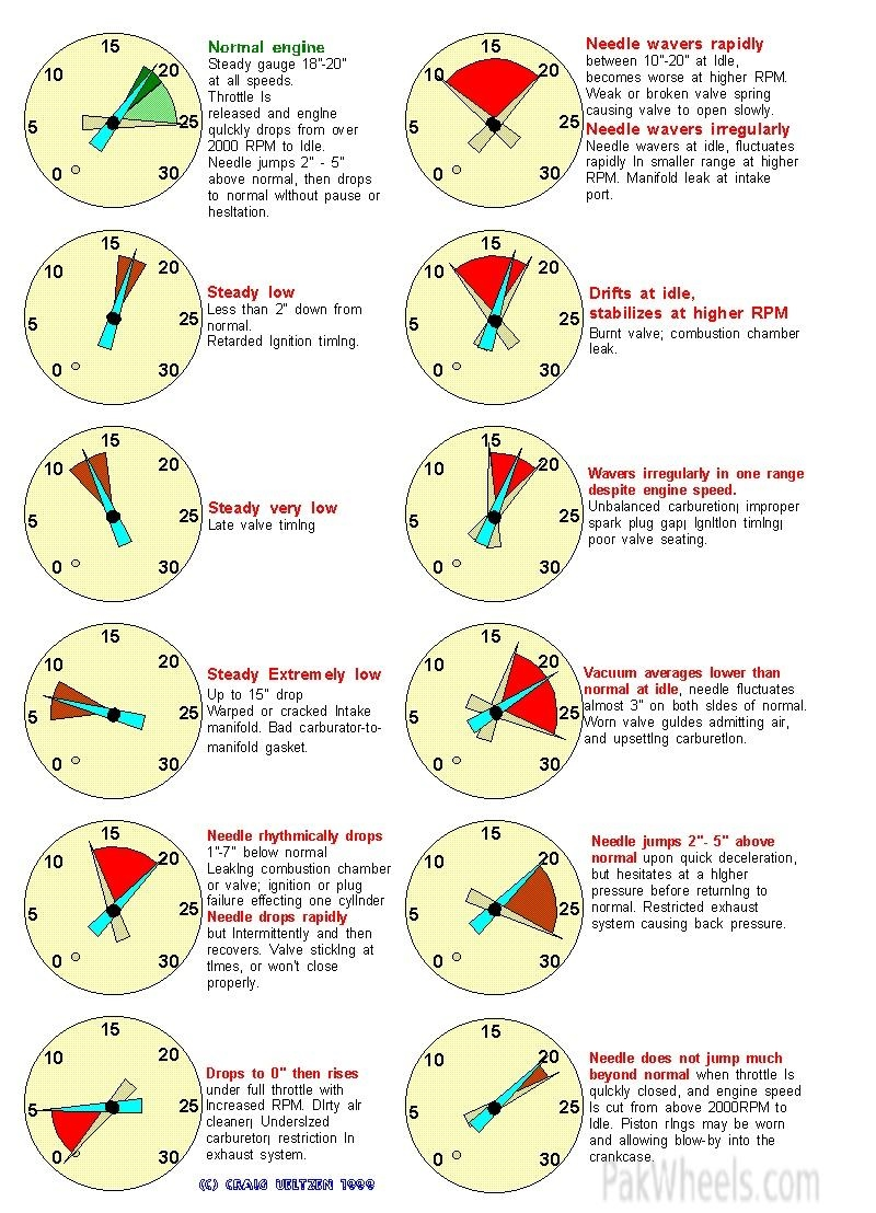

Beg, buy, or borrow a vacuum gauge... backfiring out the intake is due to a lean fuel mixture in most cases.
Vacuum gauge indications:
