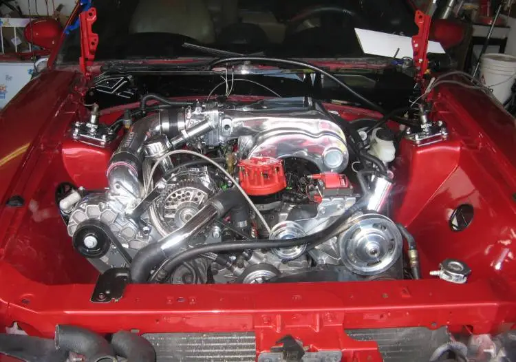

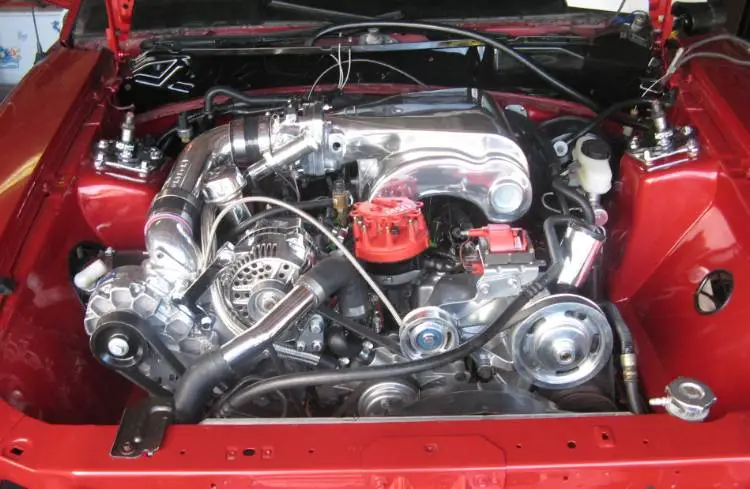

I think this is about the 7th full day of working on the car (more than 6 hours at a time). Here are 2 pics..one with and one w/o flash.
We found a GREAT new place for the MSD BOX:
Here's what we got done:
Most all the harnesses.
Upper Intake with 3/8" phenolic spacer on.
Vortech Discharge tube
Radiator and fan
Throttle cable connect
H-pipe connect
Drive shaft connect
O2 sensors on
Wide band 02 sensor on
Mount MSD box
Starter on
Some other small stuff.
OBSTACLES: with harness relocate, there were lots of wires to lengthen. WE used heat shrink and Leaded solder for the connections and wrapped everything we could in wire loom and 3m super 33 electric tape. We decided to go with black loom instead of the faux chrome stuff.
Had a #@#9*@ time getting the front left bolt on the intake...couldnt figure out why. Turns out that the front phenolic spacer hole did not quite line up...had to be bored out a little to open up and make room for bolt.

Question for you though... are you not planning to drive your car in the rain? I ask because of where you mounted the MSD. I know the inner fender doesn't cover that area and it will be exposed to water and road grime. Its a cool location, but I'd be a little leery of placing it there as that's a pretty harsh environment in there.

I will not "plan" on driving the car in the rain, especially with all the power and going to put DR's on the back. However, in S FL, it can rain at any time. That area where the box is is recessed several inches, and all the wires are loomed in immediately after exiting box. Doesnt mean it's ok to hose it down, but it does seam pretty safe there in the event of a shower or so while Im driving. Thanks for the heads up.!!

Lookin Good! Another thing about the box location, make sure that at full lock the wheel doesn't make contact. I flipped my TFI module to the inside of the fenderwell and the tire would hit and pull the harness out of the module.
That area the box is in is recessed back there is a sheet metal on the left and right of it. If you think of the strut tower from the inside of the hood, how it is recessed inward.....it is in the hollow part under that
