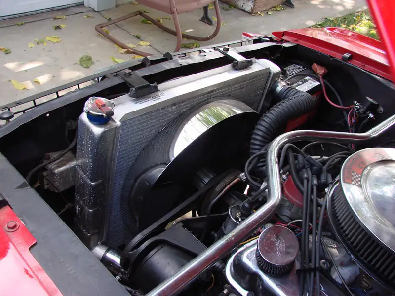

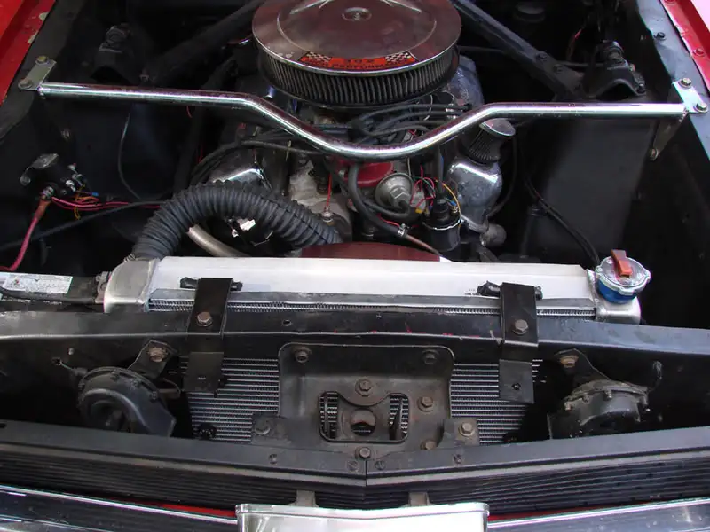

i used the summit racing brand aluminum radiator - the 25.75" one
i also used the summit racing brand universal radiator brackets

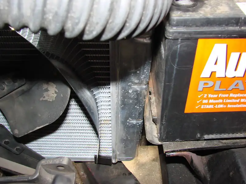

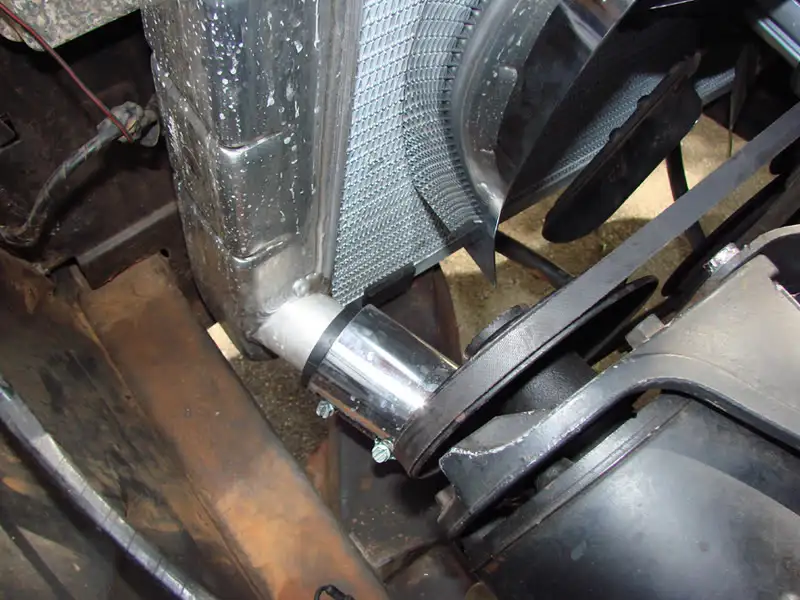

had to trim about 3/4" off the battery box, because i used a 25.75 inch radiator. i just used a sawsall for that. i also should probably have upgraded to a late-model water pump so the inlet was on the drivers side, but i bought a kragen chrome flexible hose.

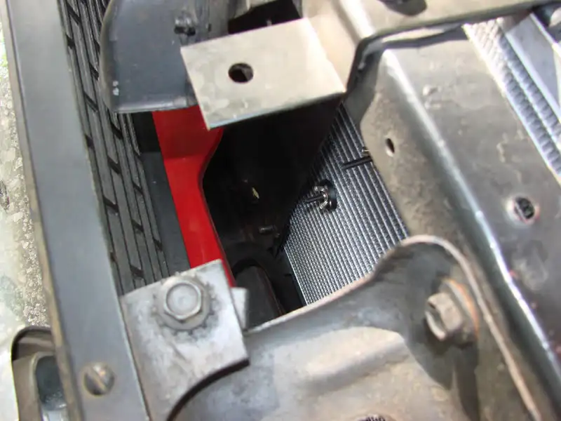

the brackets i used are the summit universal brackets. i used the factory holes to mount the lower brackets using the factory bolts, but i think i might have drilled holes in the brackets to drop it down a bit. the top ones didn't line up very well, so i rolled up some rags and taped them as insulators.
i did this within an hour of getting it in the mail, as it's my daily driver and don't particularly care for the small things like making the top brackets look nice etc. i needed to drive it to work the next day, so functionality was priority over cosmetics.
on my new coupe, i have relocated the battery to the trunk, and removed the tray completely. this will give me proper room. i also bought the summit bracket kit again, but i fabbed up my own top brackets.
anyways, here's the pics
