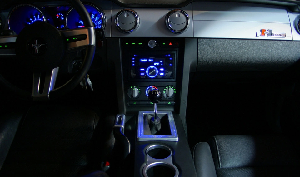

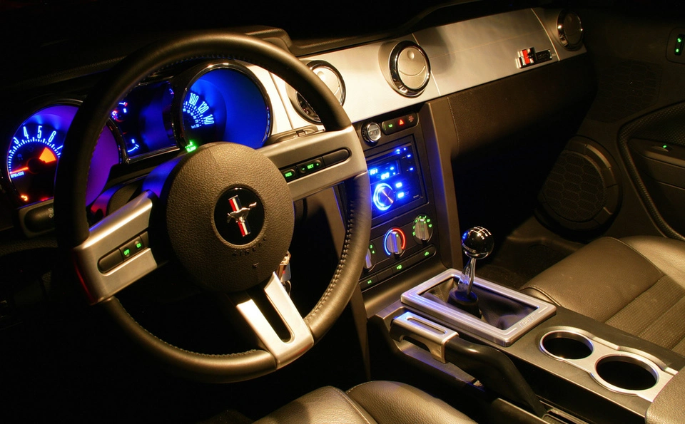

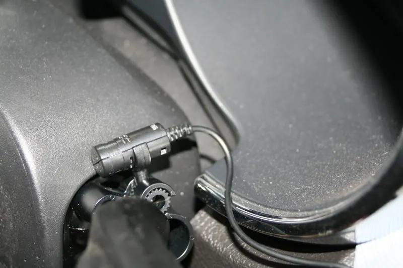

I took a couple hours "off" yesterday and installed my new radio. It's the Pioneer FH-P8000BT. I wanted it mostly for the iPod interface, but it has bluetooth and all kinds of goodies. It also matches the blue that I use for my dash lights. Let me tell you. This this sounds amazing. I was shocked. I didn't figure just upgrading the head unit would make so much of a difference in sound. The iPod interface works very well. Now I can stick my iPod in my glovebox and control it all from the receiver. It looks fantastic and matches the blue MyColor so well. Given everything going on, I didn't have time for a write-up, sorry guys. There were a few modifications necessary to make it work properly with the Shaker 500 (as with every aftermarket radio) but it was very simple. All you need to do is wire in a 5V voltage regulator to the remote turn on so that the subs don't pop when you turn the unit on, and connect a rca female to 2 male y adapter. Otherwise everything is just as the instructions suggest. Anyway, here's a pic.

Looks really good in there:nice: :nice:
I'm just wondering if we have the same setting for the blue My Color lights:rlaugh: I don't remember the combo since I've had it set that way probably since last spring.
I'm going to get some more and better pictures when I have more time. It definitely looks great in there, that's for sure. Aimee is quite jealous. :)
I have no doubt that we're probably using the same setting. I would be more surprised if we were not.
It's just the way I take the pictures. It's no brighter than the dash lights. I'm pretty sure it dims with the dimmer control, I just haven't messed with it yet.
The last time one of my interior pictures showed up in SHR's ads, Marcello got 3 calls/emails asking how to get their interior lights to look neon-like lol.

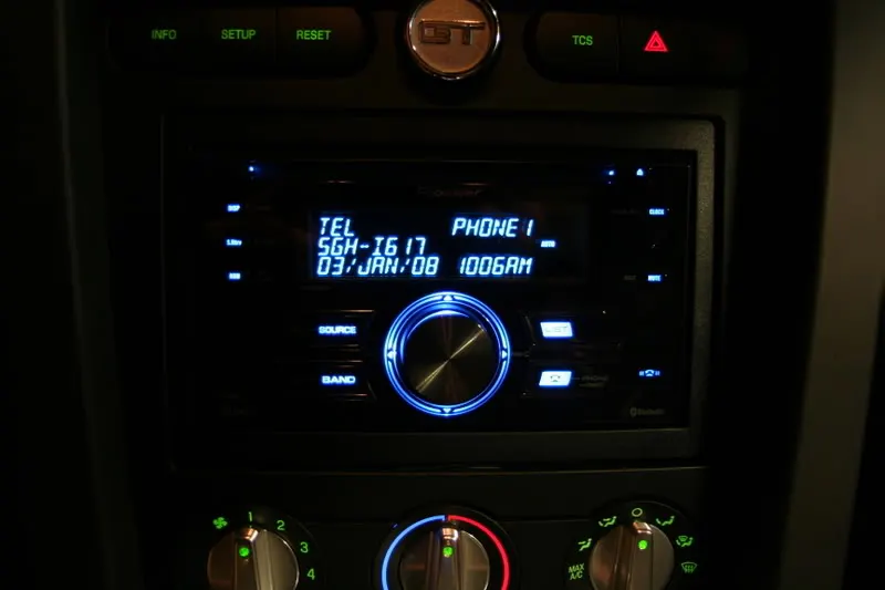

Yes, it definitely has a regular tuner. As you'll see from these two pics, I just had it sitting on FM.

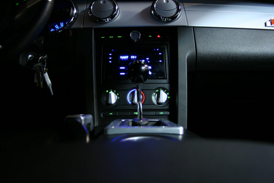

Here's another 2 pics.
