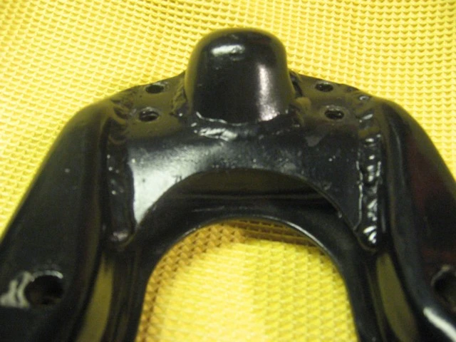

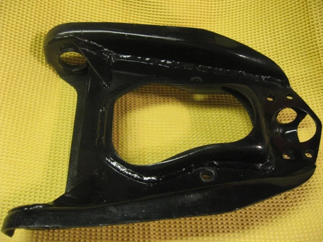

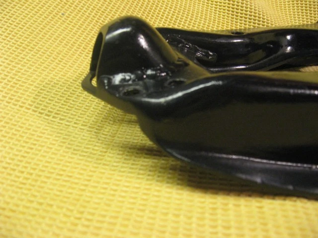

So I was installing my new 17x8 245/45R17 rims and looks like the back fit with no problems but when I got up front, it looks like the rims are hitting the upper a-arm.
How would I fix this problem?
What would be the best option to go?
P.S these came off a 94 Cobra.

I would grind back the ball joint dome. The rim isn't going to hit the ball joint, the sheet metal of the arm is in the way. Removing some of it won't hurt a thing. I would do that before putting in any kind of spacer.

I put a brace on the top and bottom. Either one will do it, both is overkill. Your not removing that much metal, no brace or a small brace of some kind would do it. It's just cutting off a bit of the ball joint dome so the bracing may not be needed at all. The brace I made for the top was easy to make and easy to weld in place. That would be my first option. With a upper arm like this, you can run a 15" wheel with 4.75" of backspacing.
