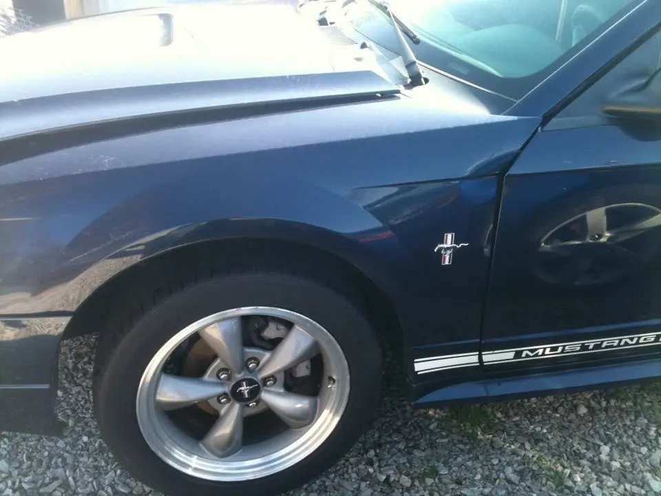

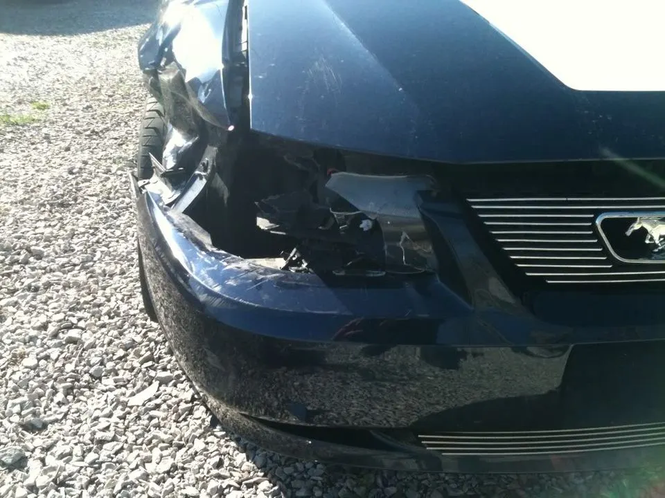

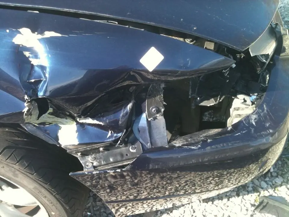

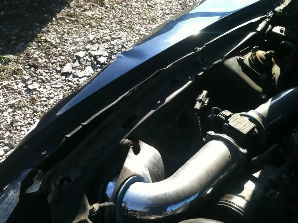

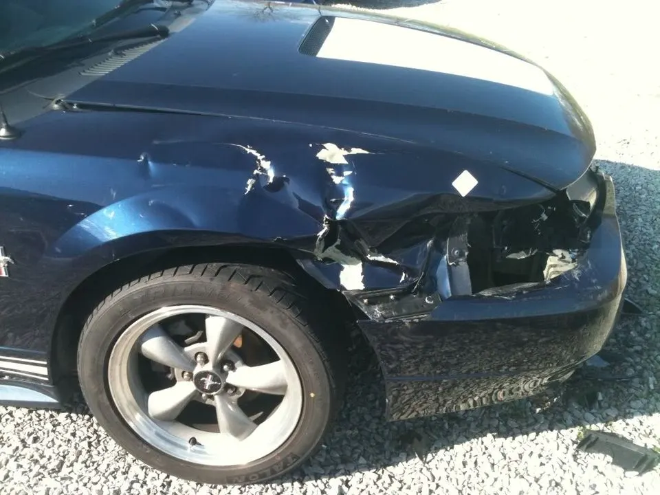

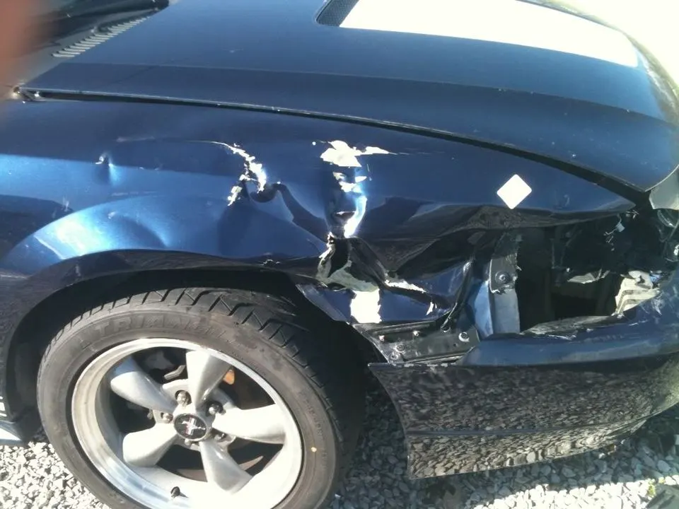

So long story short, my mother was in an accident and insurance is totalling out her 2001 Mustang (v6). Im going to buy it to use for my project, just trying to get an idea of what im looking at in terms of fixing it. Looks to me like it will need 2 new fenders, hood (need at least a 4" cowl anyways) new front bumper and the cowl panel and headlight. The body APPEARS to be straight, didnt do any mechanical damage and the core support seems to be fine. Other than beating the hell out of body panels the car seems to have held up pretty well. Going to get a set of fenders, hood hinges obviously, a 4" cowl and a cobra or GT bumper as of now, not sure what else I need.

that car needs to be brought to someone with a frame bench. It looks totaly nose pushed to drivers side. then you can try fiting the new K member in there and see it it lines up.

What do you see that makes you think it's tweaked? Like I said, I'm far from an expert so I'm just curious what to look for. The engine bay and core support seem to be unmoved.

pull the bumper and fenders and get a better look at it, if its going to be trailered to the racetrack all the time then there is no reason to build a overdrive trans, lotta money for no reason... Why arent you going to drive it on the street tho?
