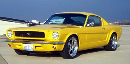

I’d like the car to seat like the photo below (SN65 stang) but prefer a bigger rear tire (tubbed?)
