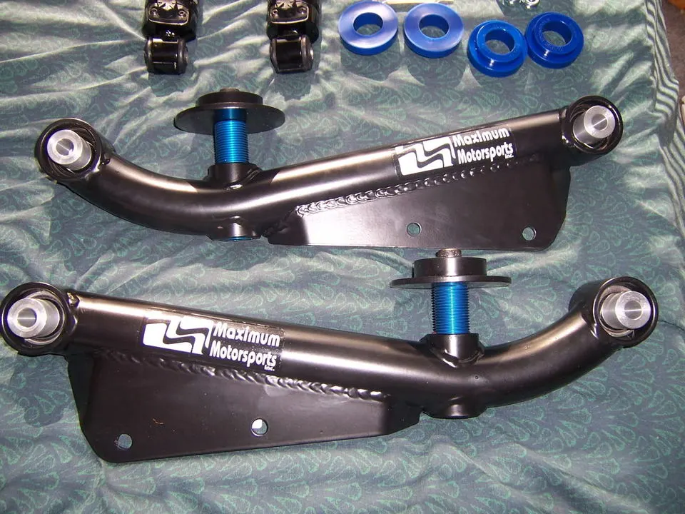

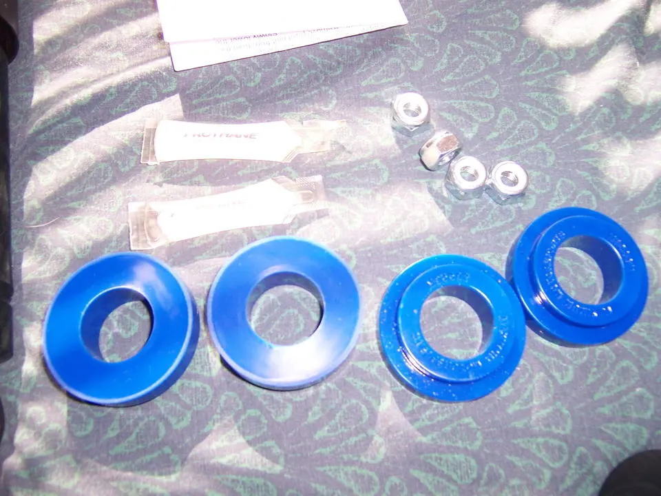

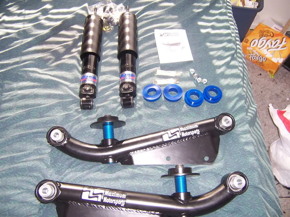

Some of the suspension parts for the rear end showed up, so I snapped a few pics. Still waiting on a friend to bring me some stock Fox coils, and the front Strange 10-ways to show up. After I save up a few bucks since I just blew everything I had left on a nitrous setup, I will be getting battle box reinforcements, adjustable upper control arms, and the big daddy, a tubular K-member. This thing should launch fairly well, or so I am hoping.

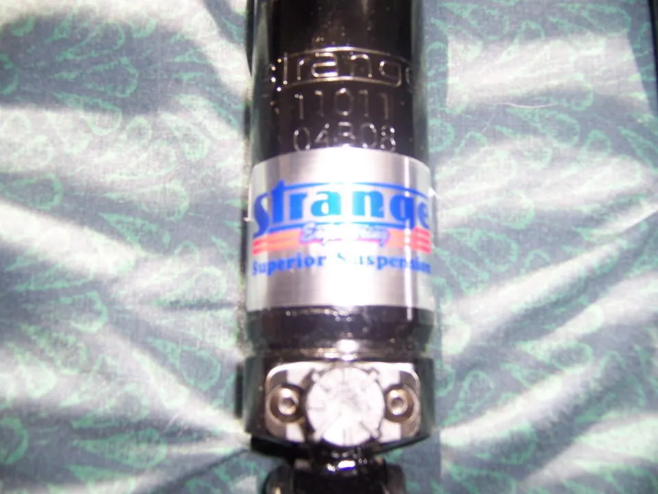

Those are Strange 10-way adjustable rear shocks and maximum Motorsports Extreme Duty Adjustable rear lower control arms. These arms are beasts!

I will forewarn you about those lca's. I have Steeda lca's that are setup the same way with the adjustable spring perch. because of the design, the rear sway bar mounts are "alot" lower than stock. My rear swaybar is only about 1 1/2" off the ground in the low spots. Not a big deal unless the roads in your area have alot of potholes and such.
