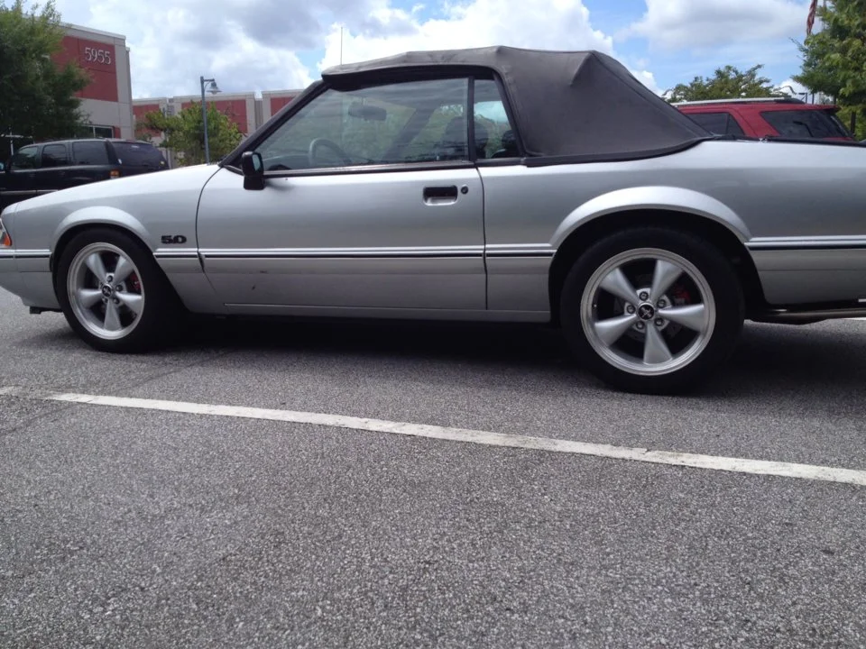

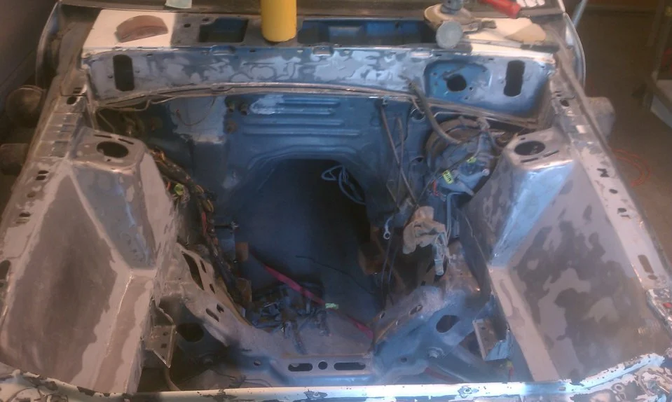

This is how my car sits, haven't driven it ever. When I bought it I rolled it off a trailer into my garage and tore it apart. I got all the suspension done and now I'm smoothing the engine bay. Sorry I can't tell you how it rides till Spring of 2015 so I'm no help to you.
