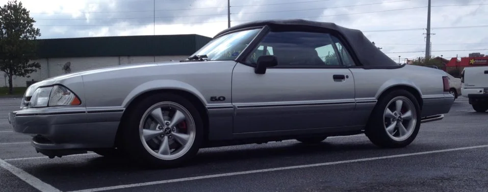

Well, I was able to get the stance a little more dialed in over the weekend. It looks much better. I think anyway. It should "settle" a bit more over time.
I ended up removing the upper and lower isolators and just wrapping the ends of the springs with a couple of layers of electrical tape. Just to keep it from being metal on metal. I also removed the quad shocks. I installed new ones but I really think they were "bottoming out" and not letting the rear end travel correctly. I also loosened the UCA and LCA, preloaded the rear end and then tightened everything back up.

NOW that's the right stance that looks sexxxy! God job. So what did you do to get it like that? Loosened stuff up and tightened it back up???? That's it?

Thanks, I'm happy with it now. Yeah pretty much. I didn't have to cut anything. I loosened up the upper and lower control arms, jacked up the rear end to simulate load, and then tightened it all back up.

That's awesome and that was NOT any advice that we gave you if I remember correctly. Way to go bro! I think that may be what I need to do but I need to get my engine & trans installed and let it sit before I do anything else.

Glad you got the stance where you like it. I think i said to recommend removing the isolators and that the position of the pigtails will change the ride height. Mark the pigtail and the control arm so in case you need to remove the springs you know where they go back.
