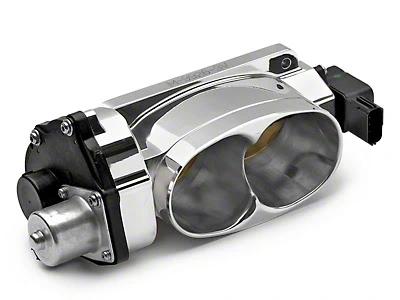

So I purchased this throttle body.
Ford Performance Twin 62mm Throttle Body (05-10 GT)
Do you have any suggestions for tune brand or type? I don’t want to spend a ton of money this early in the game. I want to get her back on the road ASAP!

I don’t recommend this with any other engine bolt on, but unless there’s a document saying TUNE REQUIRED to use, you can bolt this up & run it as is until you get a tune, since you’ve already a have a preset TPS, it’s not that drastic of a change (55mm2 vs 62mm2) that the motor won’t adapt, a tune is not required, BUT- if it says it does t ha t it REQUIRES A TUNE somewhere- there’s a reason.
Mine is identical, F.P. 62mm, program recommended for best output, but not a NEED. Plug & play.
Potentially changed something, if it REQUIRES a Tune to run. I tune & have never run into that with these size TB’s, Ford, Accufab, BBK, I’ve used most in people’s S-197’s.
Can you PM me a shot of the spec’s? Or it’s P/N? I’m curious. If it SAYS to wait & get a tune, follow their advice, entirely. Only be 2-3 days if you buy tonight.
If they instruct something- there’s a reason for it. Not worth any chance- right?

I had recently replaced the stock throttle body on my Lightning with an Accufab item. At LightningRodder.com, there is a thread called Lightning Modding 101. It states that a tune is not necessary with a throttle body change. It may help, but is not necessary. I've had the Accufab on my Lightning for over a year with no tune. Runs freaking awesome. It was said that a throttle body change will likely only result in throttle response being better, since the original Lightning tb was a twin throat like the one you posted, and the new one is fully open oval. Yes, throttle response is excellent and much better than it was stock.
I've also, with no tune, been running a Magnum Powers blower in place of the stock Eaton. A Johnny Lightning Performance plenum, C & L elbow in place of the stupid crinkled rubber part, and a huge K & N powerstack filter on a Lightning Force Performance adaptor. And the two rear cats are deleted, the two forwards being replaced with Magnaflow high flow cats. And the lower crank pulley replaced with a larger one that makes ten pounds of boost, stock is eight. Not one single problem. Runs frikkin awesome. Plugs look perfectly normal, no sign of lean, detonation or pinging. I do run 93 octane in it and nothing else.
Another one you might be amazed I'm just mentioning, is throttle bodies and plenums, as these are a lot of owners first modifications. The stock throttle body isn't all that restrictive in an Eaton M112 setup. The gains most people claim to feel by installing one on an Eaton, come from increased throttle response, not from power gain. Good aftermarket throttle bodies are made by Accufab, LFP, and Magnum Powers. You can also port your stock plenum, or add an aftermarket C&L or JLP sheetmetal plenum if you like. You won't see huge gains on a Eaton with these modifications, but you will see some. Tuning after these modifications is not required, but can help with drivability if you have problems.
