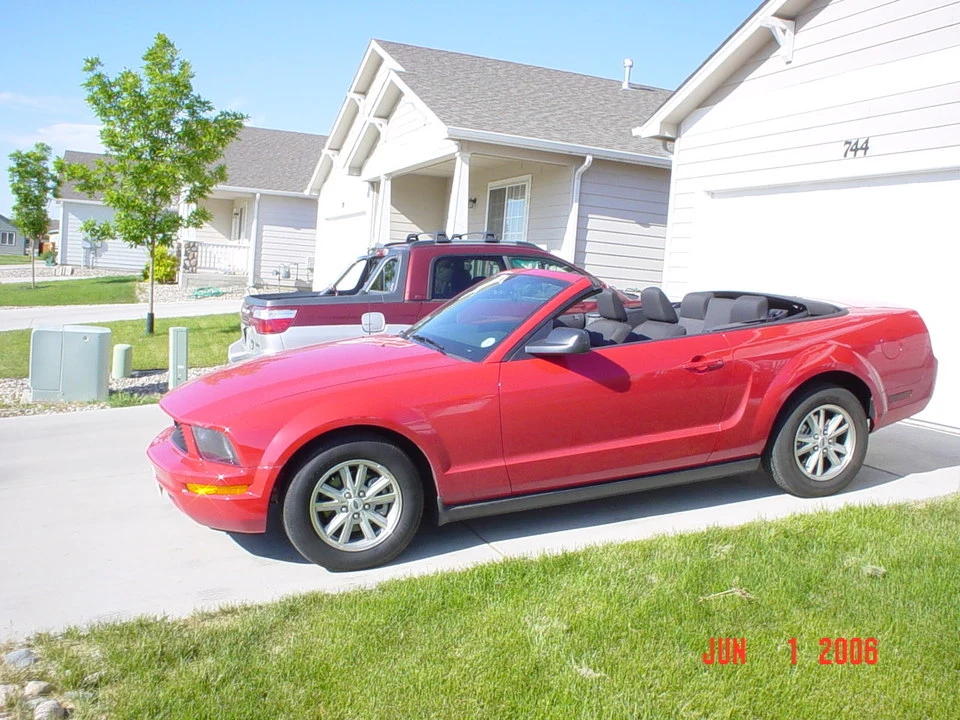

The "before" pic. Very much a "Plain Jane" Mustang.

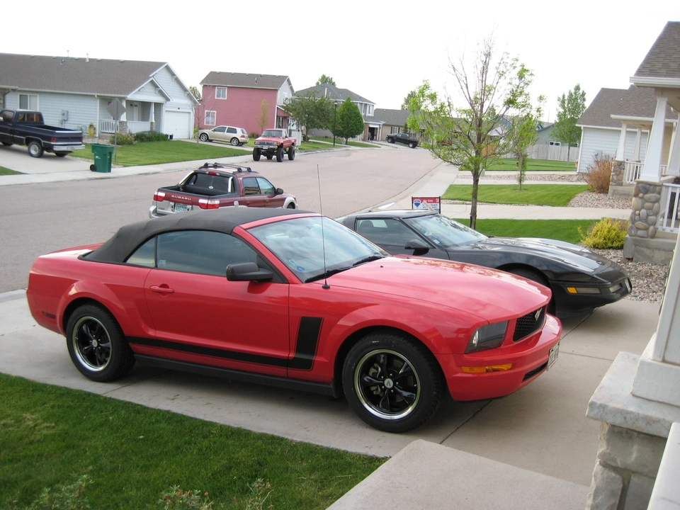

The "after" pic. While not fantastic like a GT, it still looks great.
