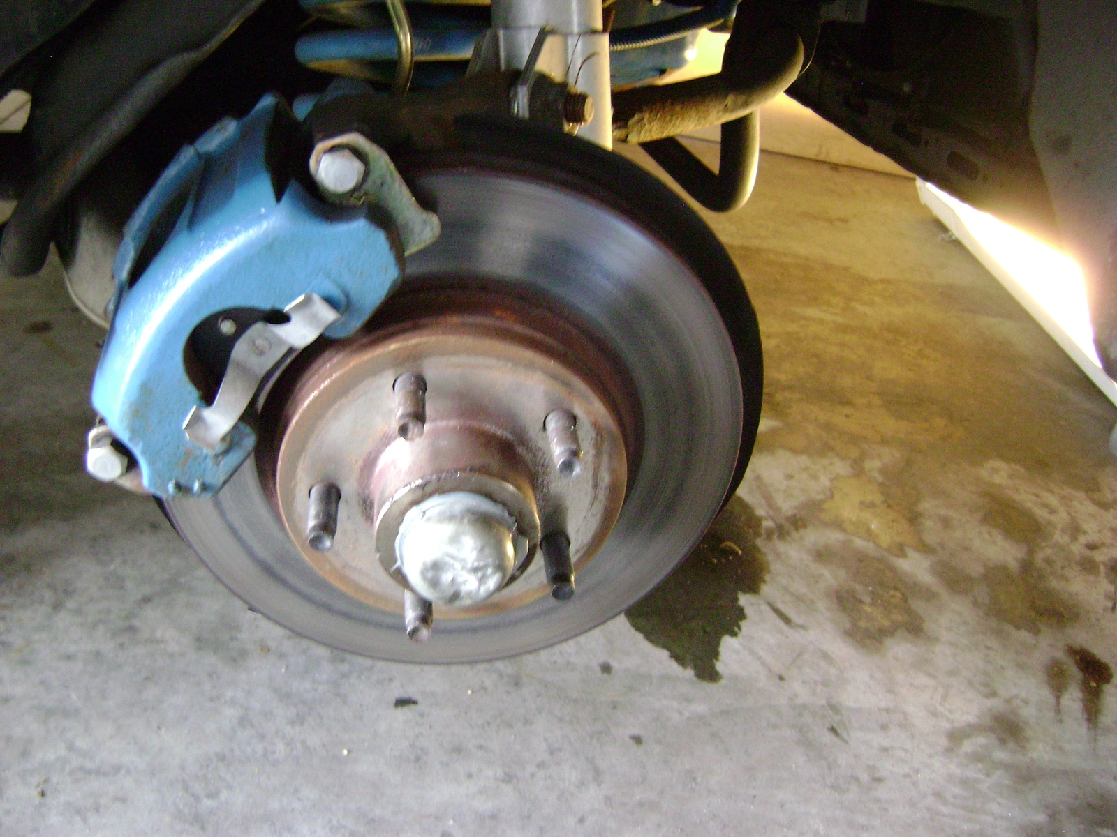

Hi there,
I have been reading some of the threads and getting good info about my first Mustang. I have some questions about wheel sizes and what wheels will fit, but I will try and post in the proper place before I go any further. I have always wanted a Fox body and bought this about 1 year ago in WI. It was last titled in Washington State and I would like to know if anyone out there knows this car. It has a fair amount of popular mods...5 lug conversion, lowering springs, subframe connectors, etc but the details are not known by me. Like what kind of spindles are they? the rotors measure 11" and it is a single piston caliper. I hope I can figure this all out with a little help from the community.

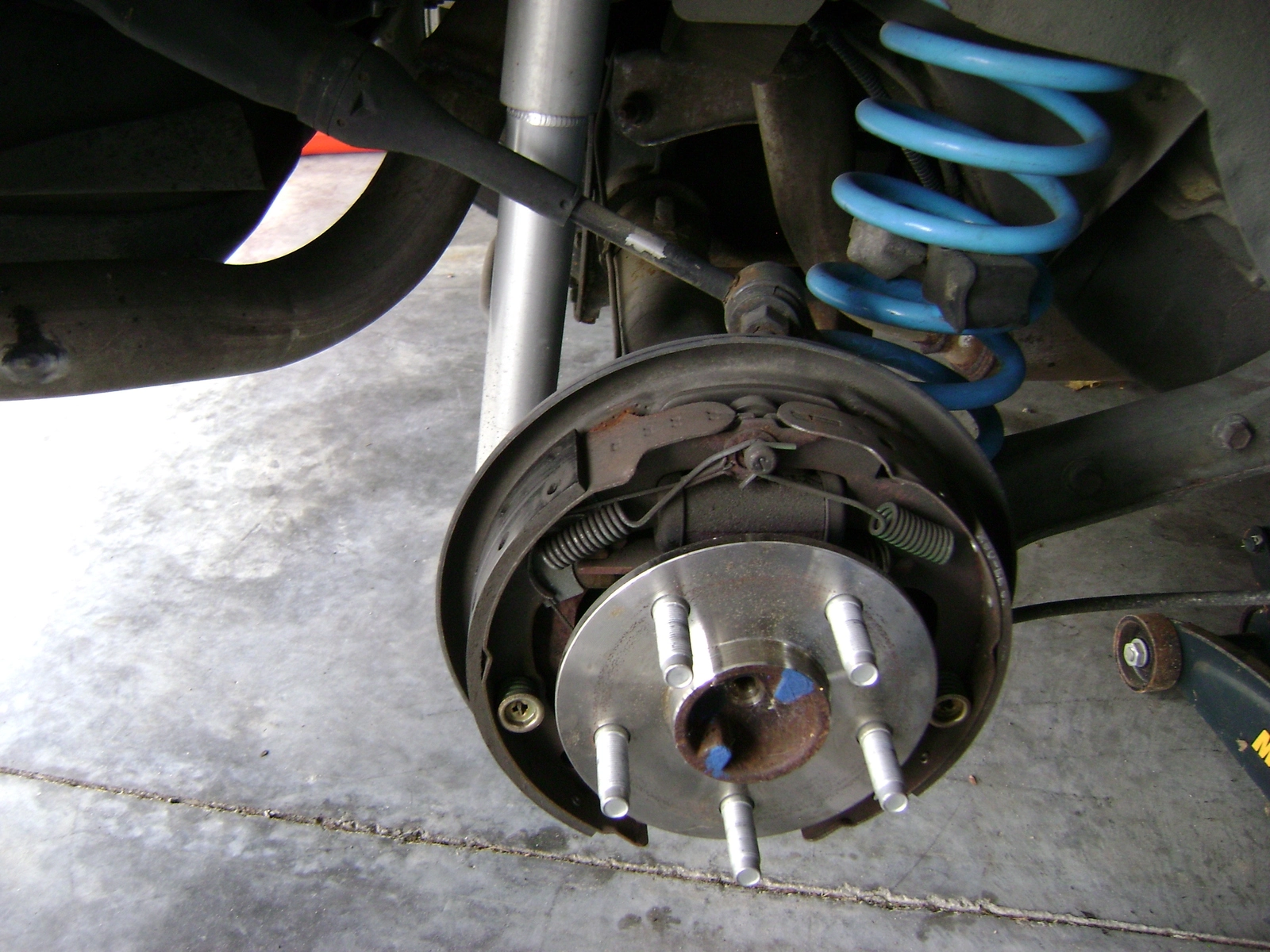

Welcome to the forum!:nice: As far as your brakes, it looks like a stock sized 5-lug conversion. The rotor and caliper look to be stock with an extra wheel stud, and your rear looks stock with a new axle shaft. Spindles also look stock. Probably the P.O. bought a set like this:
http://www.latemodelrestoration.com/item/LRS-4234K/1987-1993-Mustang-5-Lug-Conversion-Kit
Hope this helps!
That helps me get started, trying to fit a wider front wheel tire combo on the front, would like to go 17x9 front and rear. It has 18x8 rear (275/40/18) and 17x7 front (205/50/17) now.
Let me correct myself, it looks like stock 5-lug for an 87-93 car. Yours is obviously a pre-87 fox, and those came with the 10" rotors stock. So, it would appear that someone did the larger front brake swap with the 87-93 5-lug conversion.

If you're autocrossing, you're going to need to do a complete Cobra brake upgrade. The trouble is that kit prices for these upgrades is high and piecing everything together to do it cost effectively takes time.
A side effect is that your rims may not fit over the front 13 inch Cobra rotor and large brake caliper.
