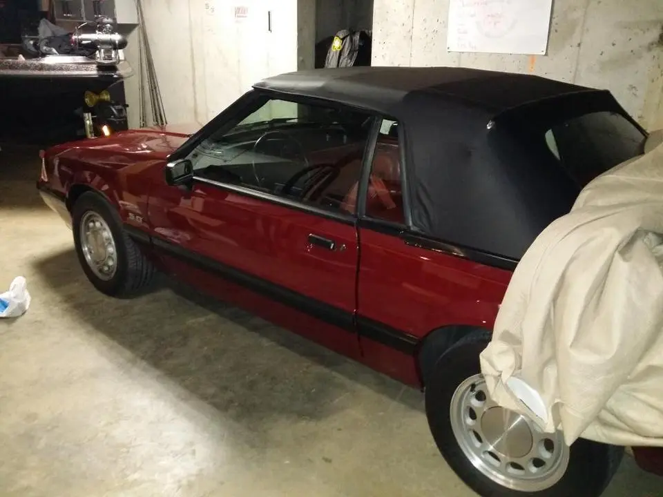

Just bought a 1990 LX 5.0 Convertible with 76,000 original miles. Automatic, all original down to tire, wheels, stereo and everything under the hood. Bought it from a 83 year old man going into assisted living that claimed he had it up to 87MPH once. It has been stored in climate control under cover for the last 6 years with it being driven to dealership where it was bought for an oil change and I have every piece of paper from each service and oil change.
I recently bought a 70MM throttle body and it all went well but I can't get the cruise control cable back into the black plastic grommet on the new SR throttle body. Is it a big deal or should I just leave it unhooked? The old throttle body had a clip I removed and it came out. This new one is black and pressed into the arm and look like maybe you can press it in but I can't get it in. Tried lubing it up with WD40 and surgi-lube (wife delivers babies) but nothing has helped.

Nice,that is an awesome color combination,I wouldn't change a single thing.Keep that car as original as possible,Ten Holes and all(But if your going to drive it,new tires,just hang onto the originals).
All original Foxes are where the money is now,even more so as time goes on.

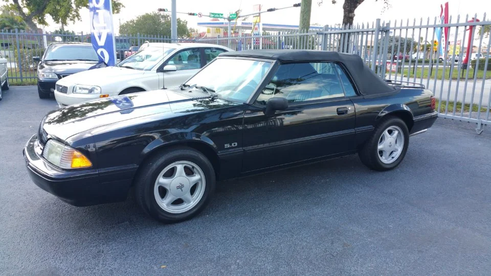

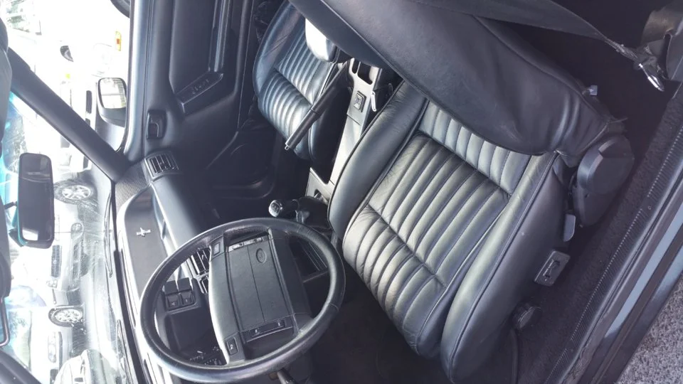

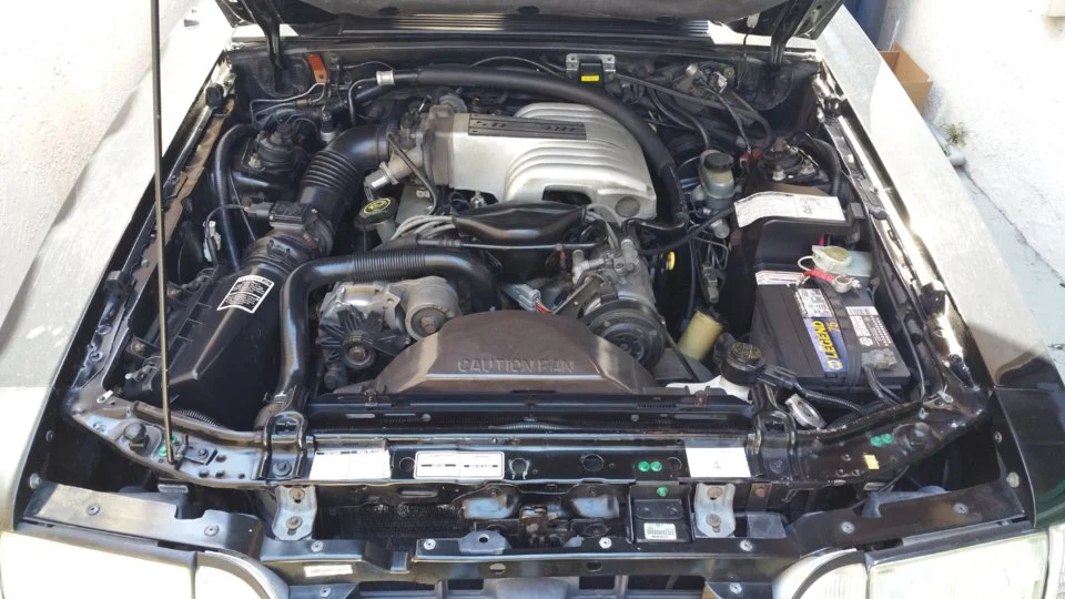

Depfreeman450, I just bought a 92 5.0 Convertible 5 speed with 41,000 a week ago. It also had stock everything. All I did was install Flowmasters and an HPipe. The cats were corroded and had exhaust leaks. All I plan on doing is replacing the speakers, they sound like crap but leaving the stock radio.
May I ask how much you paid for it
