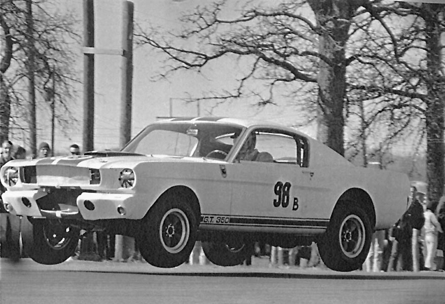

It's feasible to get up to 350 hp from a 289. The 302 is a 289 with 1/8" more stroke. Just how far is up to you and your wallet. You'll need some serious head work, or new heads to go all the way, but you could top 300 just by port-matching your exhaust and using a hot cam. This car, for instance, has a 289 with these mods, and it doesn't look slow to me.
