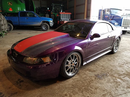

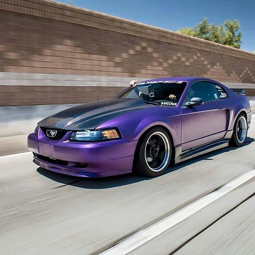

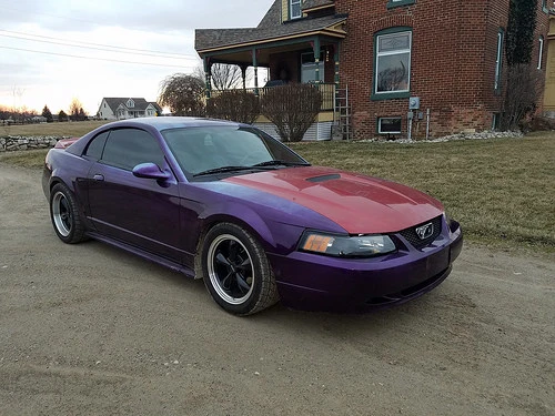

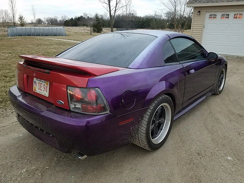

Here it is. I had to de-ghettofy it a bit. I bought it because there wasn't a spec of rust on the whole thing and it was pretty clean over all. The first pic is how it looked. Since then I put the black wheels on it with 335/35R17 back tires. I picked up a hood and trunk lid from the bone yard for $40 each. I'm undecided on the factory style hood or the cowl. I think I'm going with the cowl. Either one is going to get flat blacked out with SEM Hot Rod black. It'll end up looking like the last pic.
Before I write a book on you, I'll post a few pics. Feel free to ask about anything on it. I’m new to this Mustang, but I’m just finishing up restoring a 69 Camaro SS396, so I’m more or less a gear head.
After a little work:

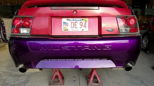

Thank you for taking those ugly rims off of the car, now if you can get some OEM tail lights that would help a lot. Jk don't want to come off as a jerk :D. Cant wait to read more about this build.:)
