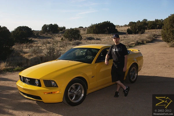

Anywho, I have a "Screaming" Yellow Mustang GT, and love her to death. Performance wise, she has a Flowmaster Exhaust, A GT/Hurst Shifter, and a Steeda strut tower brace. I have waiting to put on her a new K&N Intake, BBK Throttle Body, Steeda TB Spacer, Steeda Charge Motion Plates, an UnderDrive Pulley, and some other misc. mods.
A picture or 2:

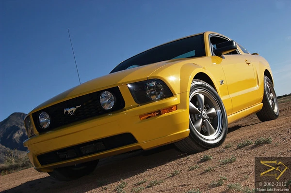

Welcome, and very nice 'stang...I love the anthrecite bullitt wheels.
