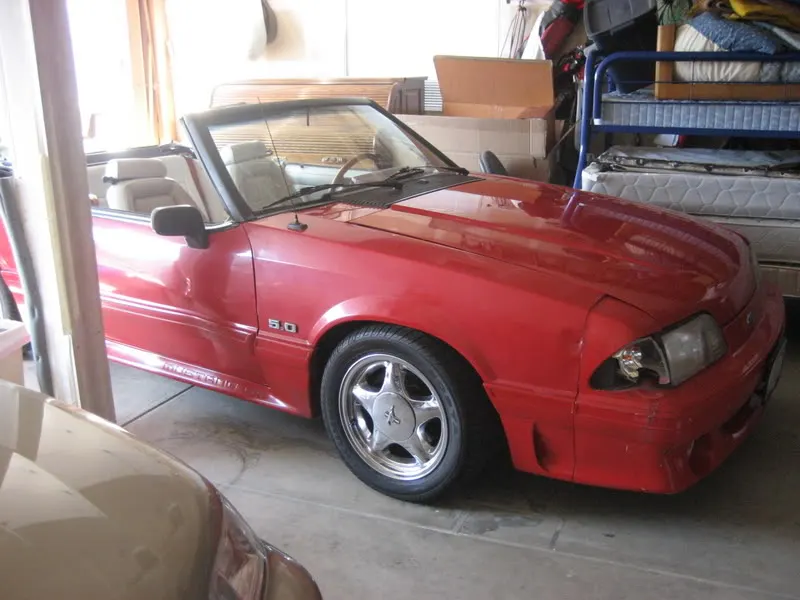

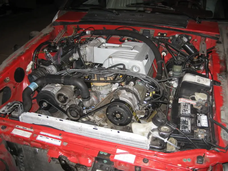

I just registered here on stangnet but have been lurking around for about a month or so. i have seen some people do like a progress page so i thought you might enjoy mine. i bought a 92 mustang gt red convertible in portland oregon. i drove it back. to spokane wa. so far i put a 5 speed in, did a 5 lug conversion, tore the body apart for paint, and rebuilt the motor. ive been a busy guy. i had never toyed around with a car and thought a mustang would be the best way to go. i did have a 00 GT but i only had it for about a month before i sold it. someone offered about 3k more than i paid for it so i was like. its yours. so for the motor i got some gt40 heads, a trick flow stage 1 cam, gt40 upper and lower intake, explorer injectors, explorer tb, aluminum radiator, electric fan, underdrive pulleys, 3g alternator, bbk headers, and bbk catless h, aluminum driveshaft, king cobra clutch, ford racing clutch quadrent, blue thunder short shifter, 00 shift knob, removed smog stuff. i plan to get some mac exhaust also. i also put on some eibach springs with 95 gt sway bars and have a strut bar to be put on. so far i think im on the right track. im looking into some 3:73 gears that i might install. but i need to get it painted next.

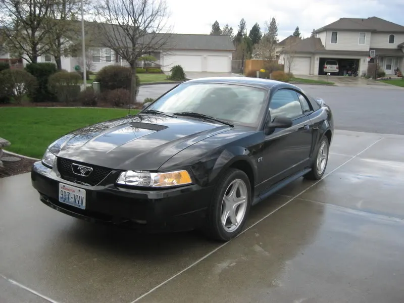

the old gt

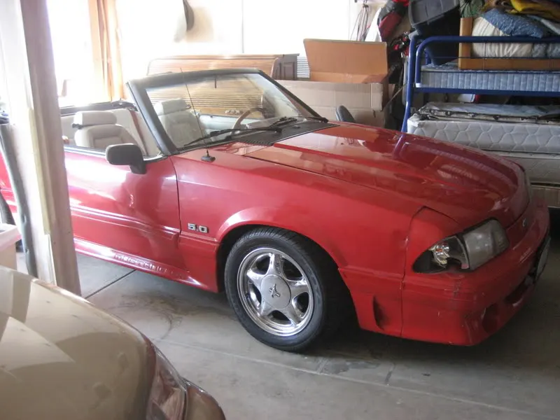

here it is in oregon the day i bought it

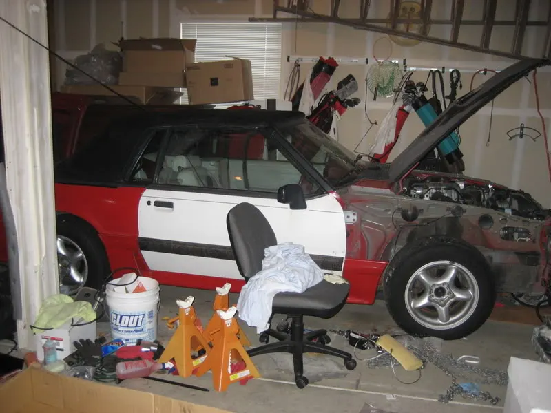

after the drive back from oregon

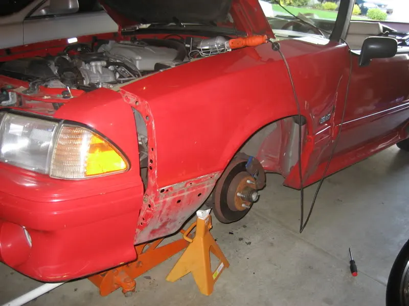

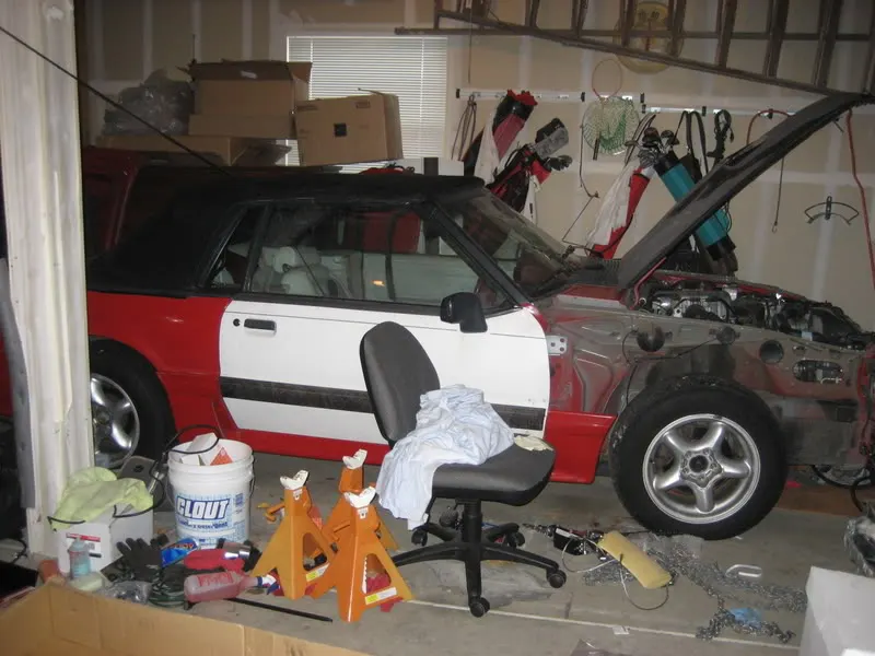

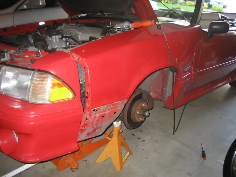

started taking it apart for the 5 lug swap and taking the fenders and front bumper off

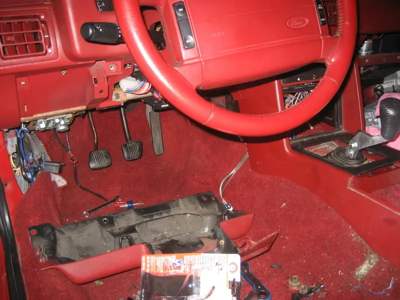

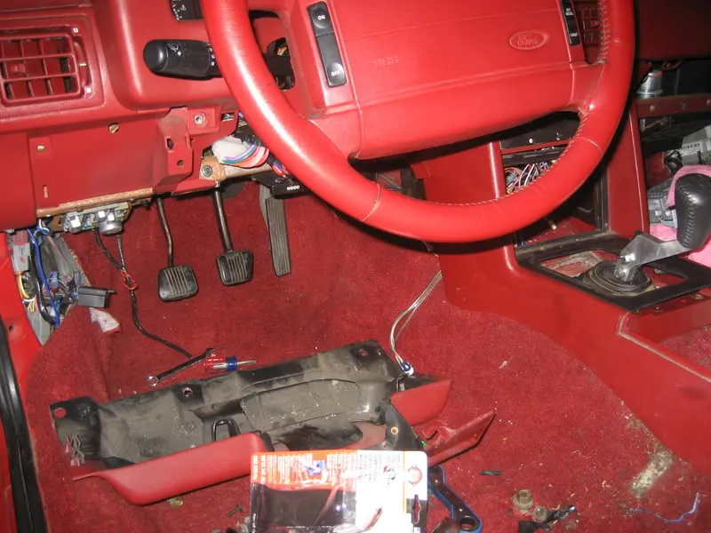

its a 5 lug car now
whats that shifter and extra pedel doing?

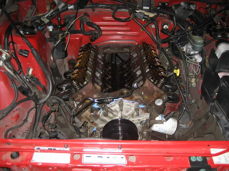

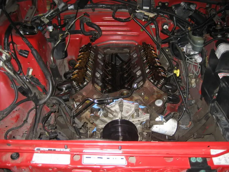

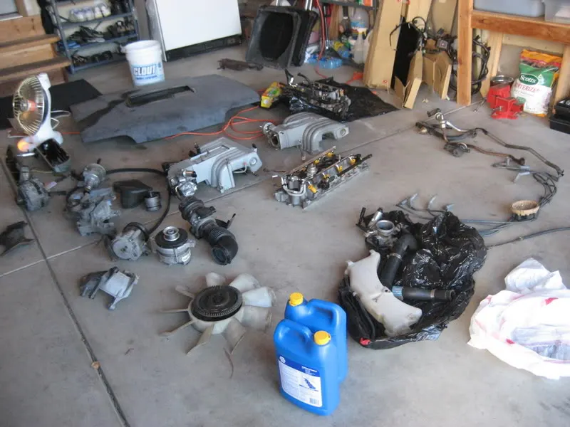

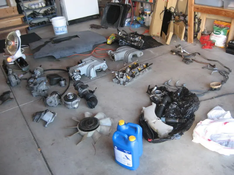

all the stuff from the motor work

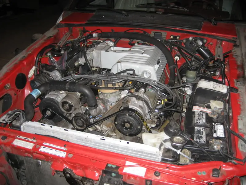

wheres the motor?

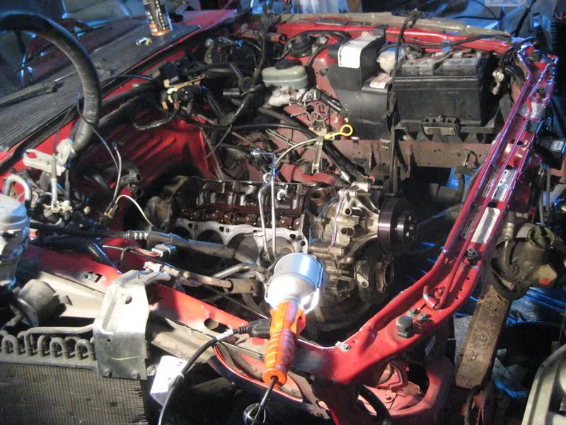

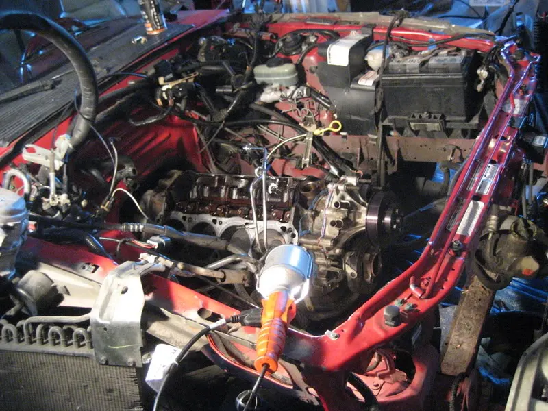

got the heads on
finally finished after a very long weekend. worked from 8 in the morning till 10 at night friday and then a few hours saturday.

hell yeah you are doing good!! Way to go man and good car to have as a learner huh?? there is a bunch of room under the hood of these cars to work around. Way to go so far, keep it up
hell yeah nice progress man! you're making good time, this being your first time and all. few questions though, did you torque down all the bolts to the proper torque specs? and did you use the correct torque down patterns on the heads and intake? just lookin out. :nice:
stock cam? good choice with the gt40's and the exploder intake, they have proven themselves very reliable!!!

thats good, but not just that, there's a proper pattern you need to torque the bolts down in otherwise you can warp the heads/intake.

yeah i did the propper pattern, i found it on a swap guide on the internet. ill get a video up soon. i still have to finish mounting the electric fan. i hate that its winter and cant drive it. i really wanna take it out
