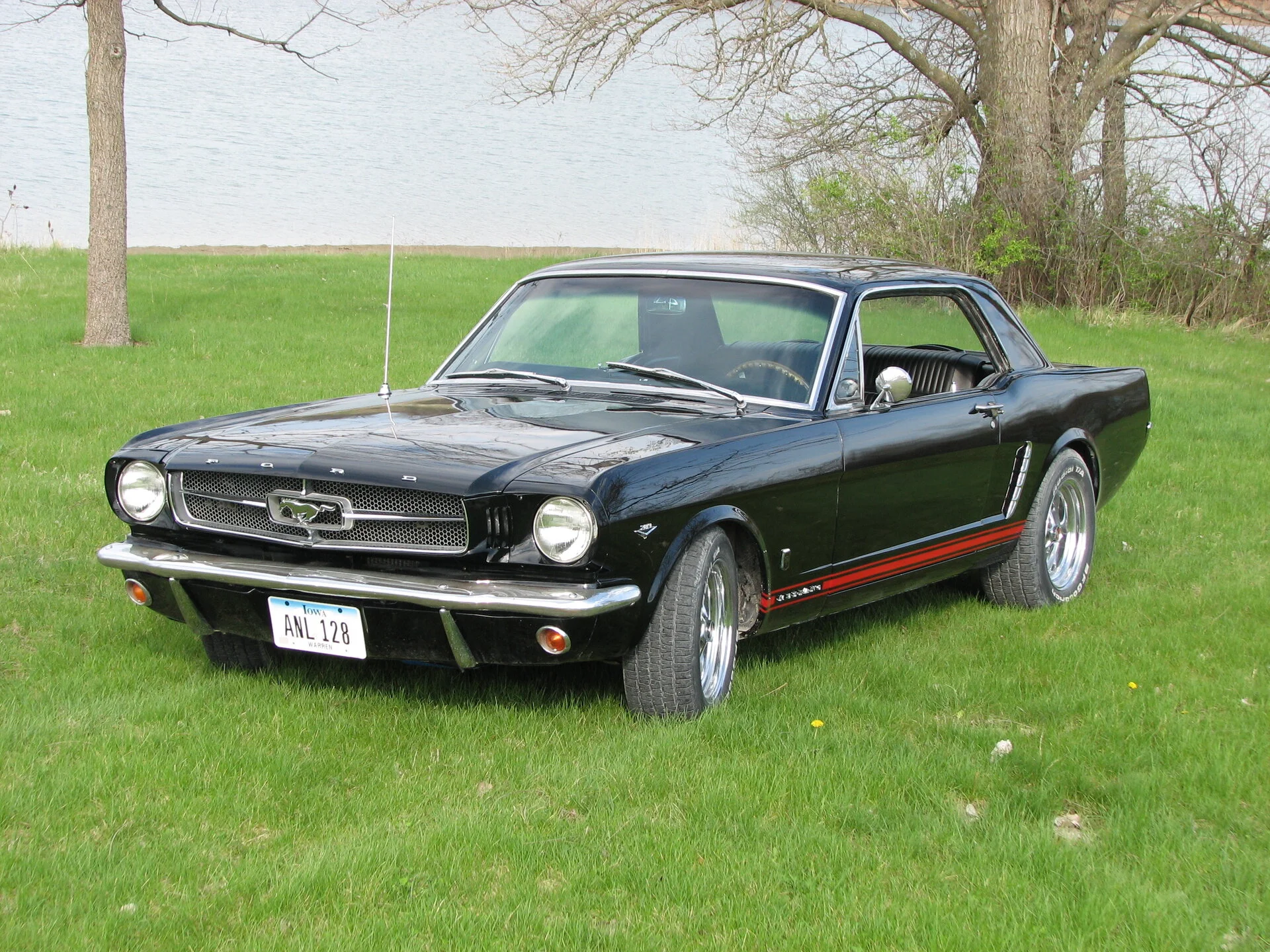

Son and i built a 1965 coupe in 2011 when he was in high school.
Has a C4 and a 302 block from a 69. I just bought a T5 from 1994 Mustang GT hoping to put in this car.
Will be researching and needing some parts to convert to the manual tranny. And lots of questions like...
