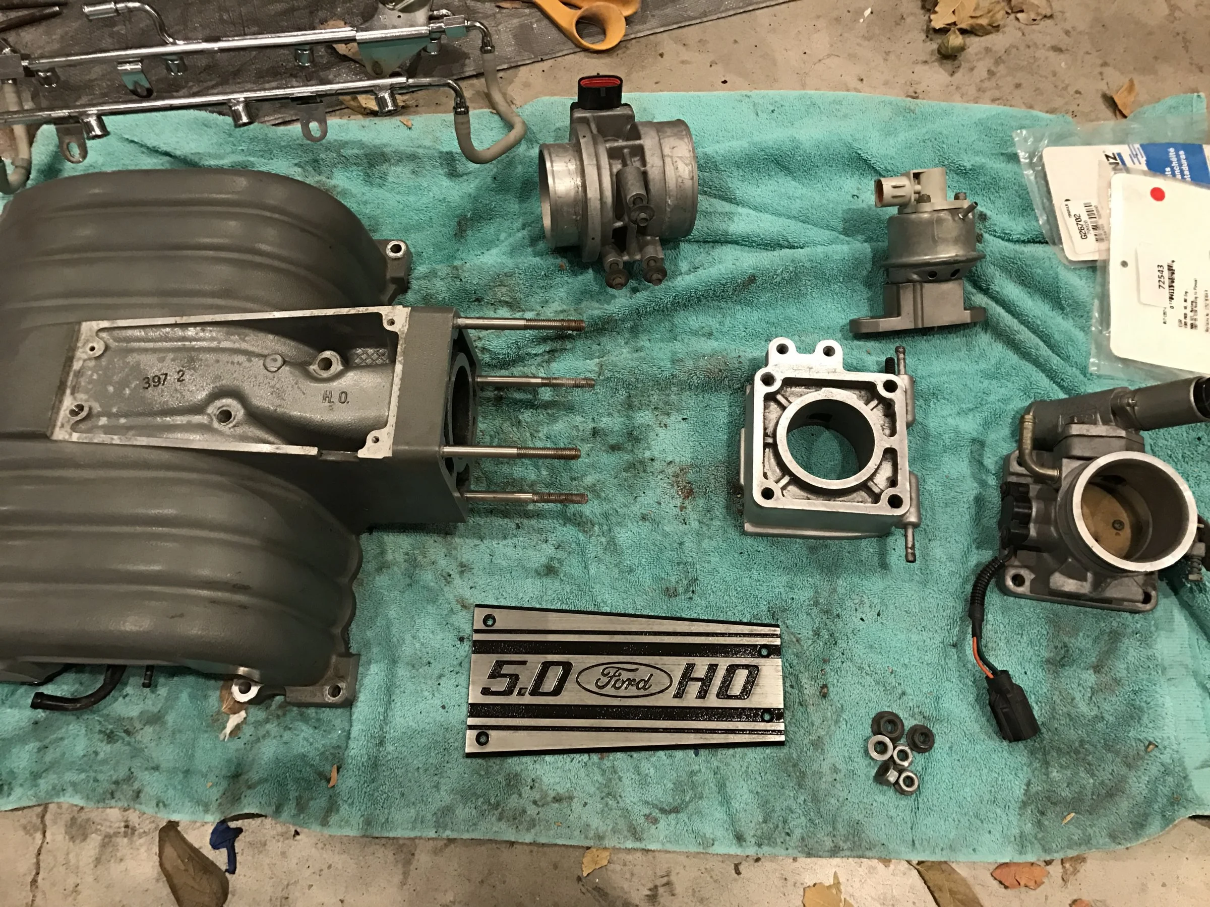

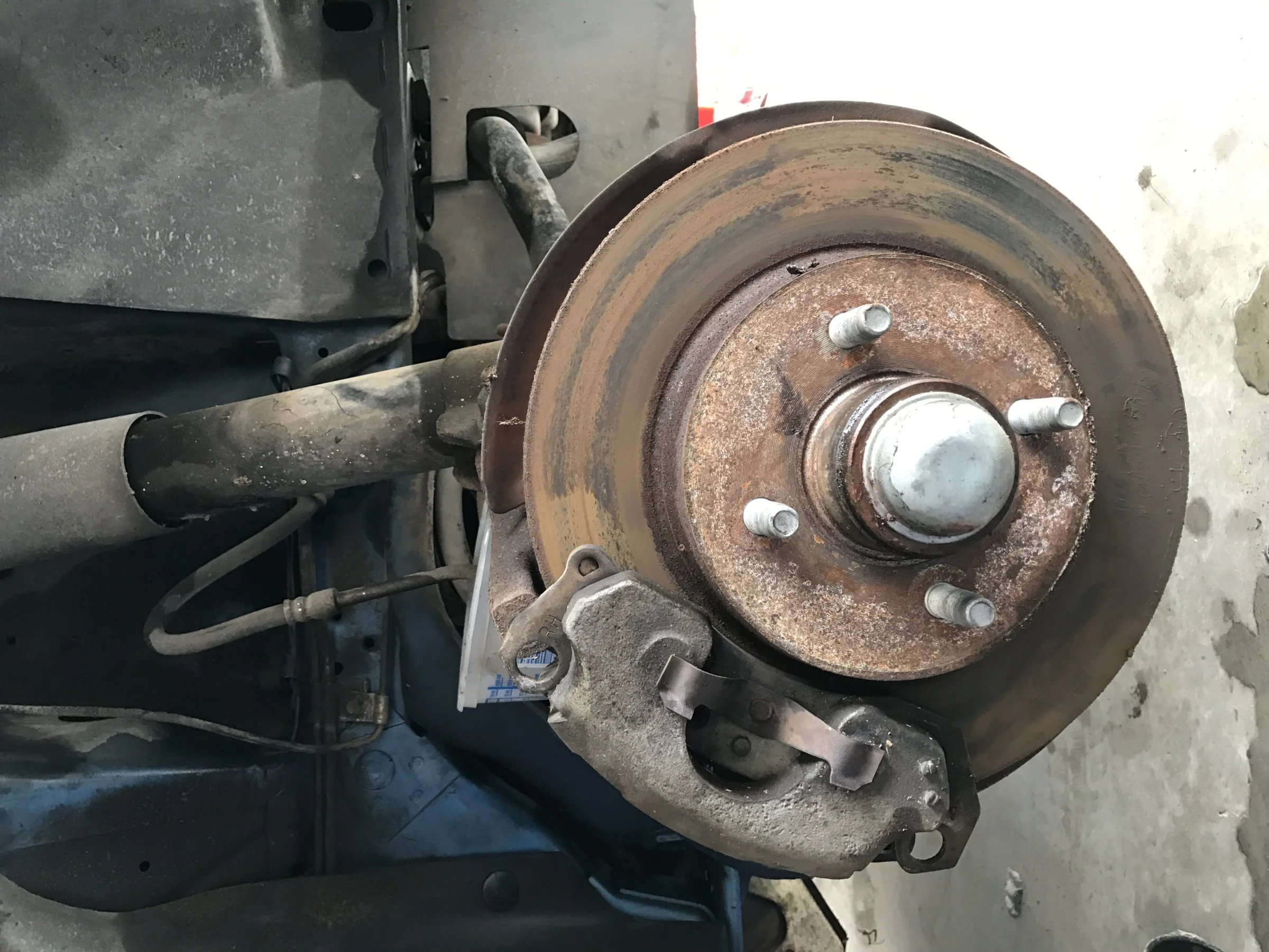

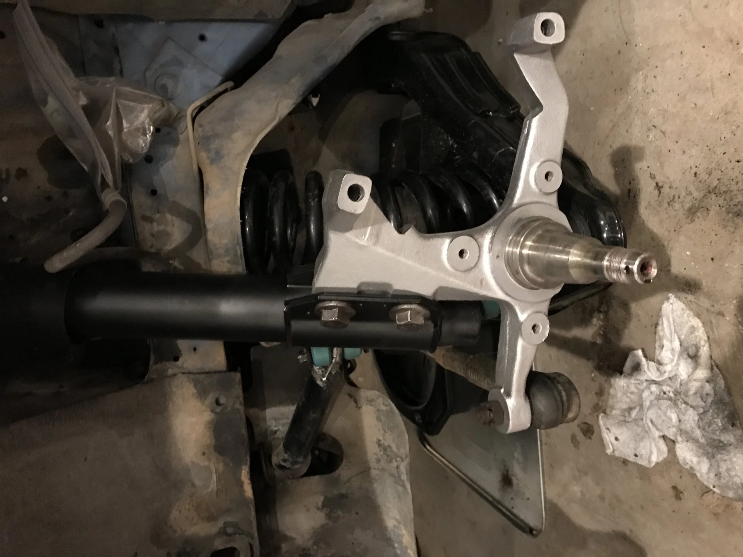

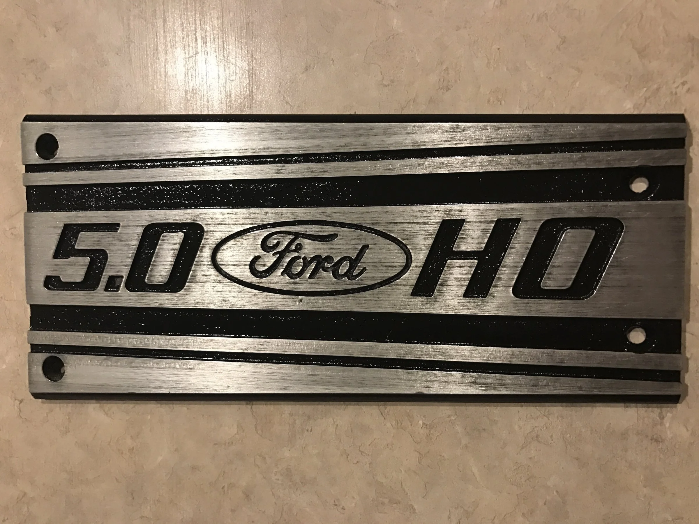

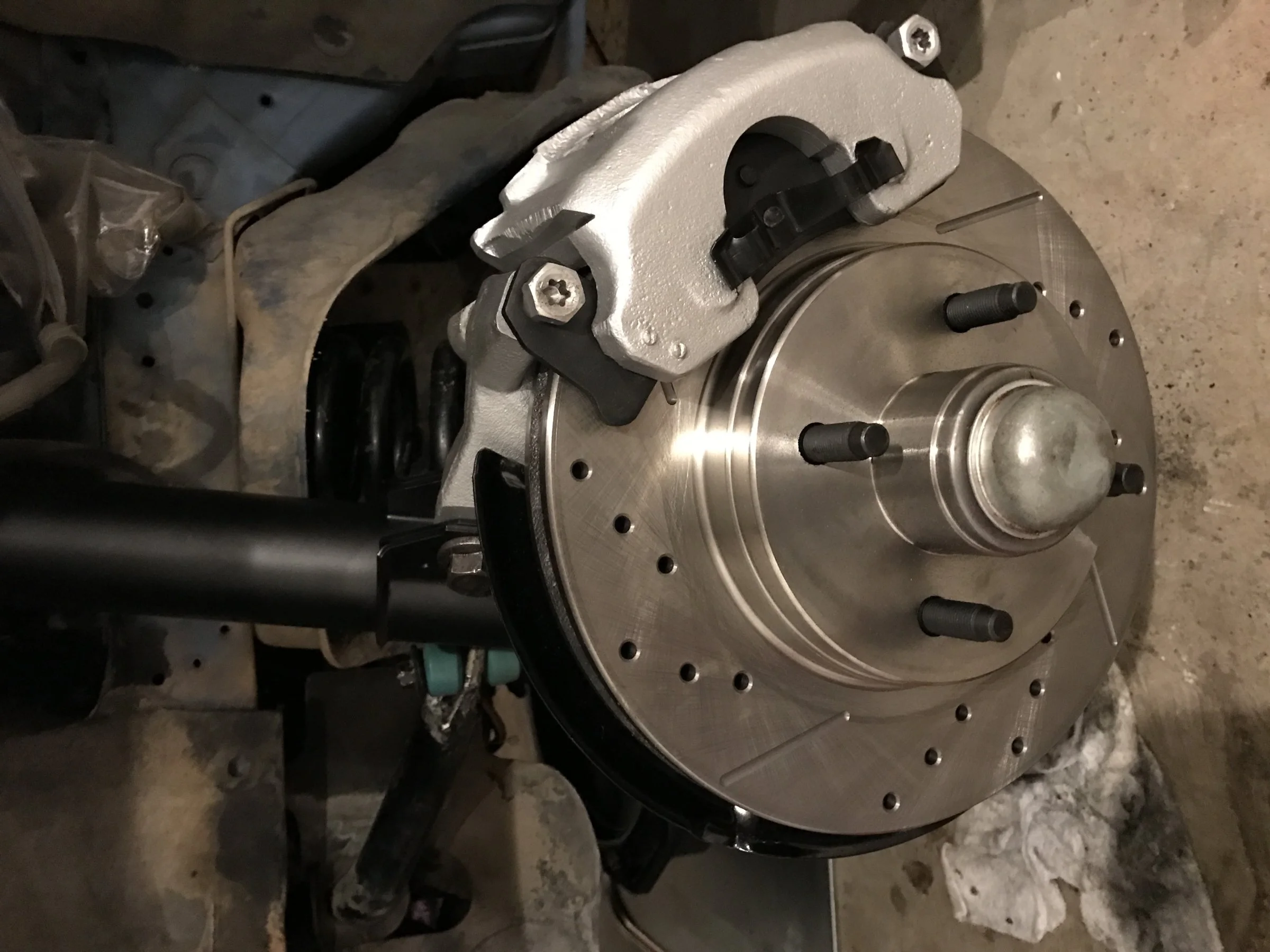

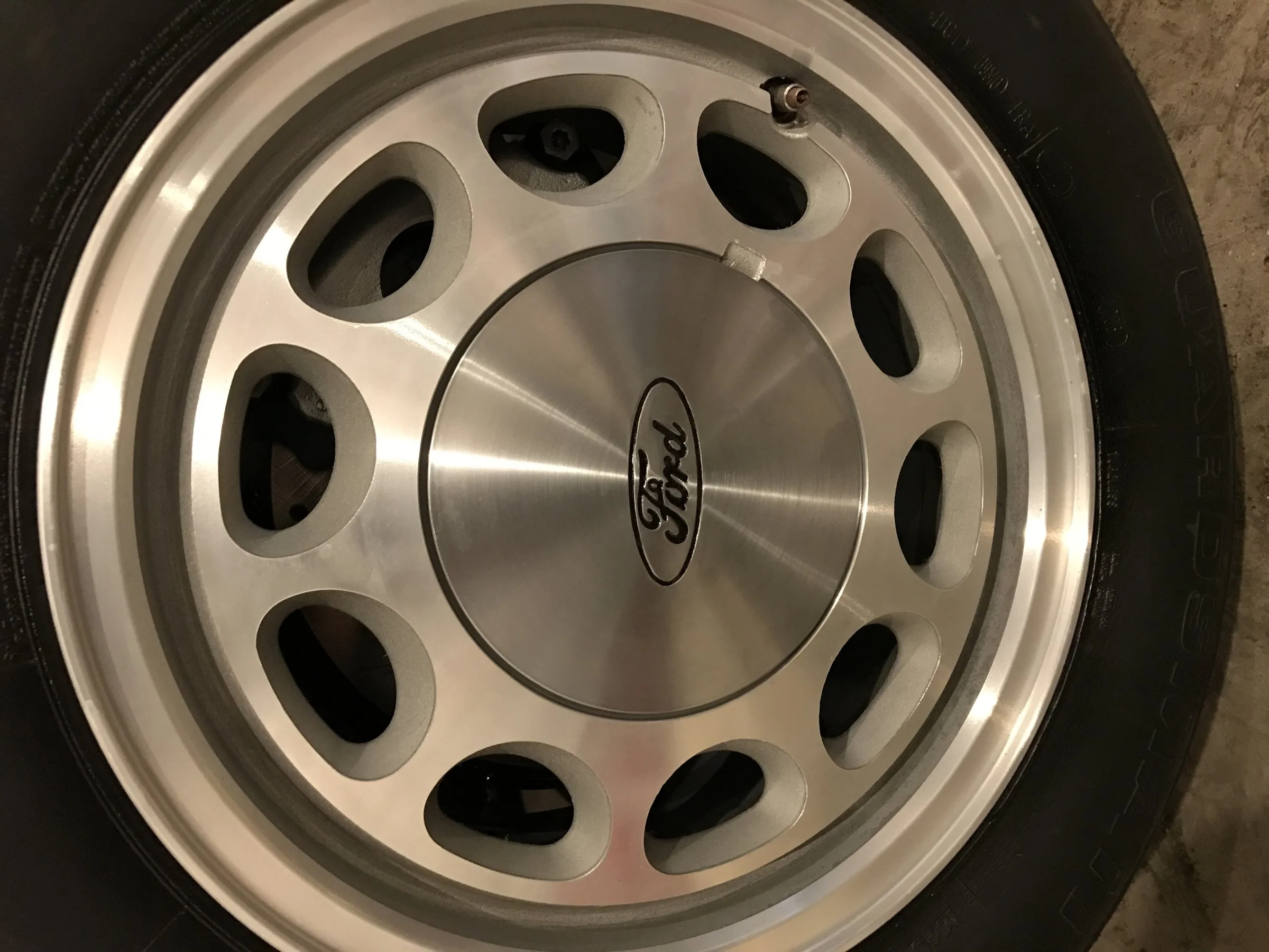

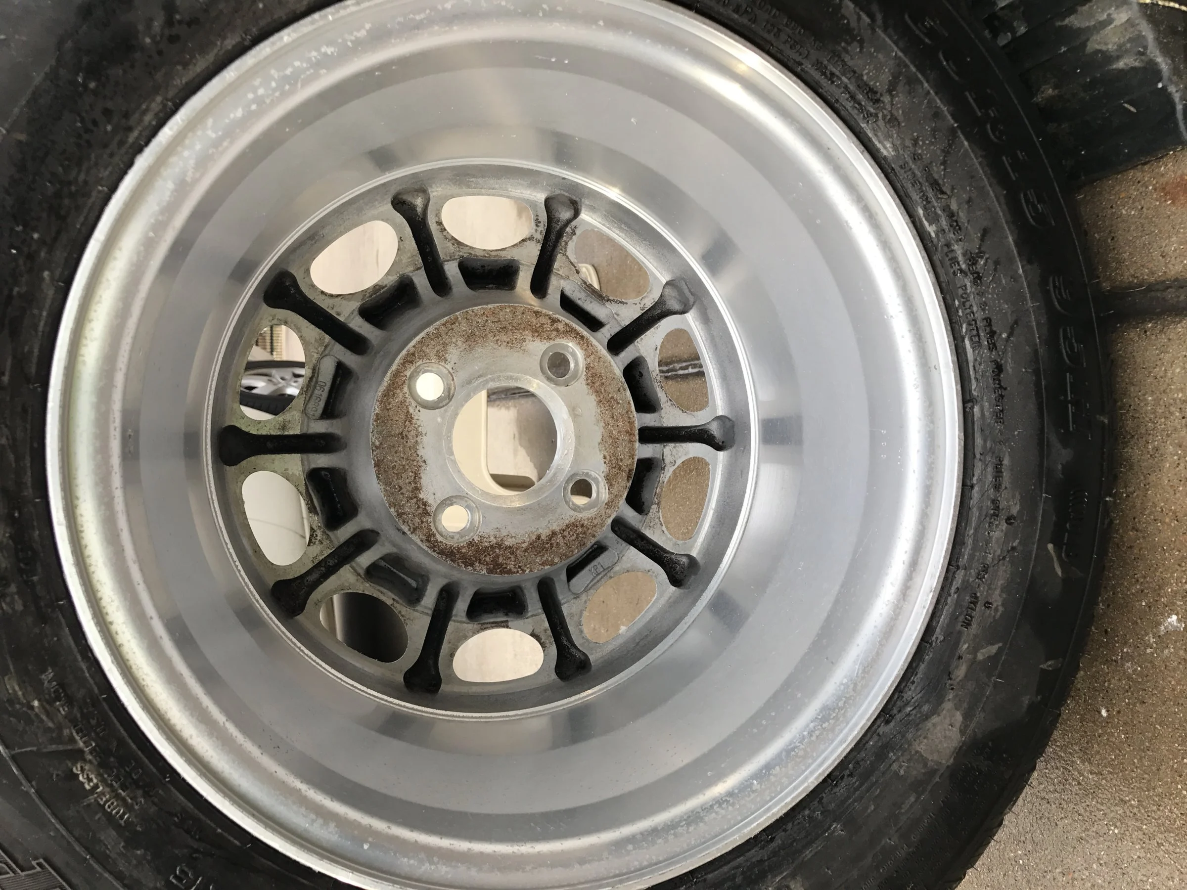

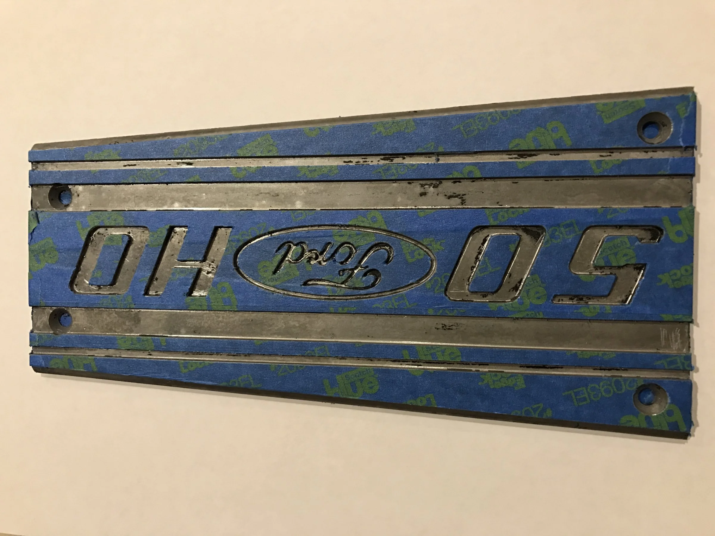

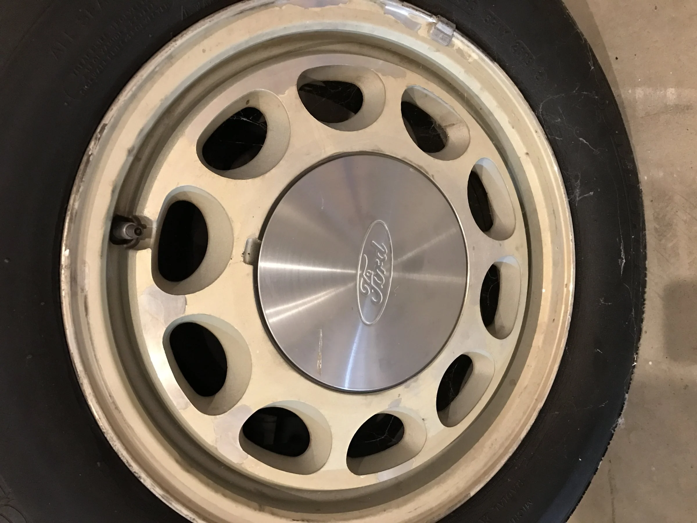

Some of the recent before and after... So far just spark plugs, injectors, injector rail, throttle body rebuild (gasket was leaking coolant into the intake), PCV, Vacuum hoses, ball joints, bearings, brakes, struts, coil mount bushings, and ignition switch. (bead blasting or stripping and refinishing as I go) Note the TBI studs, those were especially hard to find, the old ones were almost rusted through.

Good job brother!:nice: It all looks real nice.

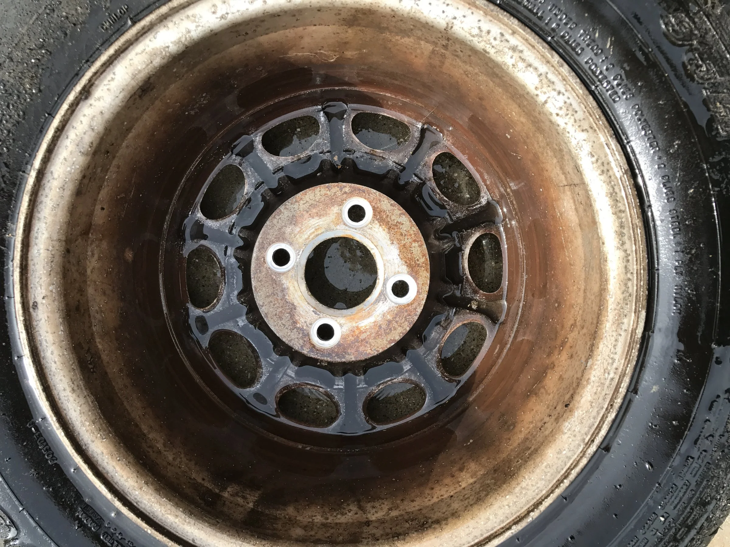

Wow. What product did you use for those wheels?
I'm a sucker for clean backsides of rims.
A lot of the crud was embedded into the original clear coat or lacquer coat from factory... And you can see how ugly the front side with the yellow chipping lacquer was. I tried just cleaning them with no luck... So tried a few different products in a inconspicuous area... The best was Duplicolor Automotive paint stripper ST-1000 or something (others also worked, but some evaporated too quickly requiring multiple applications to achieve the same, plus the duplicolor was half the price of the others that didn't work as well) Once stripped, I used Eagle one etching mag wheel cleaner. An application only takes 30-60 seconds. Both products are pretty nasty on the skin. Where gloves and eye protection. Then VHT wheel clear coat spray.
