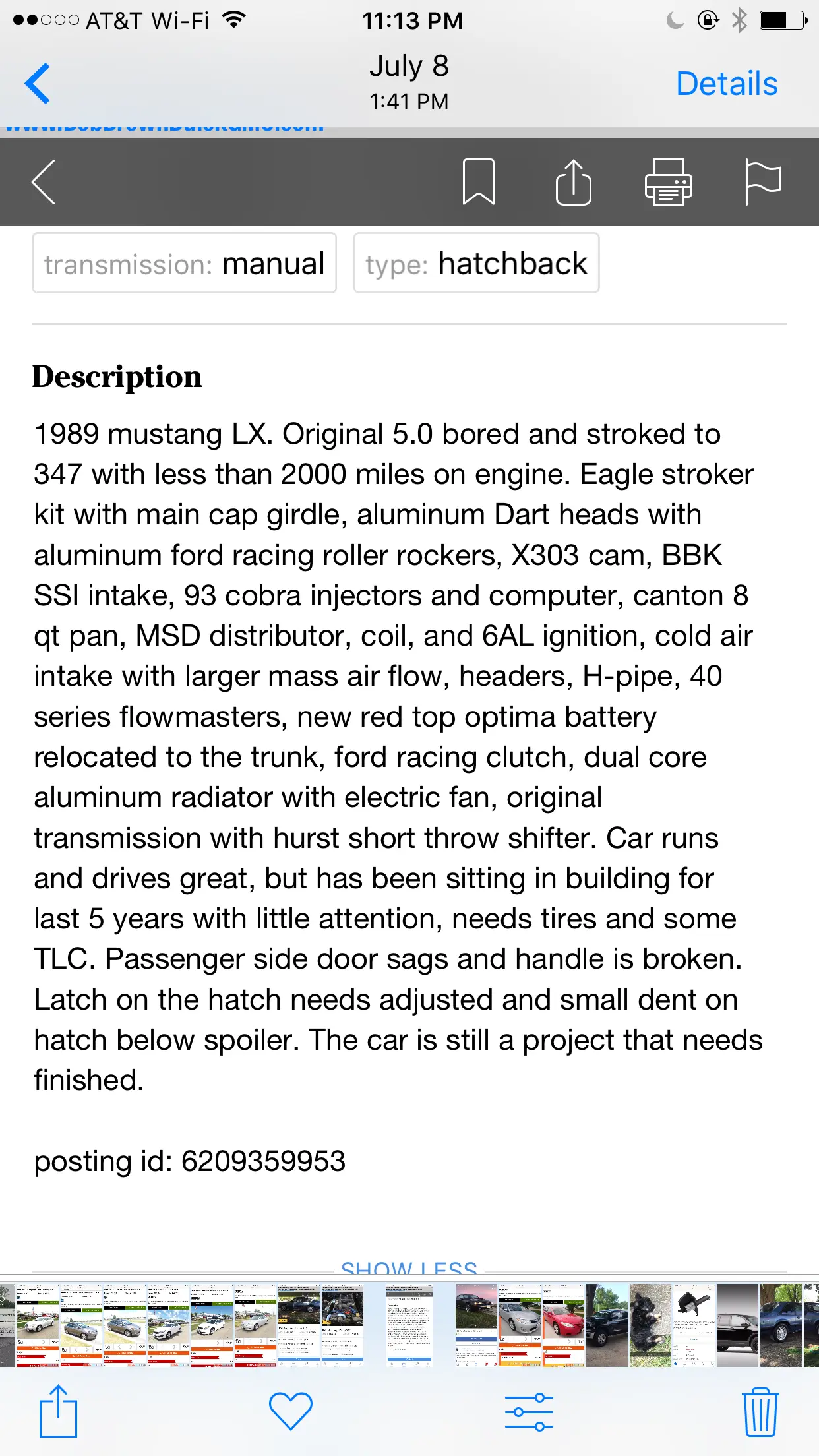

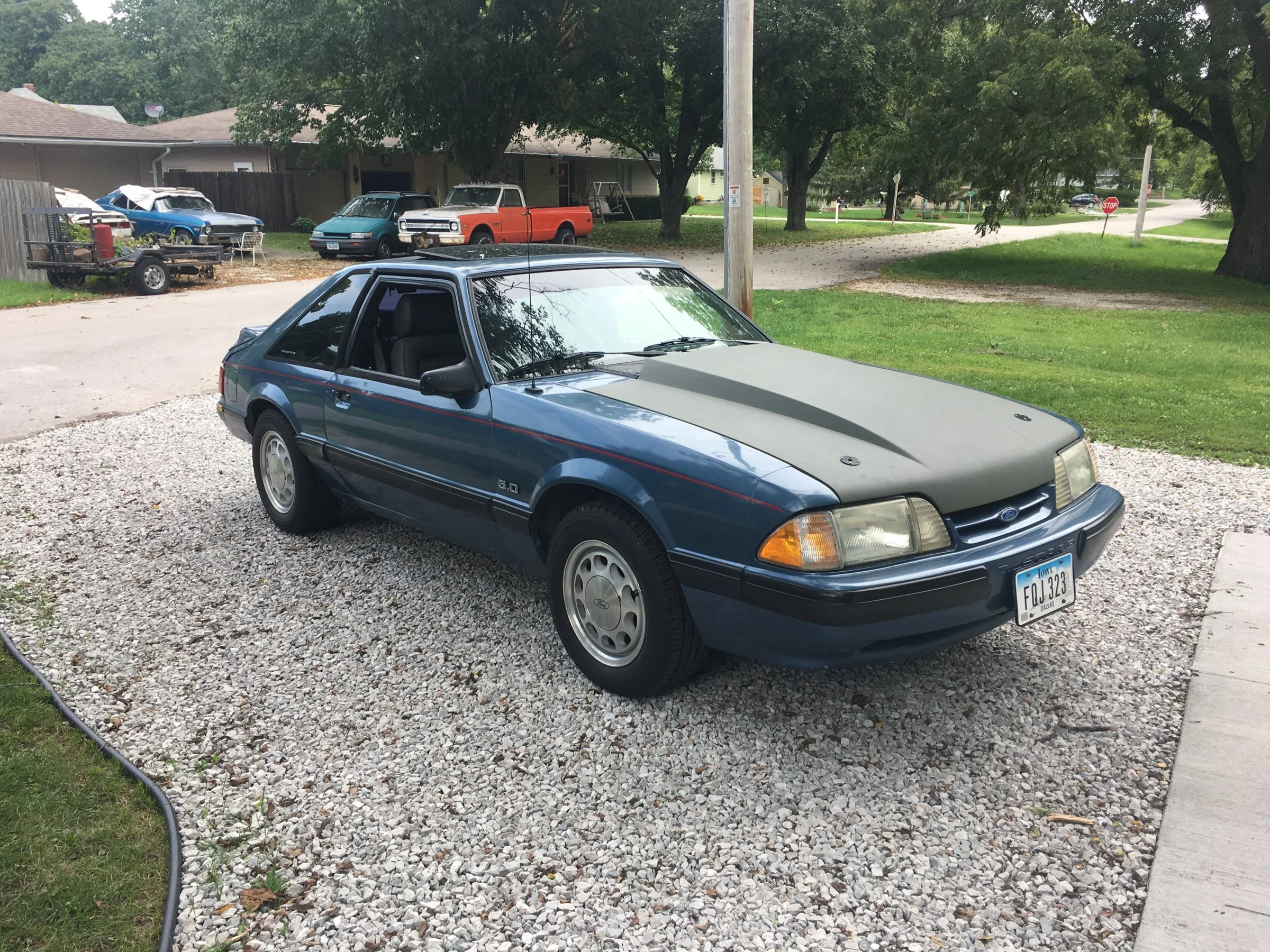

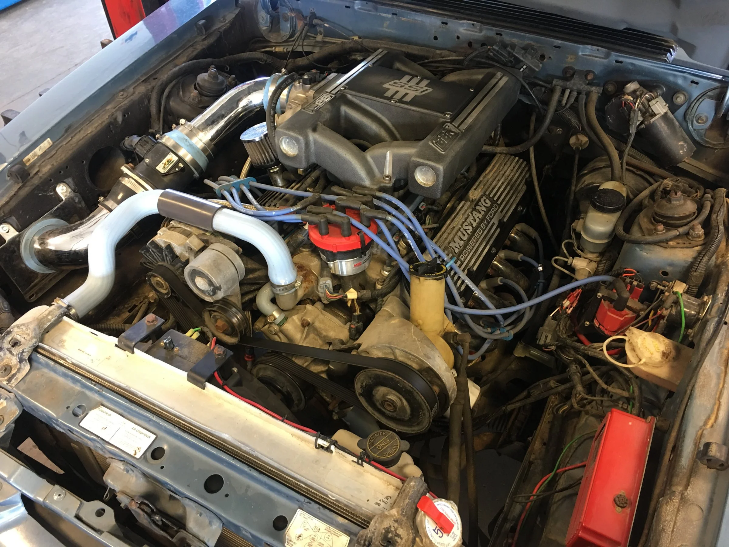

Hey all! I recently bought an 89 Lx 347 stroker car that my buddy built 10 years ago. I've had my eye on the car for years and finally got it for 4K but the issue is after he built it the car seems to intermittently smoke/burn oil and has a rattle/tap noise from the top end and he literally was so frustrated that he never even tried to break it in and parked it. I've attached a mod list and I'm considering buying a stock low mileage 302 and just swapping all of the aftermarket parts to it but I'm wondering if the x303 cam and dart heads will work on a stock 302 as far as valve clearance? Any help would be great!!!

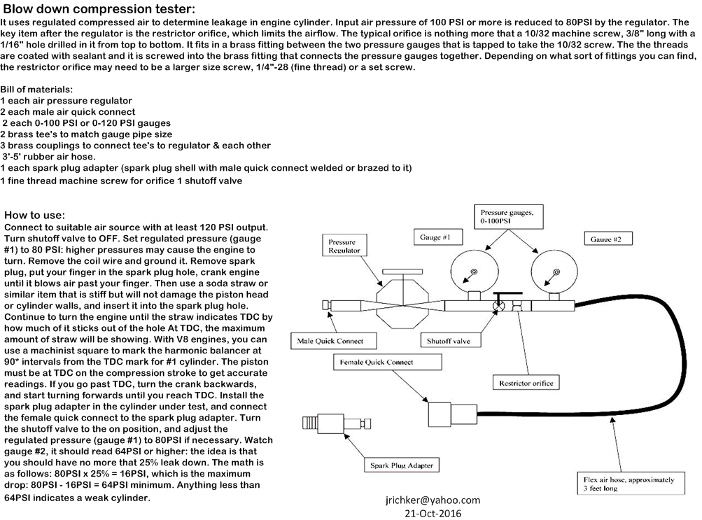

Only use a compression tester with a screw in adapter for the spark plug hole. The other type leaks too much to get an accurate reading. Your local auto parts store may have a compression tester to rent. If you do mechanic work on your own car on a regular basis, it would be a good tool to add to your collection.
With the engine warmed up, remove all spark plugs and prop the throttle wide open with a plastic screwdriver handle between the throttle butterfly and the throttle housing. Crank the engine until it the gage reading stops increasing. On a cold engine, it will be hard to tell what's good & what's not. Some of the recent posts have numbers ranging from 140-170 PSI. If the compression is low, squirt some oil in the cylinder and do it again – if it comes up, the rings are worn. There should be no more than 10% difference between cylinders. Use a blow down leak test (puts compressed air inside cylinders) on cylinders that have more than 10% difference.
I generally use a big screwdriver handle stuck in the TB between the butterfly and the TB to prop the throttle open. The plastic is soft enough that it won't damage anything and won't get sucked down the intake either.
A battery charger (not the trickle type) is a good thing to have if you haven't driven the car lately or if you have any doubts about the battery's health. Connect it up while you are cranking the engine and it will help keep the starter cranking at a consistent speed from the first cylinder tested to the last cylinder.

A blow down test as I described will give more accurate results on the state of the sealing of the rings. See my post above on how to build your own blow down tester.

If the meter and injectors are on the car now we can help further with closeup pics of the items, we need part numbers to get the relevant specs on them.
