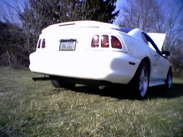

BEST ON MOTOR -13.89, 98 MPH 60FT.1.95 radials!!!
with NOS - 13.16,108MPH 60FT.2.12 radials!!!
SPINNING LIKE HELL!!!!!!
94 white cobra 390 rear gears,1 5/8" equal length BBK Headers, BBK Offroad H-Pipe, American Thunder catback exhaust, Pro 5.0 Shifter, NOS dry system (125hp jets in), 13 degrees timing advance, straight cam 2
Future Mods:
Edelbrock performer rpm ported heads, F303 cam, 70 mm t-body, 77 mm Mass Air, underdrives, Energy Suspension motor and tranny mounts, 26/11 1/2" MT Street Ets

17/10''cobra R wheels
Faulkner p275/40/17
I have a set of MT street et . There from my old car 89 gt there on a 15/10'' weld do you know if they will fit our cars? What size nitto's do you have ?
