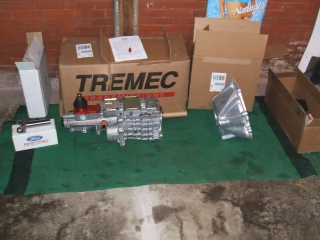

i payed 2300 brand new for my tko600, bellhousing, clutch and 31 spline yoke shipped to my door from d and d performance. I dont think thats bad at all imo. That was 2 years ago. I got the .64 ovrdrive. if you car is a track car go with the .82. the trans fits any year. it is the bellhousing that you have to get specific. you cant use a t5 bellhousing and clutch. your better off buying new as a whole package deal like i did, or buy one off someone else.
