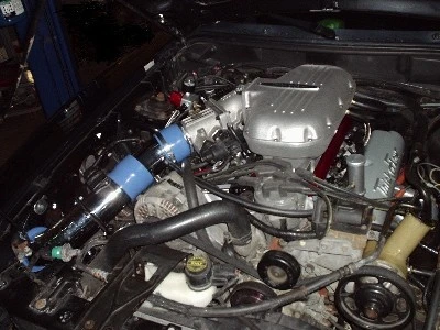

Box stock TW (TFS-51400004), TF stage 1 cam, R-lower, New 3-piece upper, TF SN 95 inlet adapter, bbk 70mm, stock 94 block assembly.
Requires after-market fuel rails. I've got the aeromotive kit.

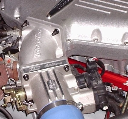

How did you mount the elbow on the upper? I couldn't see any way to bolt the front lower bolt on.

The stock regulator hits the casting. The manifold was designed for billet rails. Adapter elbow goes on with nuts & studs, and a stubby wrench. 3" cowl, about 3/4" clearance in the front w/ stock engine mounts. corral.net has a nice spread on this.

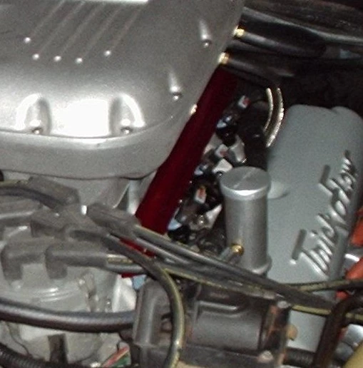

smitty, any chance you can get me a close up shot of the front of the driver's side rail? Right near the distributor. I'm wondering how close it is, cause I had an intake that I couldn't fit a normal rail in there and had to get a rail that was closed on that end. Thanks in advance!
TurboSN95 said:
i dont even see a fitting on the end of the rail... do you run stock lines/fittings? can you use a spacer between the intake and the rail to move it outwards?
Dan you could convert over to the early style disti cap(the conversion people do to run those dual tunnel ram Cartech intakes) in order to get a lot of clearance, though that conversion kit I think is more than just buying a set of Pro-M rails and those would solve the problem as well since they angle the drivers side rail for more clearance around the cap. Most intakes will not let you keep a outlet on the drivers side(some people make it work but it is very tight when they do), your Spyder intake is probably one of the few exceptions.
