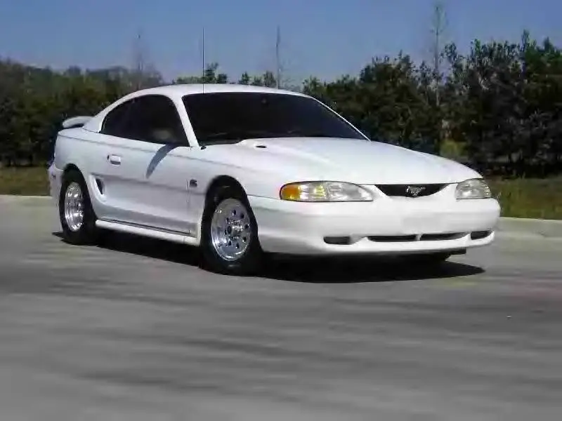

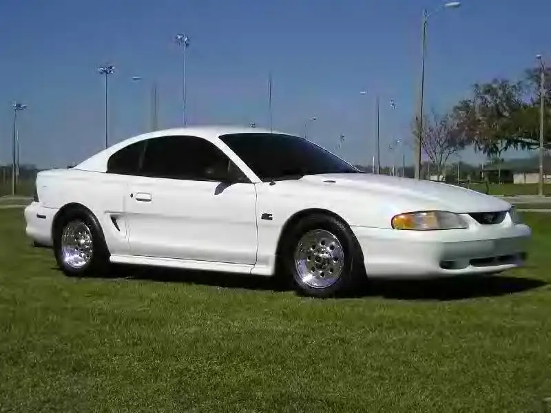

Thanks man I just got a job (starting Sun) working for Discount/Advance autoparts (parts pro/consultant). They offer Eibach springs and I now get the employee discount. So spings should be pretty cheap, tires for the front are barley $100 for two. The rear tires (BF goodrich) are about $100 each. So in a month of so I expect my car to look like this

those are awesome! i have been looking at new rims and was set on black bullitts, but those pics are making me reconsider
I love them because not every other mustang has them. Every other Ford rim was been displayed my many, at least in the sn95 family.
