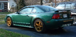

I have the H&R Supersports on my car and I love the way it rides. I was looking for a budget setup and went with OEM Mach I shocks. They are slightly revalved Tokico Premiums. It handles great, but isn't rough riding in the least bit. I suggested the C-Springs though, because I don't think you can beat the price and you don't absolutely have to have c/c plates.'
BTW, my H&Rs lowerd my car about 2.25"F/2"R. It has settled since this pic which was taken the day after installation.

Looks great. Love the wheels too. I appreciate everybody's input; it's clear that I have a lot to learn yet, but this board has a lot of knowledgeable people.
