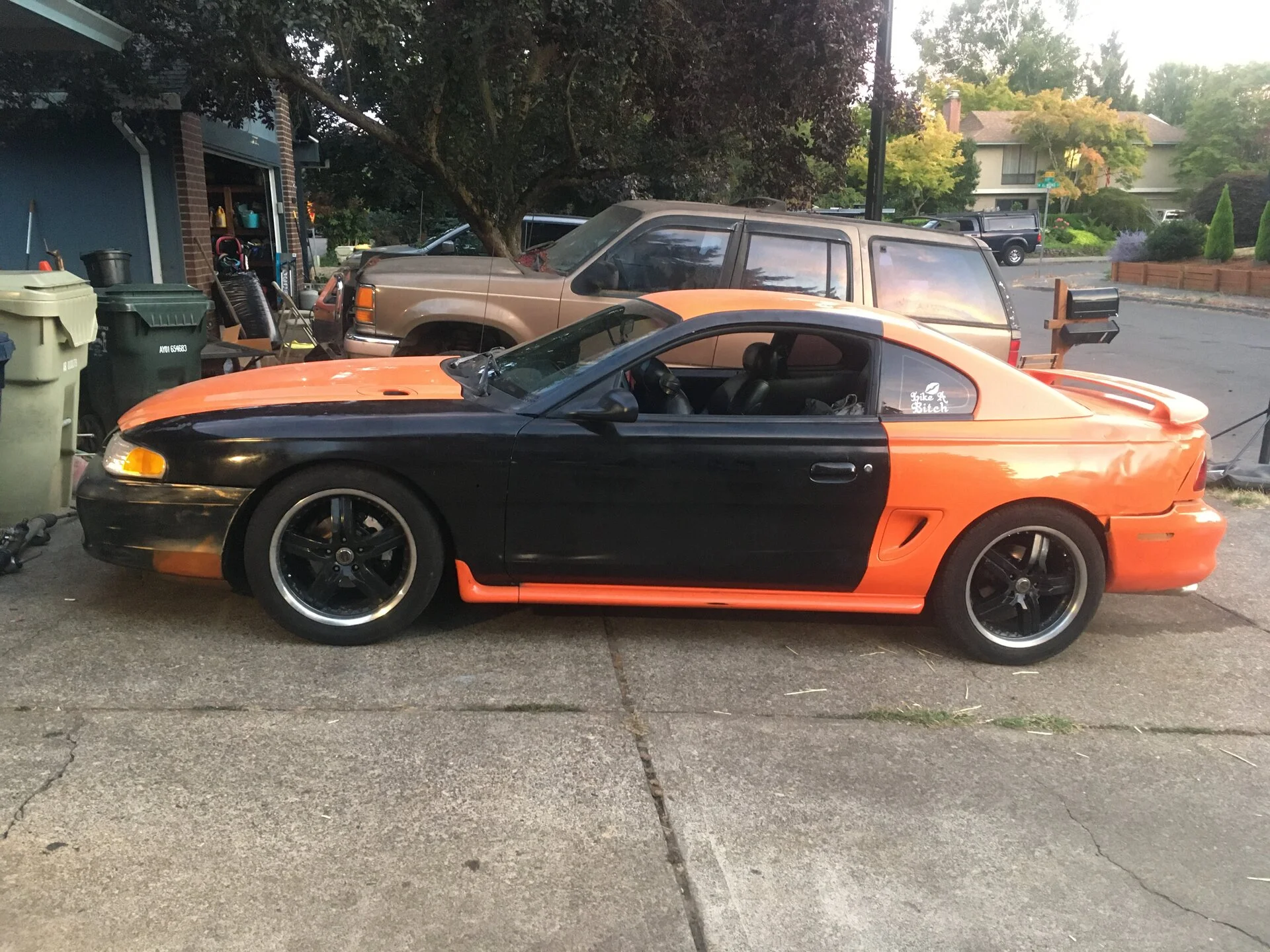

Here is me on B springs with no isolators. 275/35/18 tires on 18x9 wheel

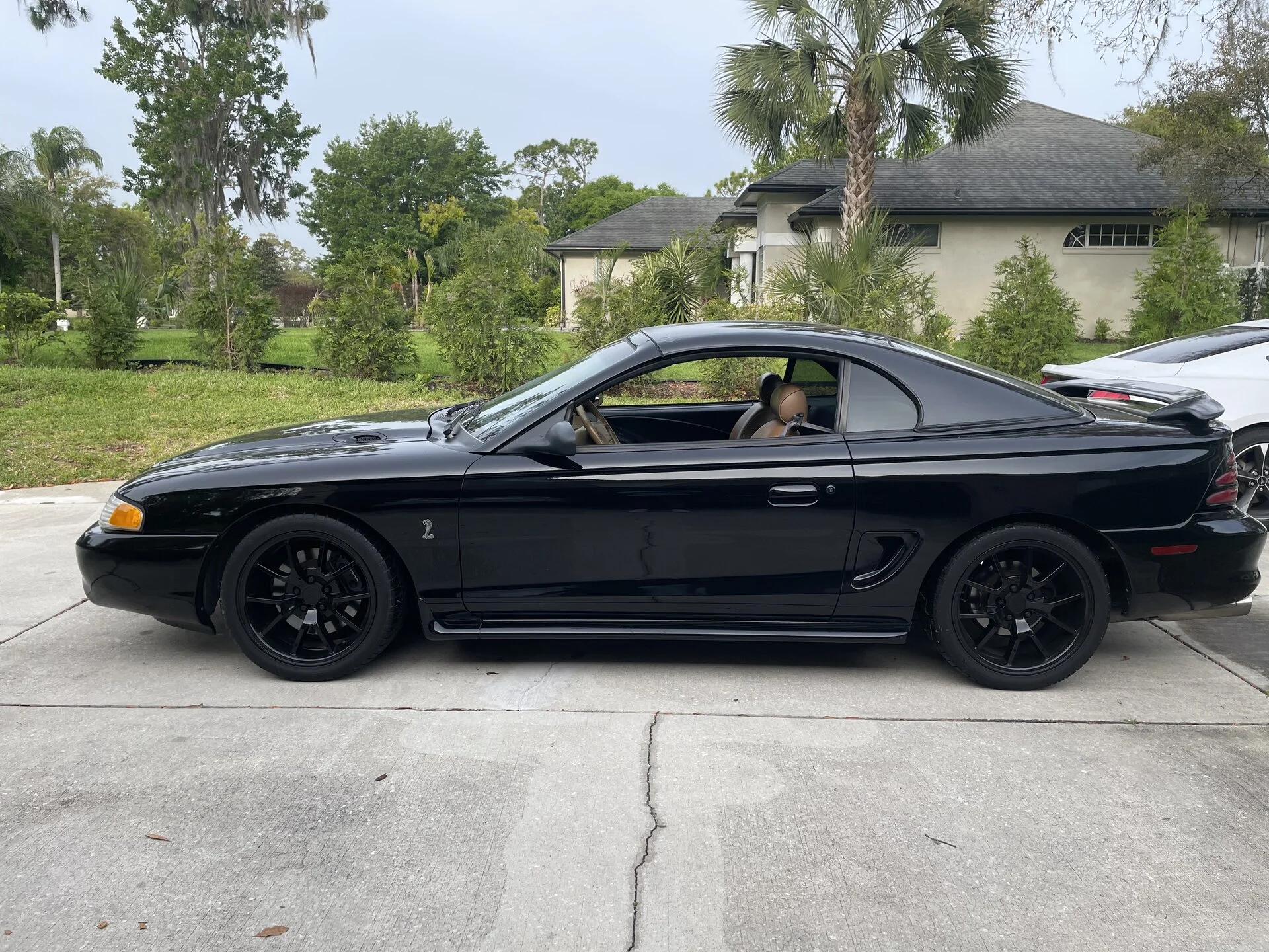

I lowered my wife’s old beater 96gt last summer with H&R springs and fox struts. I thought the stance looked good and it rode nice. I always hated the wheels though but they were 18’s.

Coilovers will get you where you need to be. To look good imo you need H&R springs with no isos which yields the biggest drop of the springs
