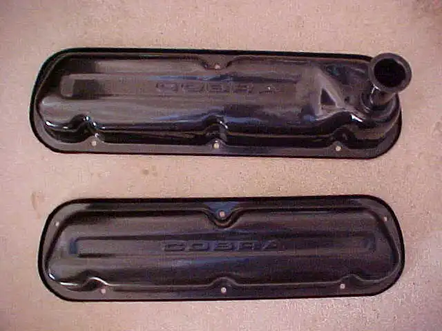

Are TFS heads higher in the rocker placement? I mean our covers (short as they are) were factory also on the 94-95 cobra's that had 1.7rr. I bought a set of fox covers they are quite tall, and with a paint or polish job look like one of the best covers on the market. I picked mine up for like 20$ used.

I read that the valve rail (or whatever it's called) is raised .375", I know 1.6's clear fine, but 1.7's are apparently pushing it.

Actually, that's not the case. The 94-95 Cobra's had different covers that are a little bit taller. They also have the word "COBRA" embossed in the center, where we just have an empty space.
I could have swore the 94-95 cobras had the same covers? . My buddy has a 94 lighting that has the same covers a 94-95 GT has and 1.7rr on it (351w with gt40 heads), or did as I bought his when he got his AFR185's and new rockers.
