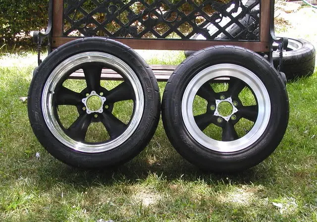

Well, I finally decided to move up to 17" wheels. I really like the American Racing Torq-Thrust D's that I have,
but wanted to fit larger brakes.
I went with the American Racing CL-205's - http://www.wheelsforless.com/search_result.asp?Product_ID=2057800
I got the 17" X 8" with 4.75" backspacing.

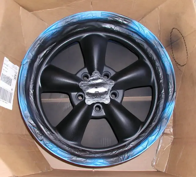

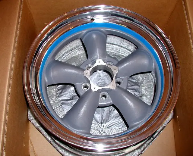

It took over 12 weeks to get them and when they showed up they were a little too grey for my liking,
so I taped them off and sprayed the spokes satin black.
I, also, got Falken Azenis RT-615's - 225/45/17 front and 245/45/17 rear.
http://www.falkentire.com/main.htm
I've got the tires mounted and balanced and have test fit them on my car, but I have a little bit of a rubbing issue,
do to the amount of + Caster I run.
I'm going to grind a little of the fender lip and hopefully get them installed and shoot some pictures.
Tim

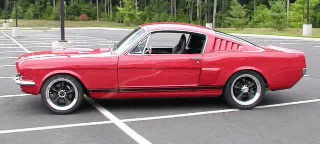

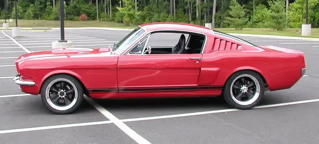

The new 17" X 8" CL-205's with 225/45/17's next to the old 15" X 7" Torq-Thrust D's with 225/50/15's

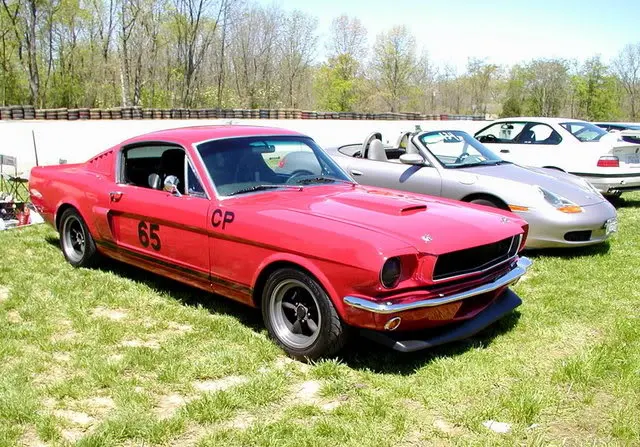

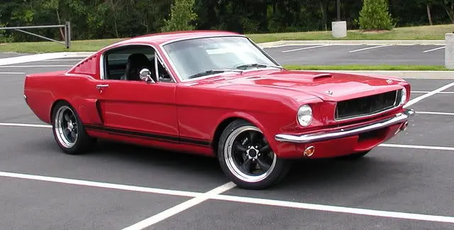

.....Funny, right before I wrote this, you posted more pictures up......I was going to ask you to do that =) This helps me better illustrate my tire slip angle theory I was throwing out there. It looks as though you haven't really dropped the front end of the car. IF you decide to, the tires will naturally be tucked up past the fenders, then you'll see what I'm talking about with the possbilities of tire rub during extreme cornering.
I dropped the front of mine 2" and have some good camber going. So no matter what I do, the combination of camber and fender lip rolling will never let me rubber the tire to the fender........other than that........your lookN good
Nice car 65 Fastback, I can see how the original color of the wheels would have not looked right. The satin black centers nicely match your car and it looks much better with the 17's.
Thanks 4Muscle Machines
Hot Dam, that things looking real sexy now....nice choice and paint on the wheels. Car looks pretty waxed up and clean to me...
Thanks ga289stroker

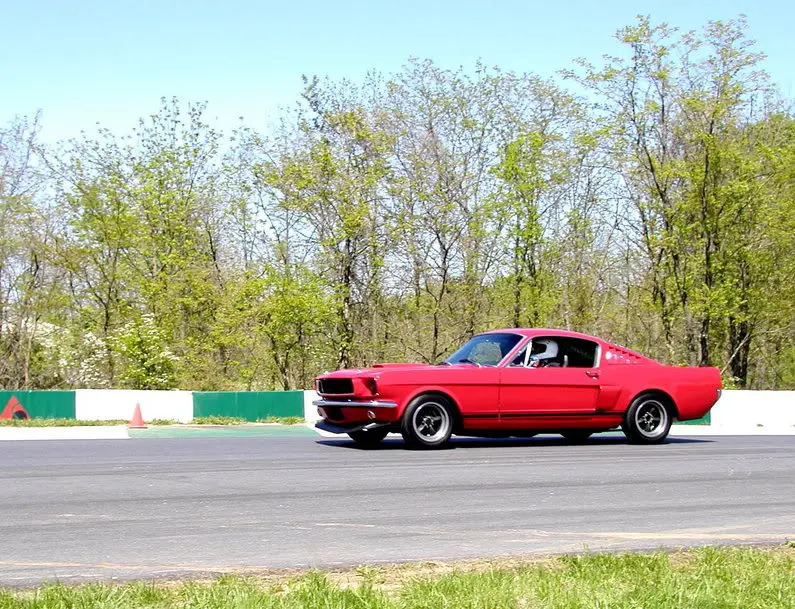

Now that I have the wheels/tires mounted and have checked the clearance and run an autocross; I could definately go one size bigger out back. I'm sure that I have enough room for a 255/45/17 tire out back, but the front is maxed out at 225/45/17.

I think I have the inner and outer clearances to go up to at least a 235/40 in front, but my problem is the front of the wheel well opening. When I first installed these 225/45/17's I had rubbing in lower front. I rolled them up slightly, but it is still very close. If you look at this picture, you can see how tight it is in the front and turning these fat tires closes that gap. I really don't want to give up any caster, but if I go bigger I may have to.
