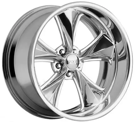

Well I ordered the wheels for my 67 coupe finnaly. Aftr much debate I Decided on the Foose Nitrous II in a staggerd 17-9 17-7 combo. The local tire shop is going to try some different tire combo for me but I really want to use 275 for the rear and a 215 for the front. The car has a 9" with drums and disc front with stock spindles. it has 620 in the front and Grab-a track 5 leaf mids in the rear. Here is a pic.
Anyone have these on an older stang feel free to share pics

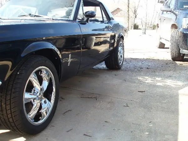

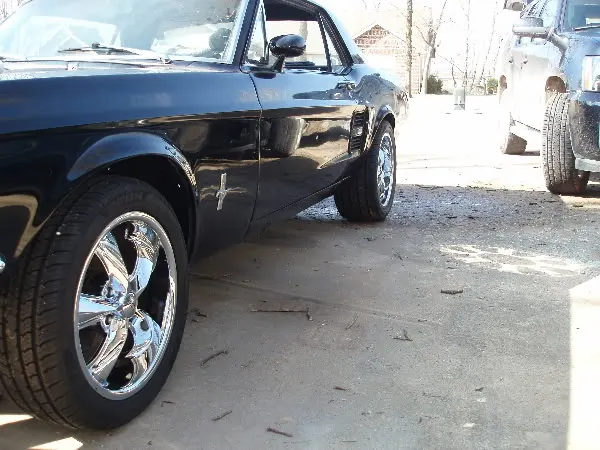

Wheels where in today. These things are REALLY nice. The Polish goes from lip to lip even behind the spokes. I did not get to test fit them yet but will first thing Monday Morning. Will post pics then.
Update

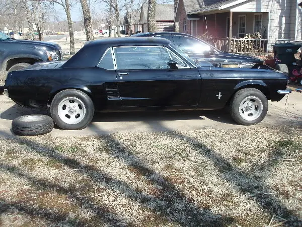

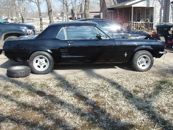

This is what she looked like before the wheels

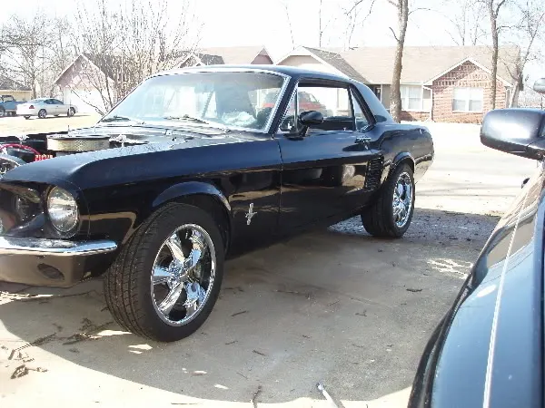

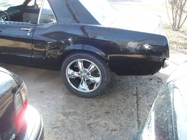

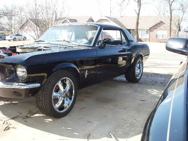

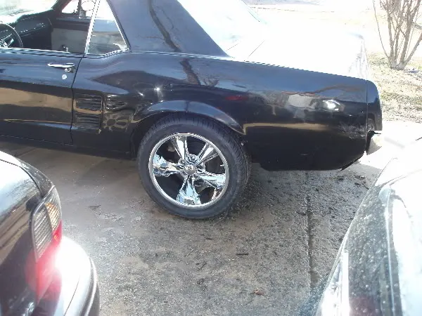

After

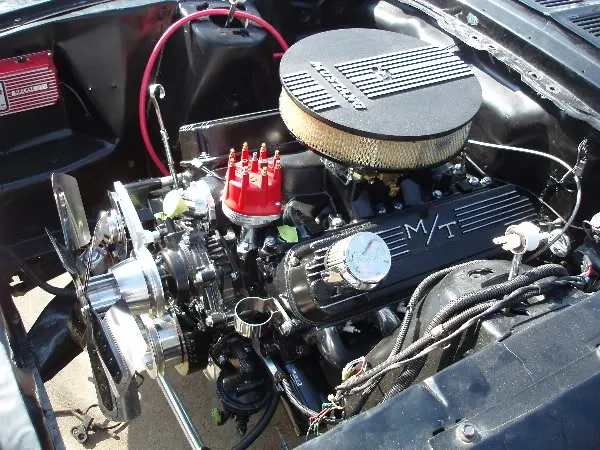

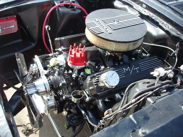

And just a shot of the engine. Still a lot of work to do but we are getting there. Pardon the dust:)
It has 620's and mid eyes after getting these on there I should have even did more. I guess I will look for that template to do the shelby drop and still may have to cut the 620's and not sure on the rear. I sorta like the higher in the front look like they had when they came out but not sure about it with these wheels?????
I had the 2" front drop and a 1" rear drop on mine. Put 17X8s with 245/45s on it and she looked like a 4X4! You have to remember what a big jump it is going from 14" to 17", and the low profile tires don't (can't) compress as much as a set of F-70/14s...LOL.
I do agree that these cars came from the factory sorta high, and don't personally care for the slammed look either. But they could use a little lowering too.
EDIT: Those wheels look great though! I'm starting to get used to the flush-to-the-outside look of modern rims on the classics, it used to bug me but not anymore.
Thanks guys
Edbert I don't like the flush mounts either these pics make it look like these are but actually the spokes are back about 2 inches or so from the lip. In real life they have a smoothe lip that gives that deep dish apperence.
Lowering? Are blocks ok for the rear? Can the 620 be safely cut or do you think the Shelby drop will be enough? What would be another Spring that could be bought for the front?
Harndog, keep in mind your car is not completely together. The coolant, radiator and hood are still off. This will add a little weight to the front end, thus dropping it down a little more than it is now. My advice would be to complete your engine rebuild and drive the car around for a few miles to get the suspension settled and then go about lowering the car.
BTW, nice rims:nice:
Blocks are okay as long as they're an inch or less. Relocating the upper control arm one inch will only lower your car 1/2 inch. Cutting springs always freaked me out, I'm too chicken, but many folks have done so without problems, even the 620s (which are probably safer than the 480s since they don't compress as much to begin with).
When I lowered my car the springs were rated for the drop I requested. For all I know the coils were cut by the manufacturer. Leafs can be recurved too.
