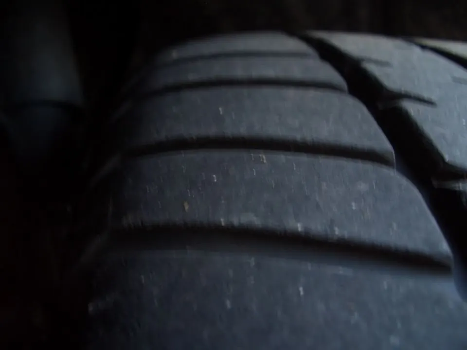

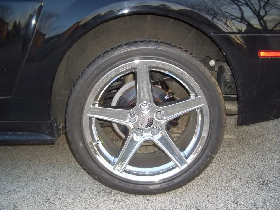

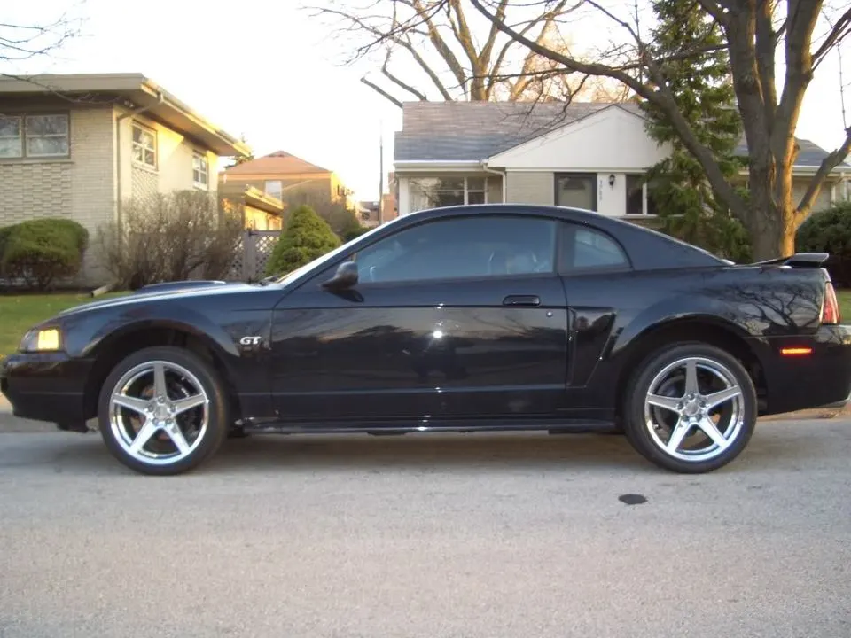

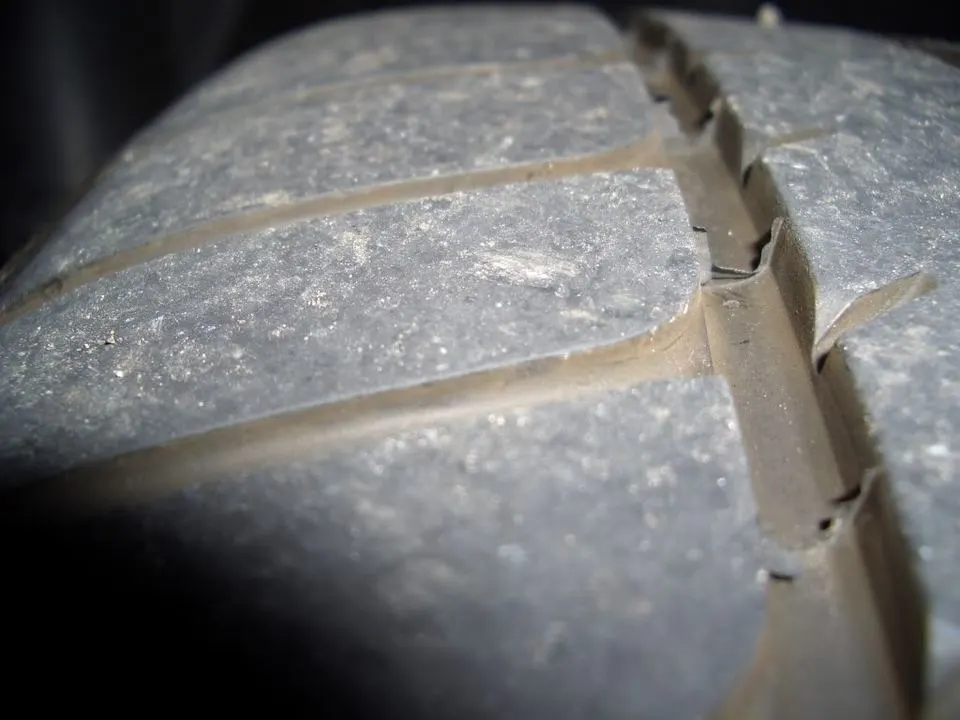

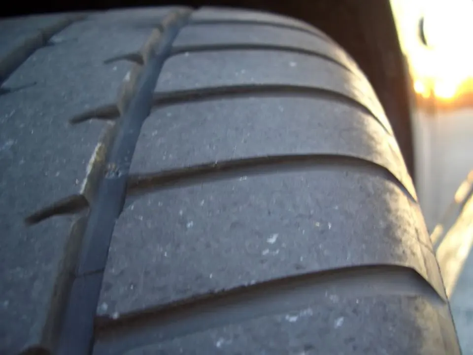

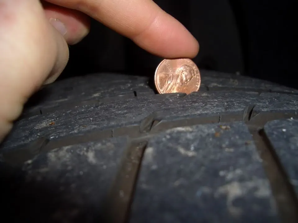

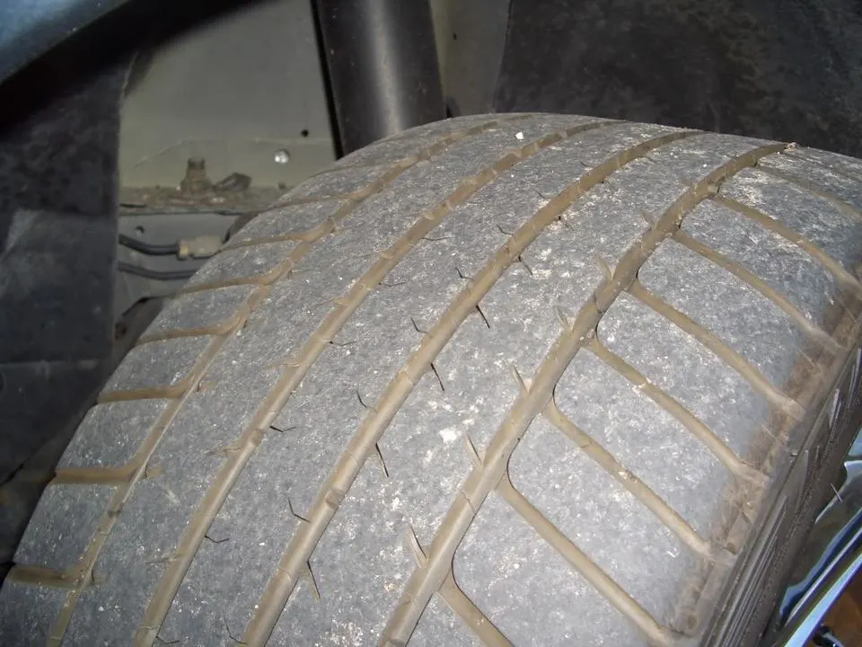

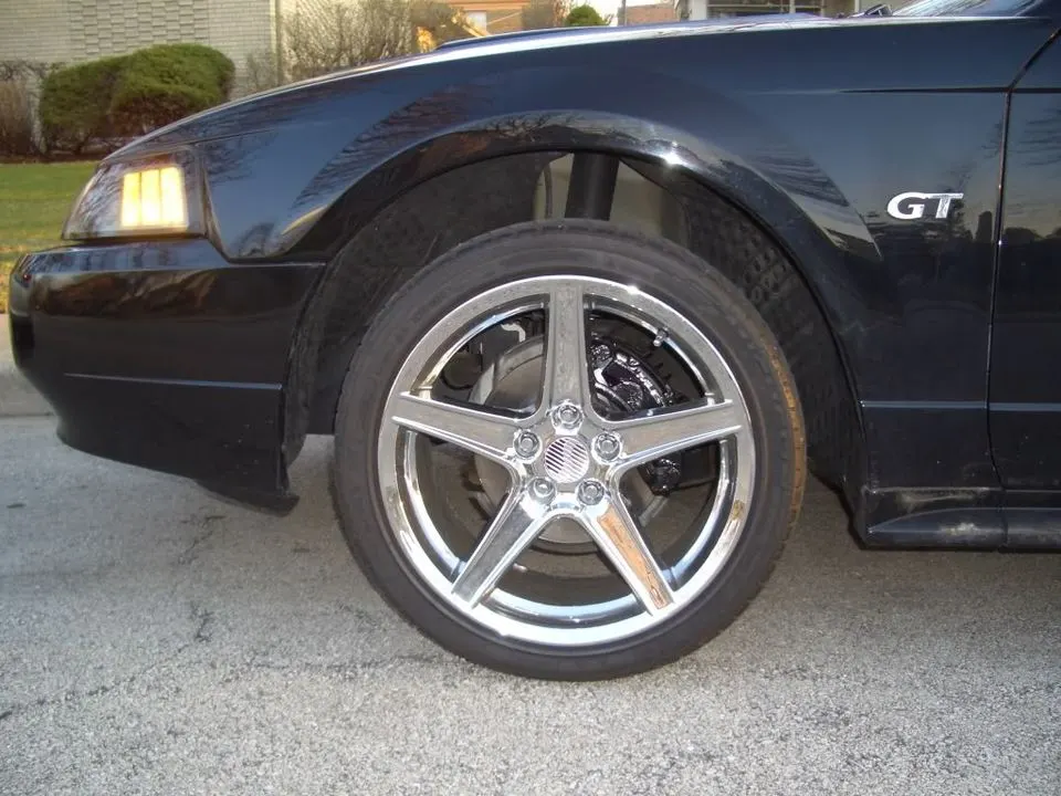

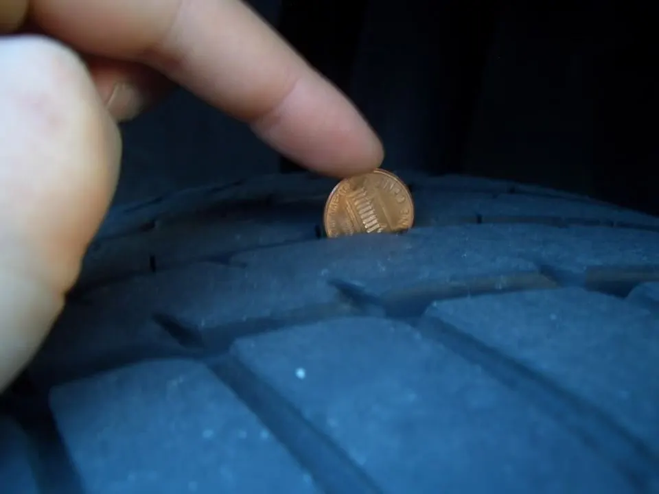

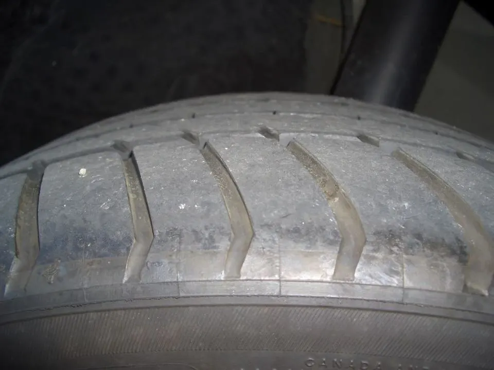

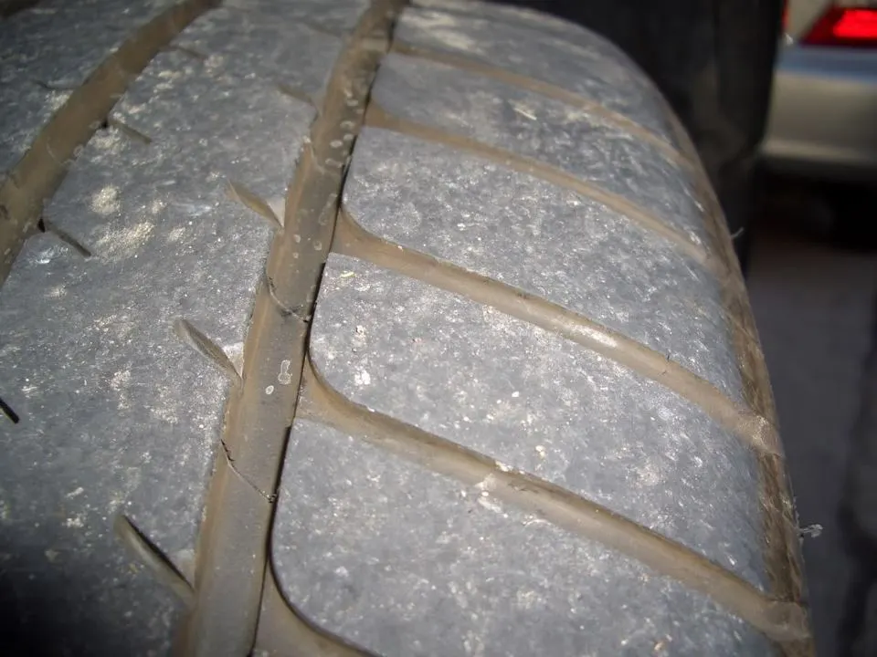

So here's some pics of the wheels. An ebay auction for a set of new tires is ending soon so i'd like to know everyones thoughts on wether the wheels tread and ware pattern looks ok...(need to know if i should go with just alignment or new wheels)
Driver Side
Passenger Side
Here's the pics of the new MONSTER TRUCK look, lol...
Black'02
Mar 5, 2006
100
17
Rochester, NY
Based on your penny test, the passenger side looks to have a shallower tread. (Its hard to tell though as the penny is facing different ways). They also appear to be slightly more worn along the outside edge, but its hard to tell with pictures. In general though, wider tires tend to follow imperfections in the road alot. I also believe that certain tread patterns tend to make the problem worse. What make/model of tire do you have? Maybe some other people reading this have the same tires and can share their experience with them.
