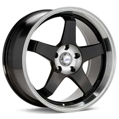

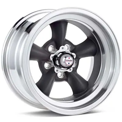

Example:
This is 45mm offset
This is a -2mm offset
As you can see one is on the outside of the rim and the other is all the way on the inside. Hope that helps! :nice:
