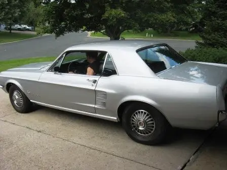

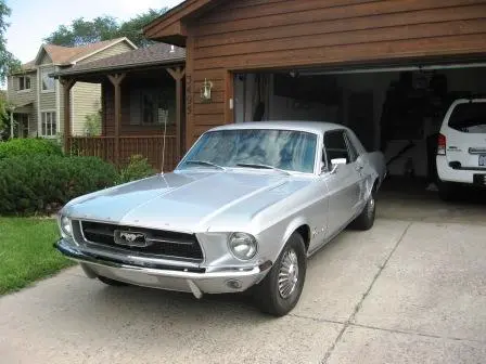

I'm a bit new to the classic Mustang world, although not to classic Fords. I currently own a 71 Bronco and a 75 Bronco and have restored ( restomod) a couple more. Anyway, my wife decided that she wanted an old Mustang, so I managed to find a 67 that had all the bodywork, paint and interior completed. The only issue is that is a 6 cyl car, which I really don't want. So.... time to do a v8 swap and also move to an auto. I've been doing some reseach and reading on exactly what parts I need for the swap (including the I6 to v8 sticky here). I need a little clarification on my parts list just to make sure I have it right. My list so far:
