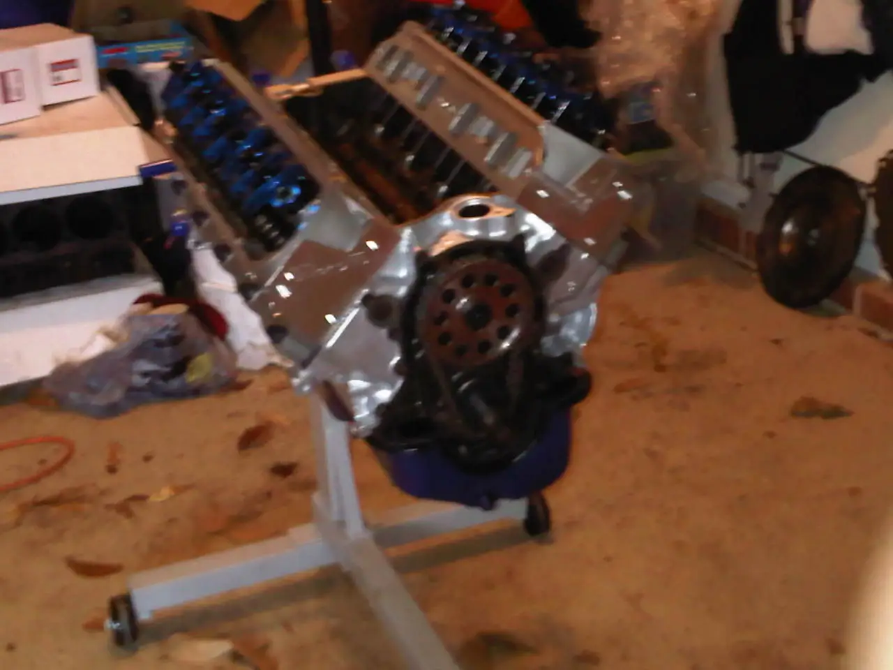

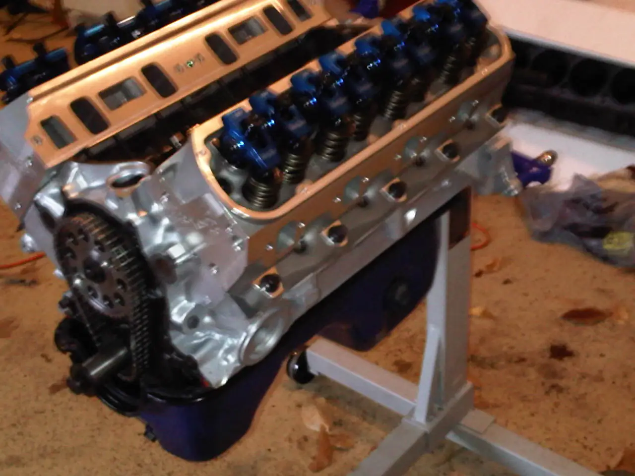

The short block from CREB arrived a few weeks ago. The build process has started. I got the new oiling system, cam, Timing set and heads on over the past couple of weeks. Really taking my time and triple checking everything to make sure I have it right. Good thing too, because I thought I had my timing marks lined up, but when I degreed the cam I found that I was off by one chain link. Hopefully, I will have it finished off this weekend and put it in the car the following weeknd. So far it has been fun....but a little more expensive than I had budgeted....little things add up quickly. Progress pictures attached. 302-1.webp
Are you running the cam timing straight up? It's hard to tell from the pics. Might want to consider advancing it, but I'm not sure what the rest of your setup will be. So far looking good, and yes it can get expensive very quickly. Take your time, do it right and you won't regret it. There's nothing like a shiny new motor :D
Yeah it is straight up. I want to be a little conservative with the set up because I ll be runnning a supercharger. Set up basically the trick flow stage one kit minus the upper and lower intake and a rebuilt but close to stock bottom end.
