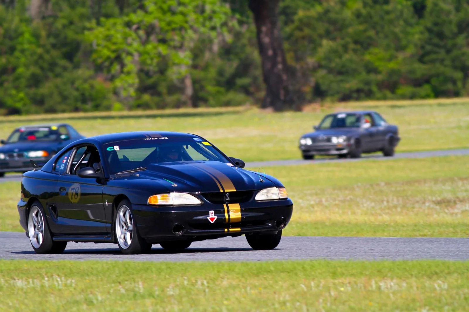

Just found this forum.I have a 95 Mustang Cobra track machine.Built 5.0 motor ,T5,full cage,coilovers,welded subframe connectors,etc.. Car is street legal.I had an issue at Road Atlanta this weekend.My oil pressure suddenly pegged the guage at 100 psi.I blew oil out of the filter area ...and all over the track!! I am thinking the pressure relief has stuck in the oil pump.Any opinions? After the first incident I cleaned it up and drove it.Pressure was normal for a bit ,then did it again.Not sure what oil pump is in there,oil pan is a Canton racing road race style.Any feedback welcomed.This car has been bulletproof thru 8 track weekends !
