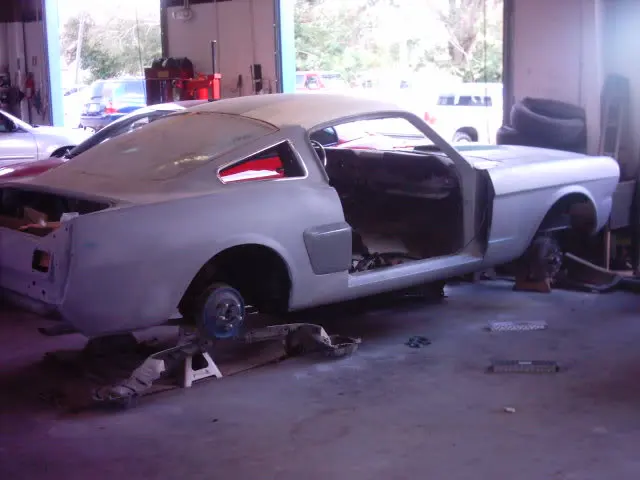

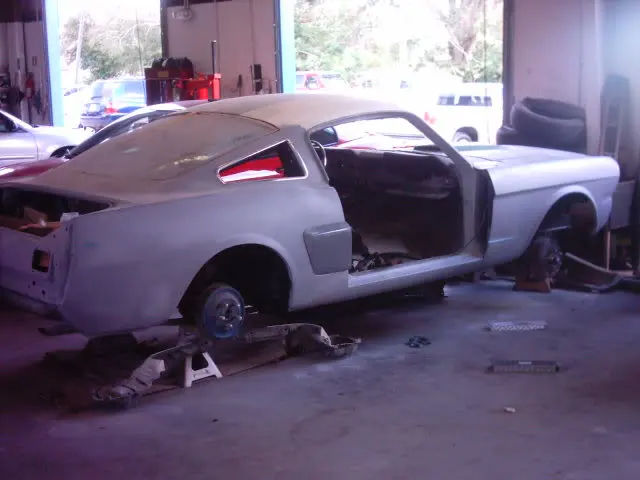

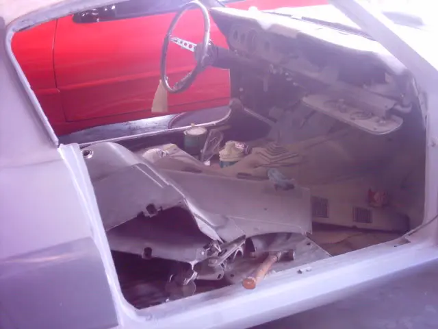

Hello everyone, I had a question, sorry i didnt search, didnt know what to type and Ill admit im too lazy. Im wondering what does it take to get newer wheels one a 66 mustang? Ive seen the new bullit wheels on a fastback before, i know there both 5 lug but im not sure if the sizes are the same. My dad is making a gt350r replica to look like the gt350sr, and im trying to convinse him to get fr500 wheels, but i need to know what do we need to do to make them fit. It almost in the paint shop (he painting it viper blue, with the wimbldon white stripes) I did a photoshop ill post it, but the answer to my question would be spectacular, thanks to anyone
the car

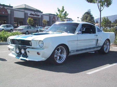

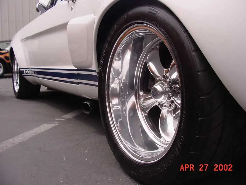

When I said you needed a set of adapters...I assumed the wheels were 18x8. If you want to run those in the rear, you may have to run a coil-over or 4 link setup and minitub the car.
You could run some mild fender flares and that could solve the problem. Look at this car...17x10s in the rear...

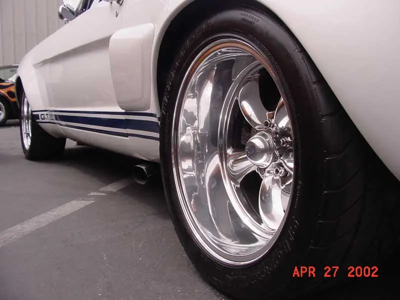

I host pictures for Mark....here's a few more of that clone with the 17x10s
http://www.dodgestang.com/toys.htm
Those aren't mild fender flares though ;)

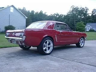

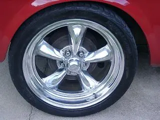

Hey my son and I put 18x9's (265 35 18) on the front and 18x10's (295 35 18) on the rear. We get a little rub in the rear every once in awhile. We used $7.00 adapters up front and out back. If you have an 8" from a 67 or 68 stang you want even need adapters.
Uhhh... no. Whatever traction you gain by the big rubber will be lost in the high roll center and seriously raked angle. In my book, it doesn't count if you cant keep it within the fenders (flared or stock).
This is the important angle ;)

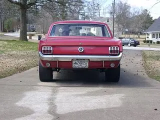

Have you moved the leaf springs in a little? The picture shows a 255 40 17 on a 17x8 rim. The widest I have personally seen on a 65-6 mustang is a 265 and the tolerances were so close that nothing larger would fit. That was with a 17 inch rim though, I find it hard to believe that the side wall squares up that much more on an 18 inch rim to fit a 295 in the rear without some form of modification.
66P51GT said:
...Whatever traction you gain by the big rubber will be lost in the high roll center and seriously raked angle...
Personally I think 18's are too big for the little 65 and 66 cars. I was just wondering if you have the math to back up that statement or if you are just talking out of your ***? If you do I would like to see it. Sorry I couldn't help but ask, I have been hanging out at cc.com too much lately.
The only modifications I made were some spacers to push them out enough so they would not hit the leaf springs, the tires are dead even with the edge of the quarters. Trust me those are 295 35 18's on the back, I paid for them. The wheels were given to us, and the only thing that matters is we like what we see and have, and have had nothing but positive comments at all the car shows. Open the attached picture and you can see the how the tires fit.
