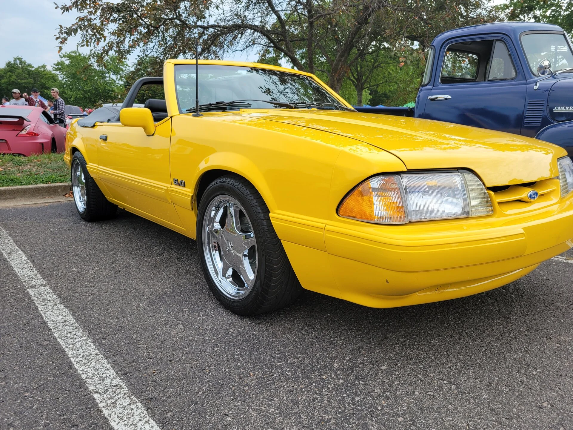

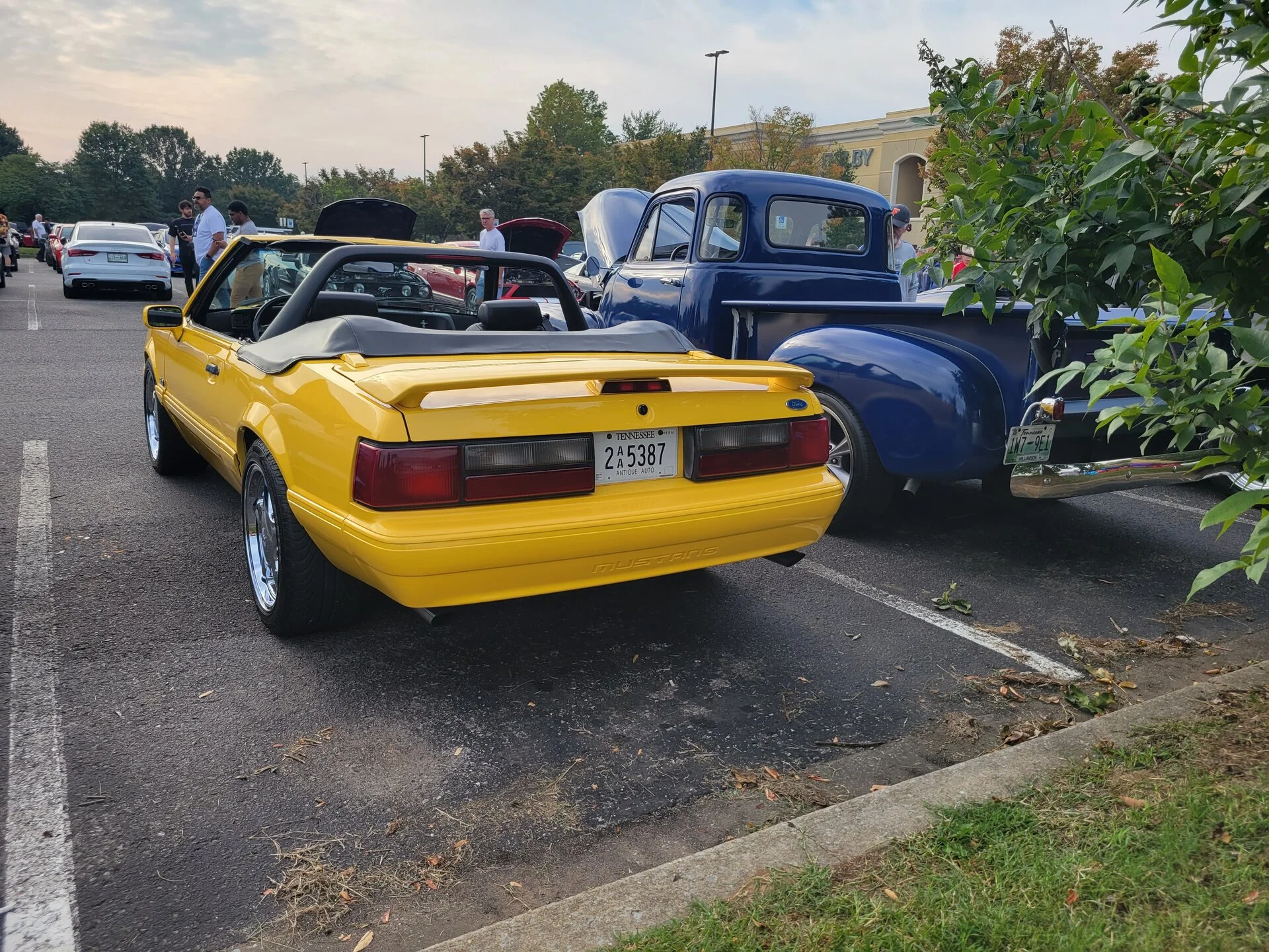

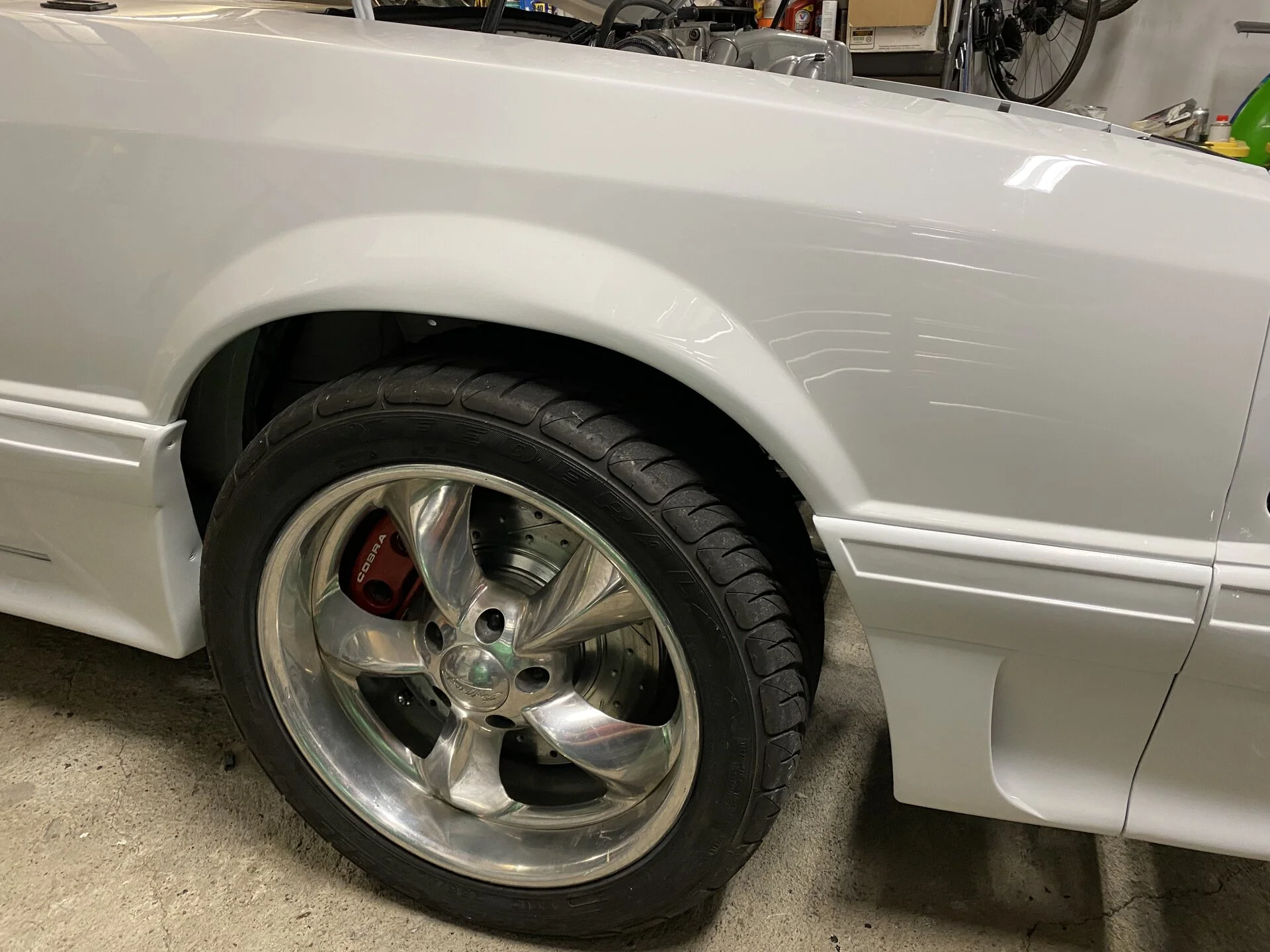

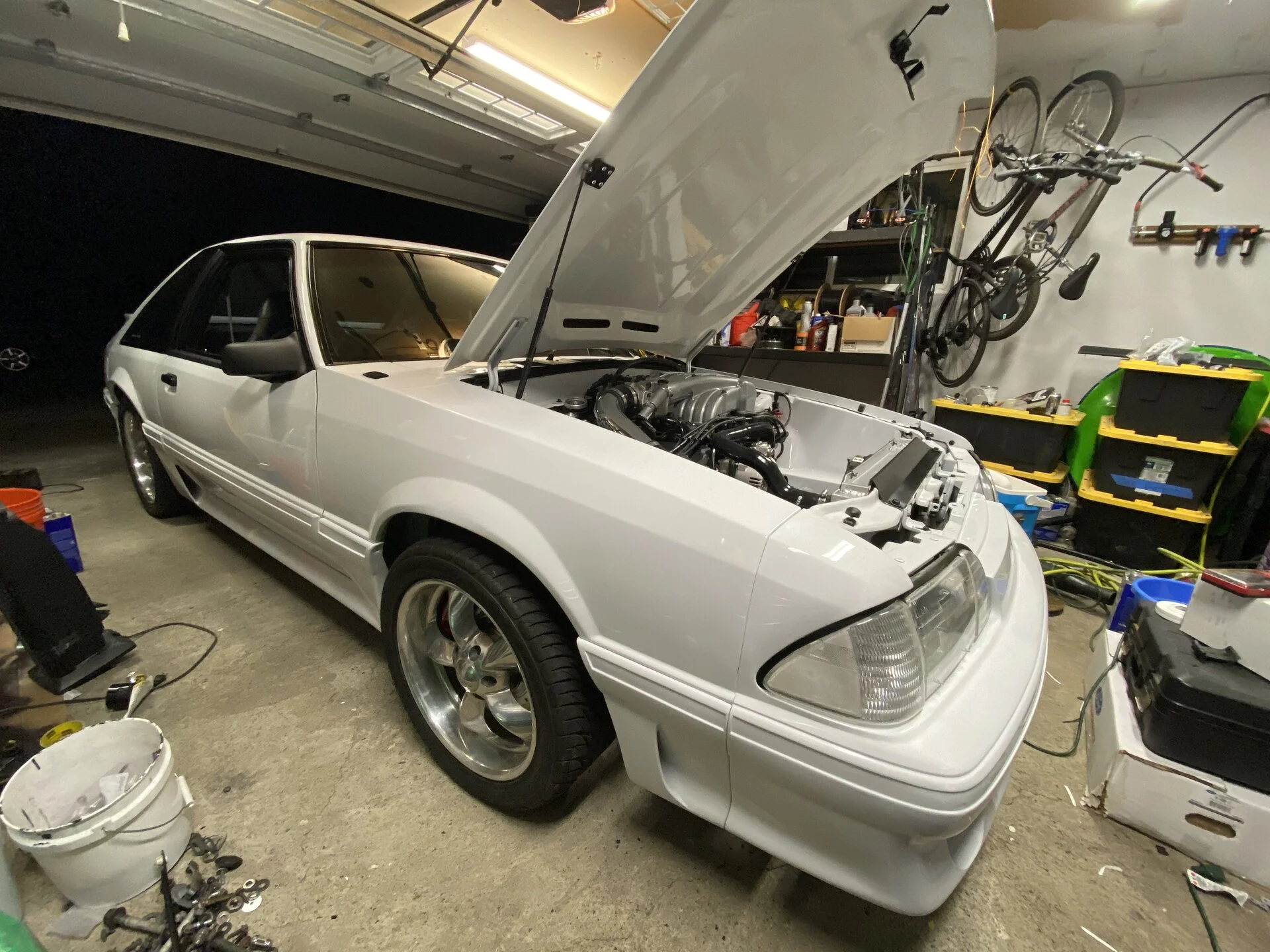

I have 255/35/18s on 18x9 Saleen Reps, 24mm offset, 96+ spindles, front coilovers, fox control arms moved inboard 3/4". I put in 5/16 spacers so rim would clear coil spring, may not need it with conventional springs. No rubbing.

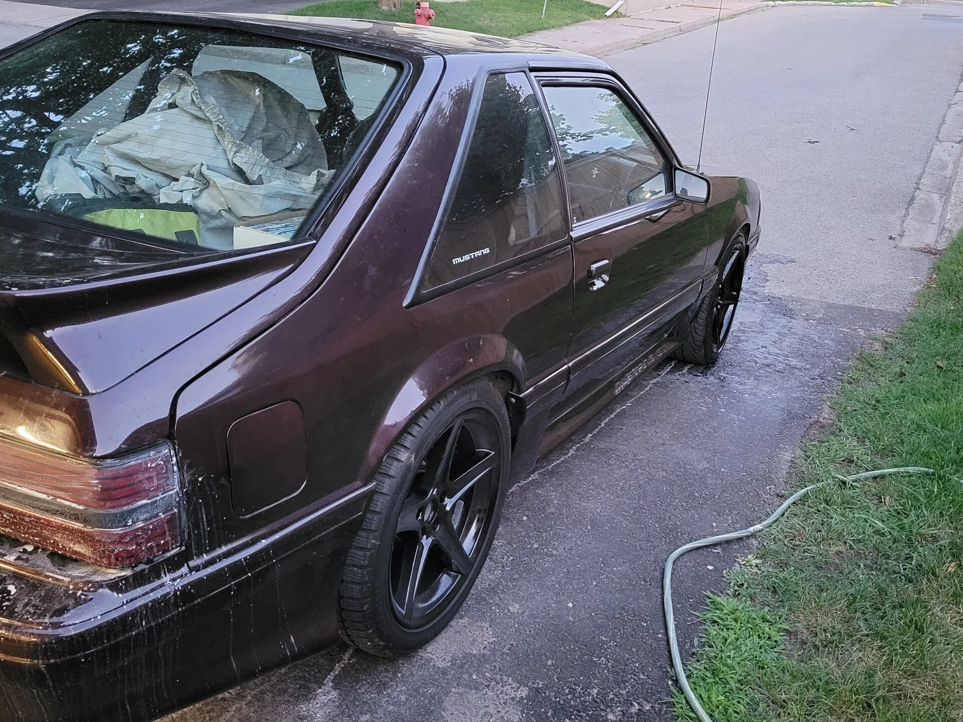

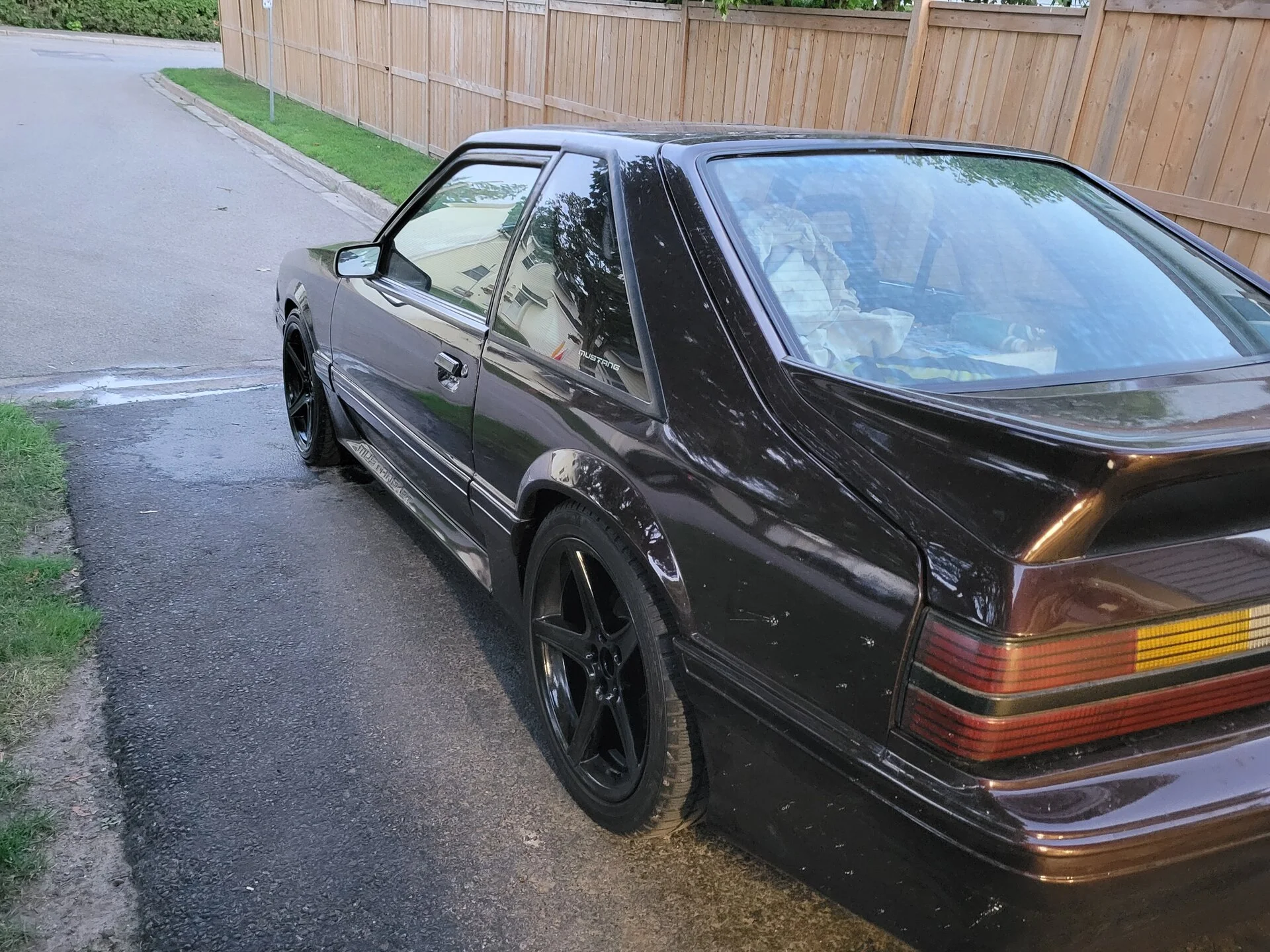

I run 18's on two of my foxes. The green car has 275/35/18 rear and 245/40/18 front. The black car has 265/40/18 rear and 235/40/18 front. Neither rub. No rolled fenders, both cars lowered on eibach springs. 94/95 front spindles, rear fox length 5 lug axles.
Wow! That looks really good, nice work! What size wheels? Any spacers for the front and rear? If so what size?
