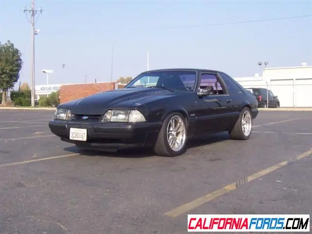

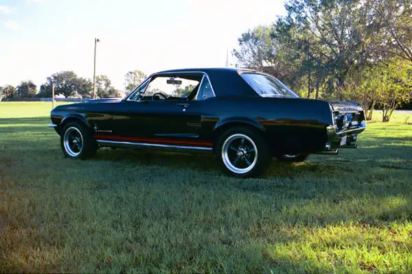

I had 18x9 upfront and 18x10 rear boyd codingtons on my fastback and they tucked very nicely. 305x30 rear and 275x35 front. The wheels are long gone from the fastback. Now they are on a certain lx
Any of the older members recognize the car? It's my old 92' lx with all black interior and 80K original miles....and the hood yup it's from my old supercharged HCI motored 89 GT :nice:

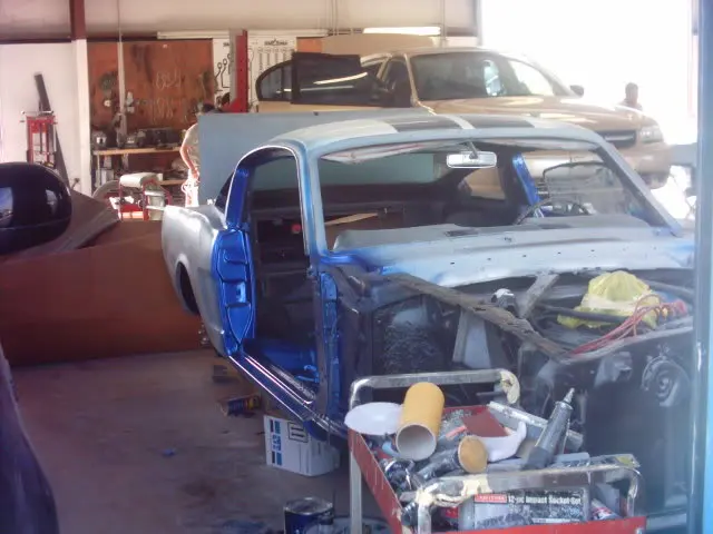

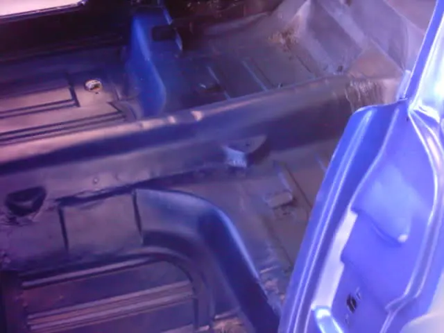

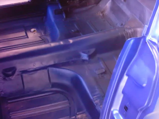

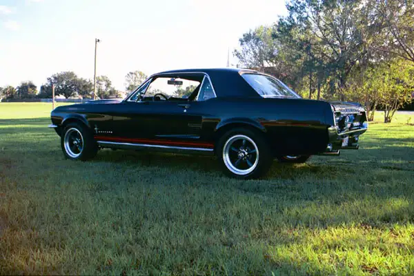

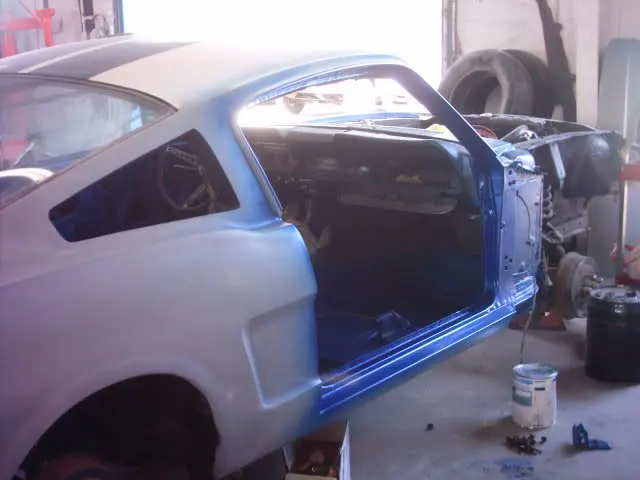

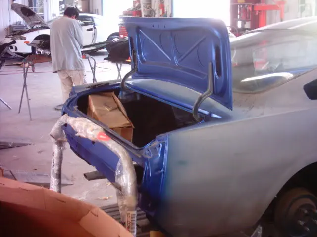

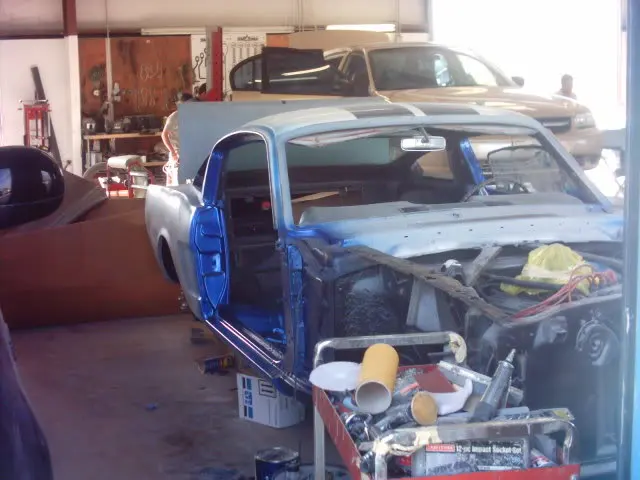

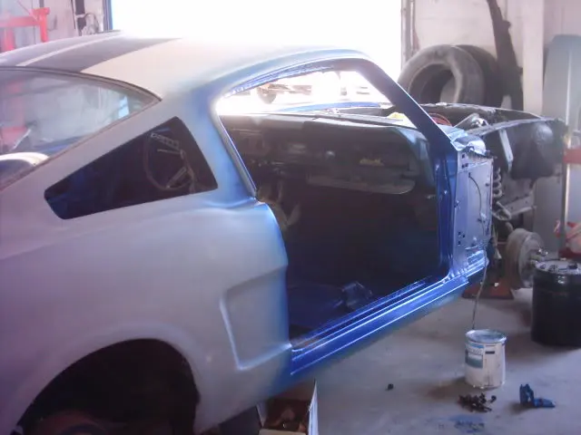

Well i dont really think it matters, i think my dad just decided to go with the normal torq thrust and have them painted by some guy here who does them very ncie ill post a pic of his other car with them painted, and ill post some pics of the progress so far for anyone who cares....
new floorpans
heres the painted rims

k thanks for that info, BEAUTIFUL CAR!!, i love the bullits, i think my dad is just going to go with the torq thrusts and not worry about anything else, thanks guys
