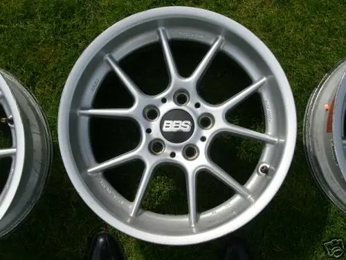

yea those are BBS

Its so hard to tell with chrome in the pics I've seen. Either the pic has too much or too little light to really tell what it looks like. I do like those BBS rims though. One reason I've thought about rims is I'm going to need some new tires in the next 6 months or so...and I figured I'd get the new rims/tires....and put all weather on the stockers for winter. Maybe I'll do the suspension this summer, get the new tires when I need them and hopefully it'll be in time for winter so I'll just get all weather. Then next spring, the all weather come off, and new rims/tires go on! I've seen the 18"s can get costly for tires, but I really like the looks of the 18 Saleens or 18 FR500's over 17's.
Soooo....since I can't seem to get over the handling of the 17 year old Porsche I drove for 6 months....maybe I will do the handling first.
