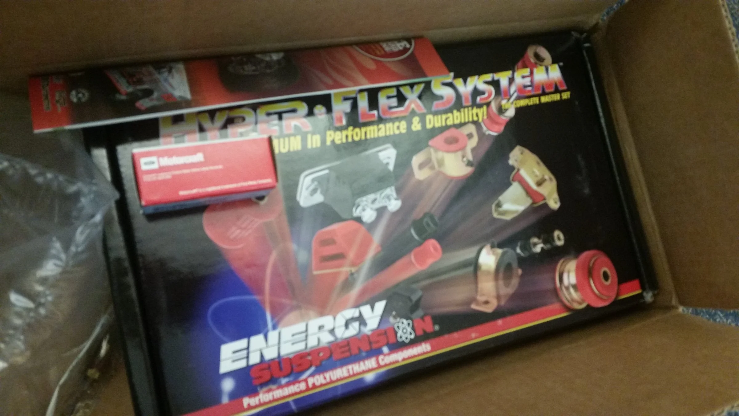

Tonight I finished installing the headers, and power washed the transmission cross member. I was also able to order my energy suspension engine and transmission mounts. That means I am ready for big things... If only I had an engine hoist.

Right when I thought my work day sucked, the UPS man showed up at my office. My mounts and a couple sensors are here. I think I am going to have suck it up and buy an engine hoist. I dont have much time before the IA winter starts.

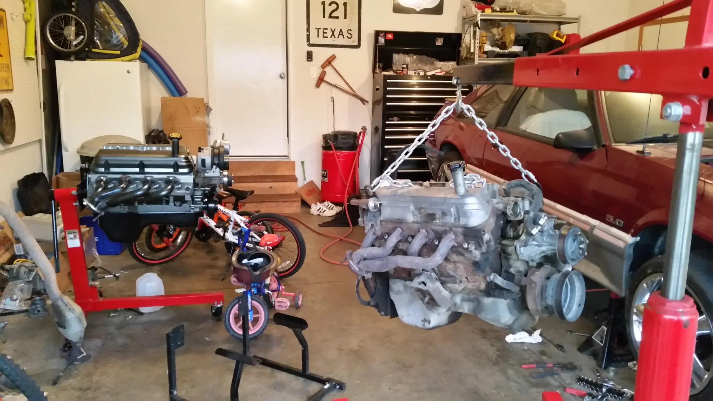

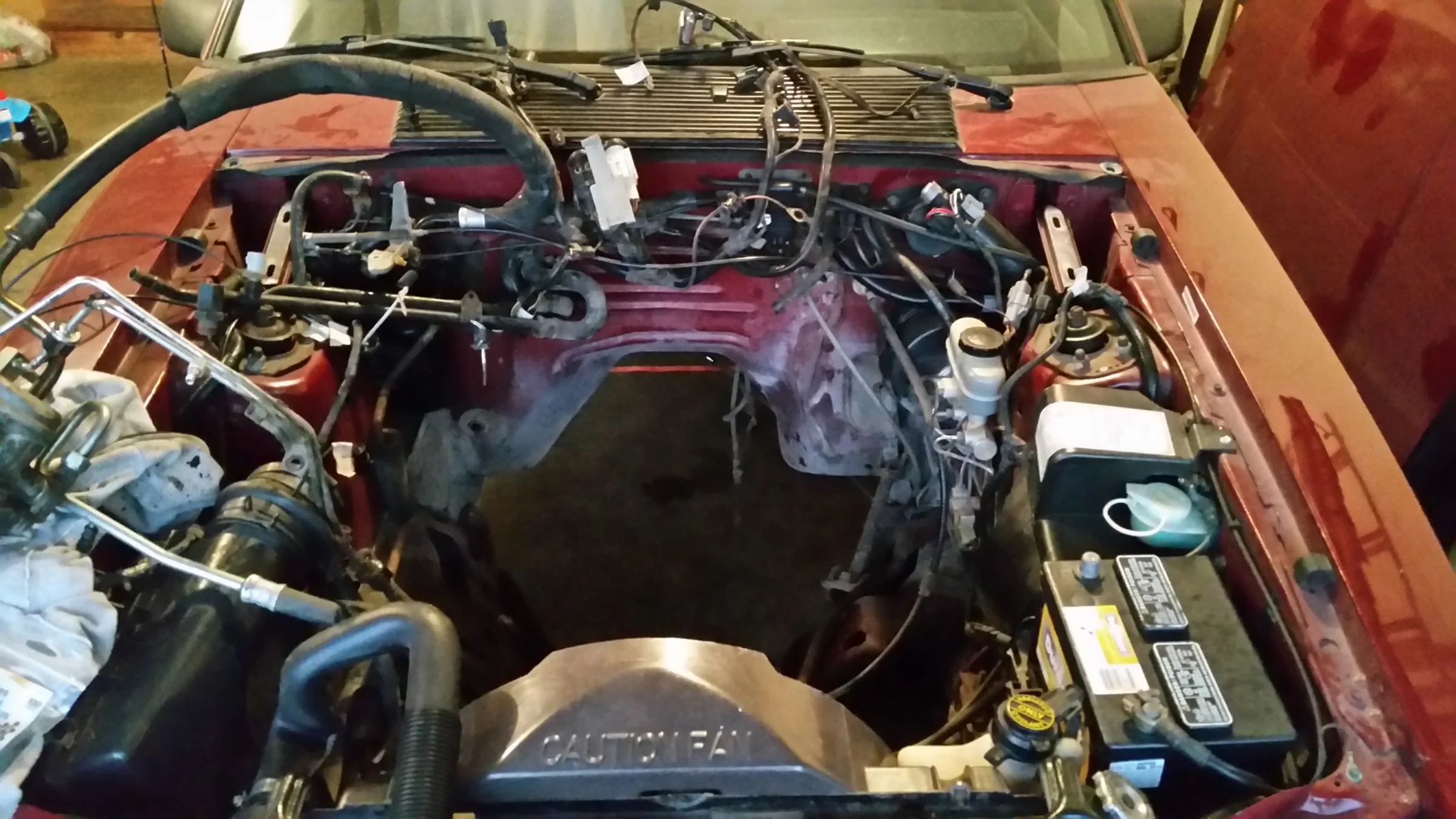

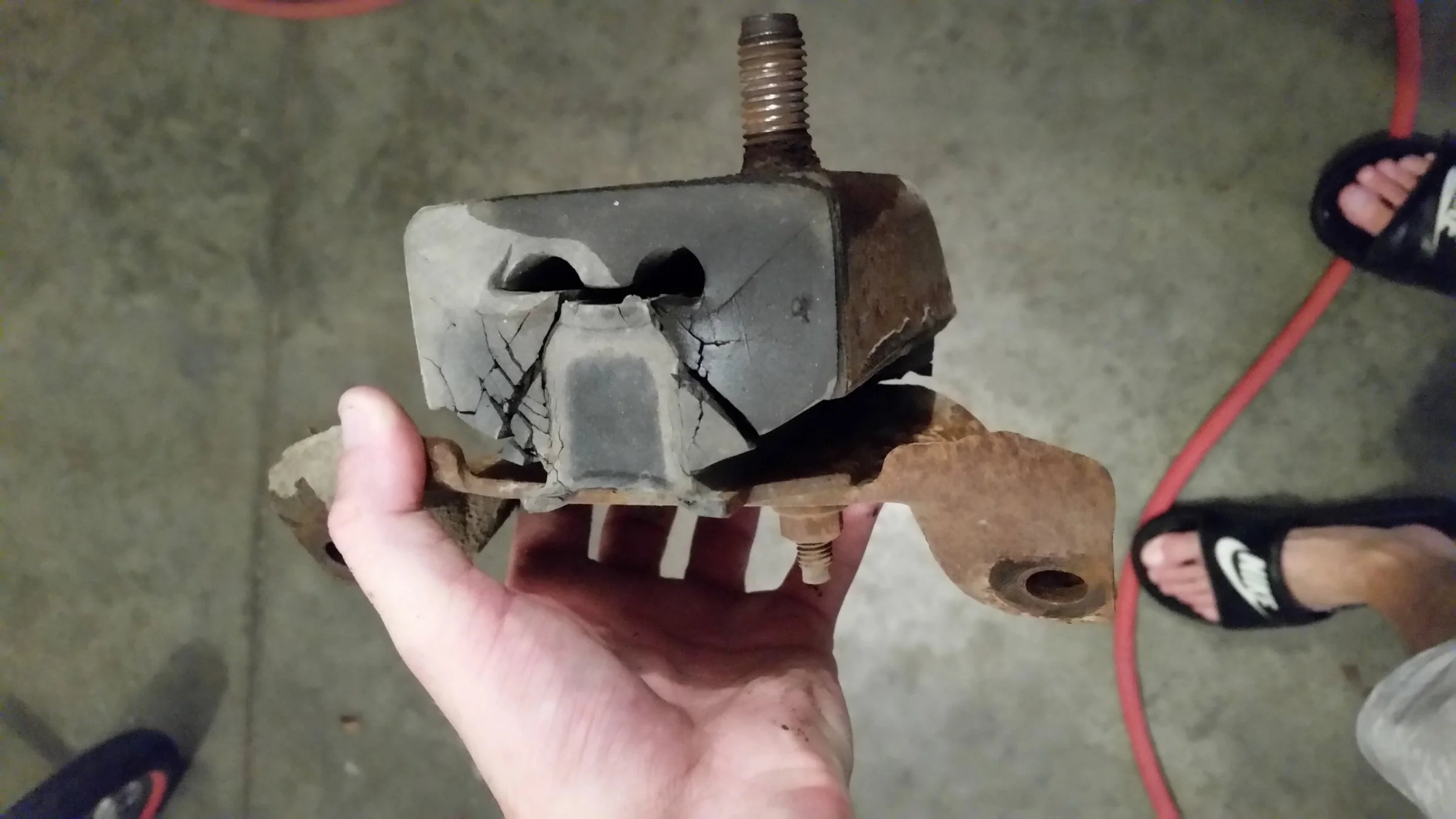

Tonight was a good night. I was able to pull the old dying heart out. Afterward I removed the old motor mounts, because Energy Suspension does not include new hardware with their mounts.
Pic of one of the old stock mounts...
Yes, I am basically working in a circus of bikes, general garage sht, assorted kids toys, and car parts. But work is getting done.
We are leaving town tomorrow right when I get home from work, and Sunday is my wife's Bday. So this is where I sit until next week. Ready to go back on the ground and rolled outside for powerwashing all the gunk off the K member, frame rails, AC compressor, etc.
